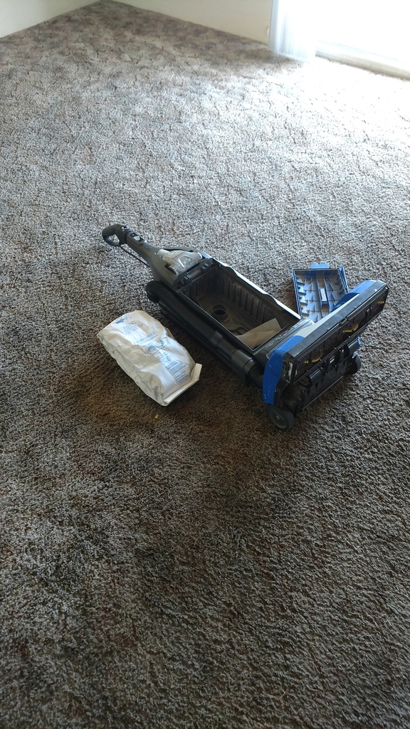

Two bedroom unit I put a brand new bag in my vac and filled it up

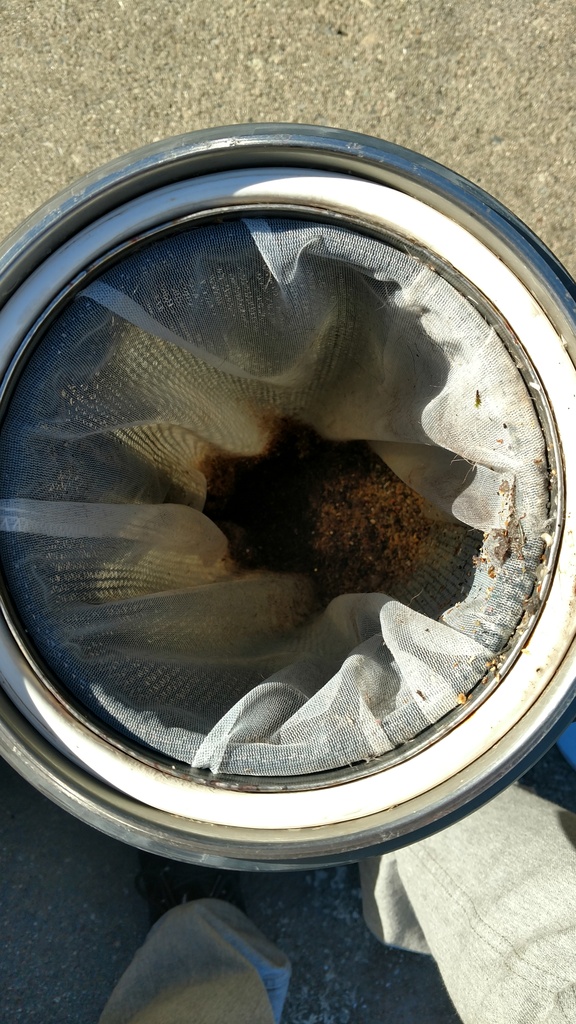

Next I presprayed all the carpet and then took my gutted vac that I scrub with and hooked my vac hose to it. Put a brand new white liner in my Dev filter to see what I would get
This is what made it to the filter Notice it is not super wet or super Dry it is just a little wet from scrubbing in my pre spray and this is what came out during that process, the good thing is not one hairsand ball was left behind.

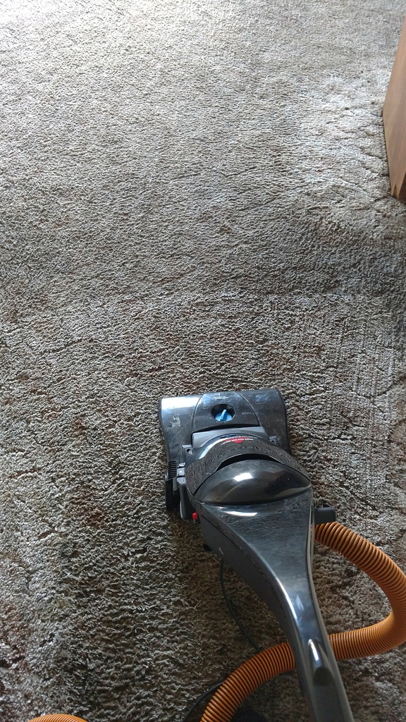

Here is a picture of how much it changes the carpet before I even start to wand out

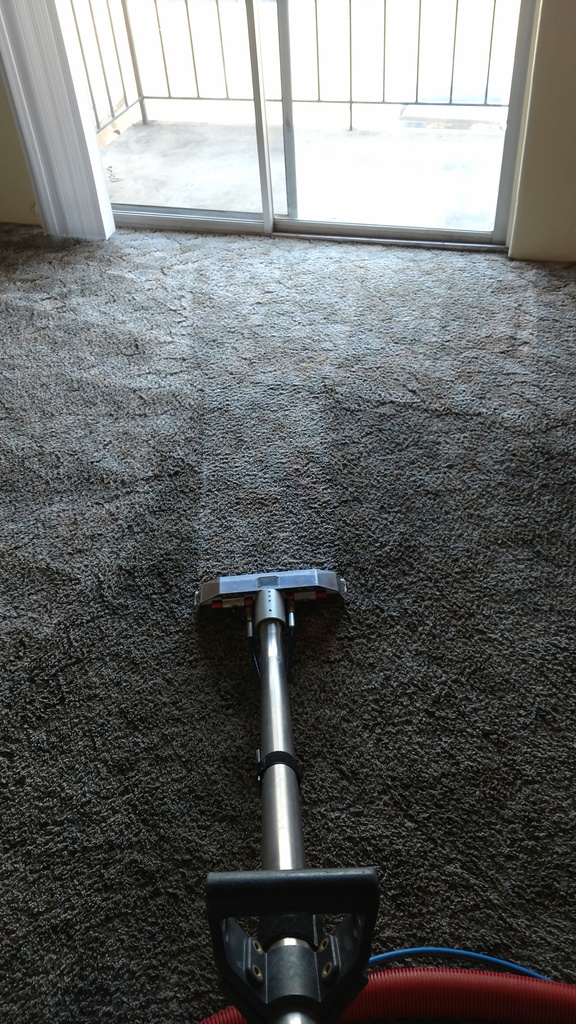

A quick pass with the wand WITH my hole glide

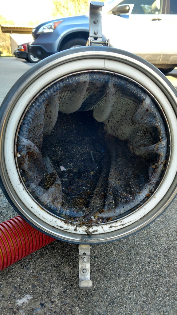

This is a picture of my filter after all is cleaned. This was ALL picked up AFTER a very good prevac I did NOT cut corners. I also want to say this is with our own fabricated HOLE glide. I know it is hard to tell but there was a lot of crap in there after I filled up a vacuum bag full of crap....this was only a two bedroom UPSTAIRS unit
