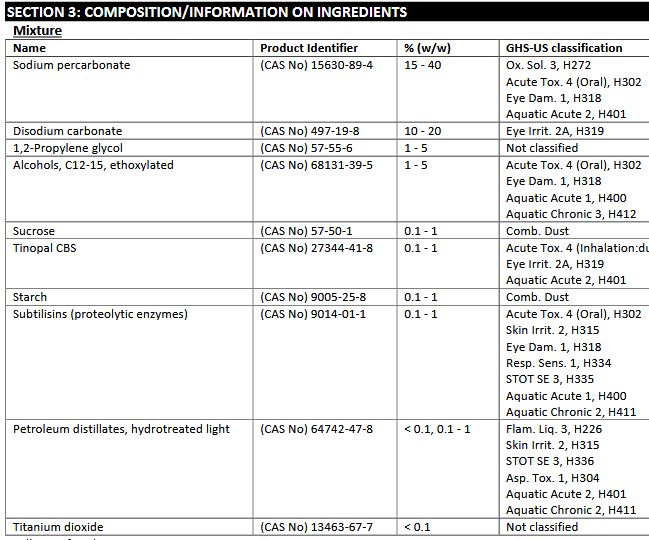

Mikey;
This is why "laundry products" invalidate carpet manufacturers warranties,
as most carpet inspectors are quick to point out. First listed Oxiclean Stain Remover msds :
1. Maximum 40% percarbonate
2. Tinopol CBS - optical brightener
3. titanium dioxide - white pigment
4. Sodium Carbonate - leaves grey residue (AATCC testing)
5. Only 60% active ingredients, so 40% more residue on fibers

Mikey;
Show us yours Larry.

To be honest, Oxiclean gives better results, but I'm assuming that's due to some of the unsavory "bonus" ingredients.
