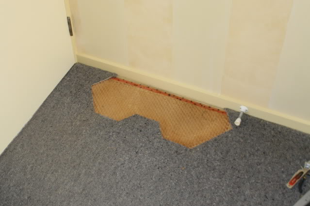

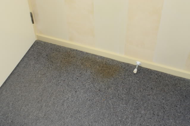

Aged cat urine in a wool carpet in a rental. Another cleaner already had a go... asked me to look at it as well. I said no but I'll do a repair if you like.
This was in an entrance way and the door showing above was to the hallway. Even in an open position, the staining showed... and smelled!! I replaced the smoothedge and underlay as well.
Before.

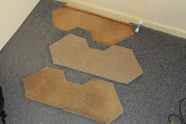

Cut out. Cam shift style carpet. Straight lines will show if you cut tufts.
Old and new piece.

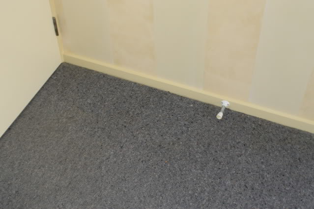

After.
Straight down.
Total repair time including packing up 45 minutes. Doing the cuts I did, barely took any more time than if I'd grabbed a straight edge and hacked it out. Because once it was cut, it sat straight in there without any messing around trying to tidy things up.

John, Did you just use a sharp knife and straight edge to cut the piece out? What your trick to getting such clean edges when cutting from the top?

I use an awl to open the rows first adn foremost. In fact, I usually quickly 'chalk out' my repair, then open the rows for basically the whole repair then I usually grab this baby and cut away.
For the ends/edges close to walls etc, grab a paint scraper/putty blade type tool about 3" wide and use that as a mini straight edge and then use a really sharp utility knife CAREFULLY. Or simply pull out the duck bills and snip away.
Always work to the side you want so ou don't end up with wide butt edges underneath that will hold it open.
You can trim carefully later, but it's better to cut it right the first time.
I cut that whole new piece out free hand and only had to adjust 1 side. I needed to take an additional row off a short section.
At the end of the day, it's just practice!! and lots of it.
