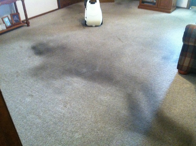

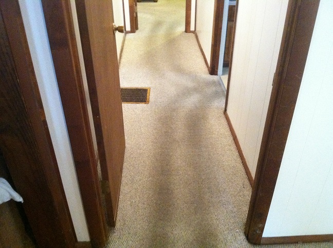

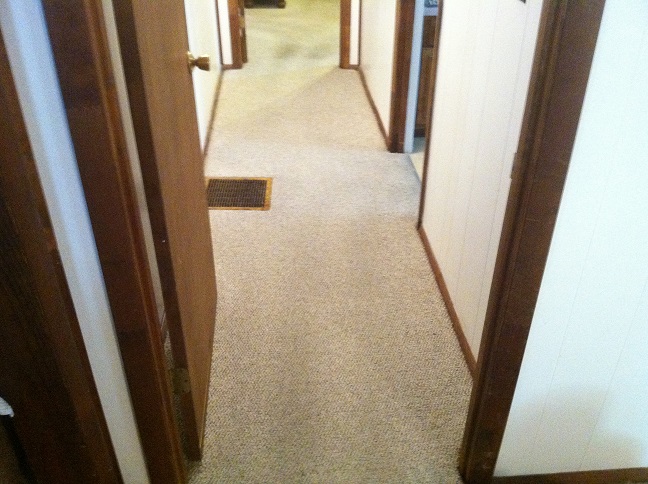

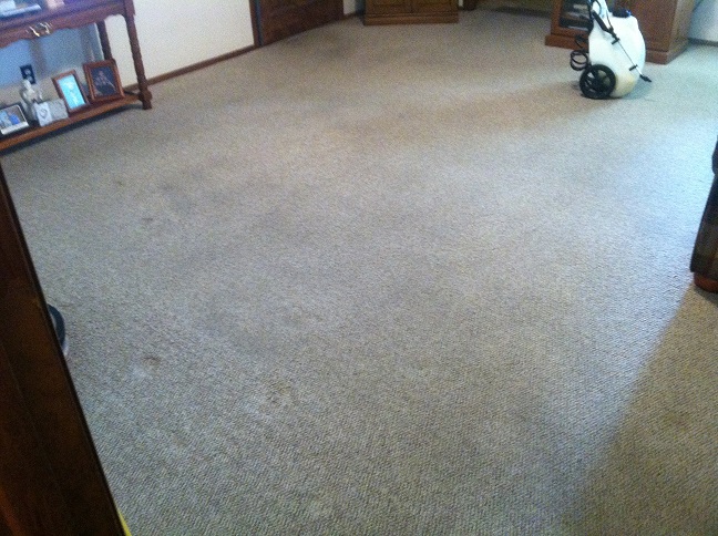

I've cleaned this carpet several times using hwe and vlm, orbitec op, trinity op, crb, truckmount with a pre scrub, but nothing made as big as difference as the 300rpm rotary and a burnishing pad.
The pictures shown are before pad eXtrAction , just vac, pre treat and scrub with a rotary at 300 rpm's and a burnishing pad.
