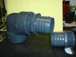

Dale, I probably have the grey spears fittings you seek here, we've bushed a few to 2.5" insert (barb), common on Butlers.

I found a fitting, called a Zip Coupling, that 3" ABS or PVC fitting will screw into and 2.5" cool cuff with the staight pipe on it will fit right into it on the other side. A nice tight fit. Its normally an adaptor to fit 3" pipe to 2" copper pipe. Apparently the 2" copper has a 2.5" outside diameter.

Dale, I just went in to a local plumbing supply store (i bug them all the time when I'm making something. I am amazed at what I can find in that little store!) and took in the cool cuff adaptor fitting. I asked if they had anything that would join it to 3" abs pipe. What he showed me he called a Zip Coupling, its a rubber fitting with hose clamps, female thread on both ends. 3" abs or pvc will thread in one side and the cool cuff fitting just slid into the other.

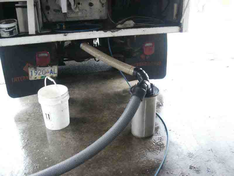

I have a filter pail that cost $200 to make that I've been using for 3 yrs now. The filter itself is 100mesh SS. Plumbed it with 3" abs fittings. I have a 3" hose so I don't need the reducer to 2.5" (yet) but since the 2.5" is on my Christmas wish list ...

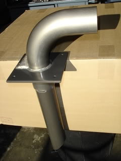

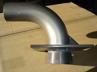

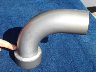

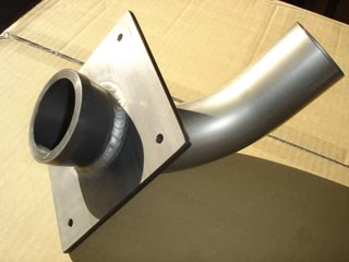

The plastic fittings are plan B, if I need to use a 2.5 "barb" of some type, I'm gonna use this for maximum airflow:
When you compare it to the conventional Butler approach it's obvious which one flows better and has a larger inside diameter.
We also make a few custom versions:
