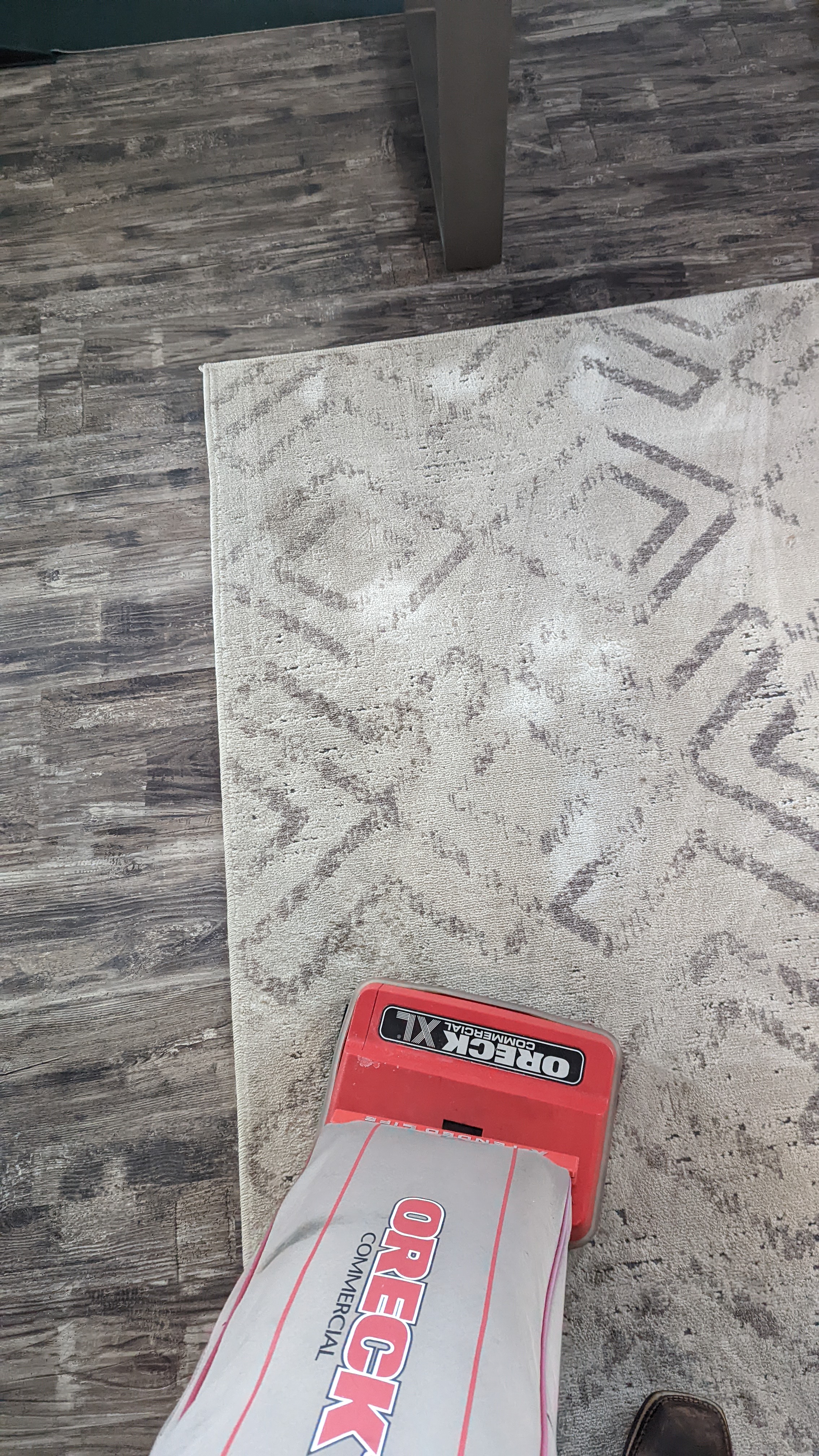

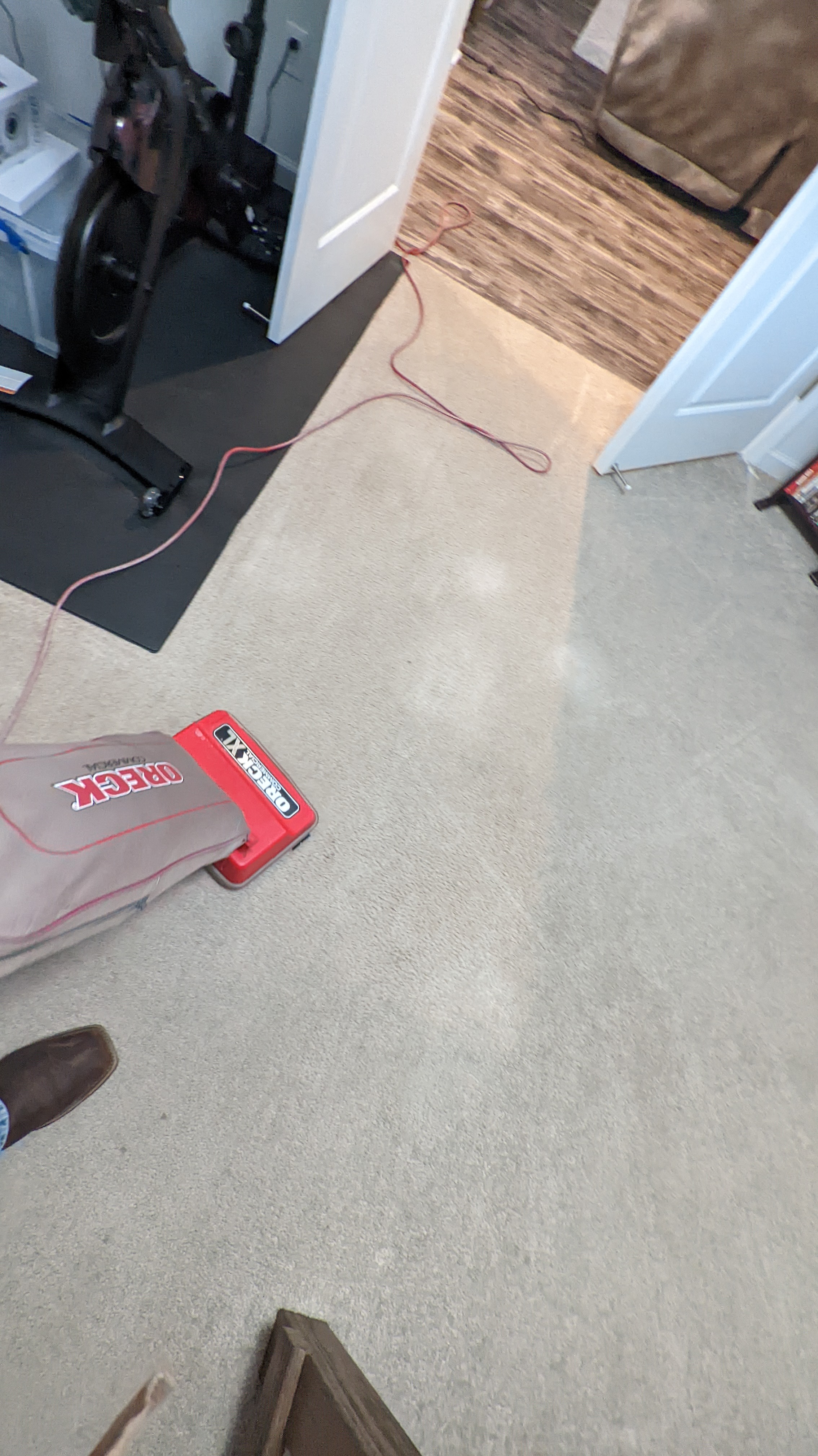

Source of white spots?

It could be so many things, acne medication, foot medication anything with benzoyl peroxide in it.
Could be the cleaner they used had peroxide in it. Oxiclean or any boosted with peroxide will over lighten the area.

Crappy over the counter spotters, such as Spot Shot, etc…
The client buys it in hopes to keep their flooring clean, but in reality, all it does is cause damage.
Because NOBODY ever reads the label, or ‘tests in an inconspicuous area’….
And they never extract it…
So, the cleaning agent lies in wait for us to come along, clean the carpet, then blames us for the bleached out areas, or thinks that’s what all the carpet should look like…
