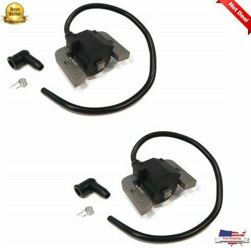

I believe in the 27hp command the spark plug wires are molded into the coil so you would need to remove the front cover and replace each coil.
You will need a little bit of mechanical ability to get the coils mounted and gaped correctly.
as Kev mentioned, plug wire is integral to coil

Start the thing up ramp if up as much as possible.. When it starts to stutter... shut it down pull the plugs and see if the plugs are wet if the plugs are wet then that means it's not firing if it's not firing you probably lost the coil which is attached to the spark plug wires Once you pull one of these off whenever you put it back on take 2 business cards and make sure you put them between the coil and the stator so that it has the proper alignment 2 business card thicknesses is about where it needs to be

May be a cracked coil. I had the same problem a few years ago. Went from intermittent to just running on one cylinder. Replaced both coils and it was fine

The hardest part is taking the engine cover off. Take a pic of each coil magnito orientation before you remove.
Test the 2 cards thickness under the coil before removing. Each plug is built into the coil magnito.
There is magnets on the flywheel. As it spins past each coil magnito it creates the energy to fire the spark plug.
You must put them the right distance from the flywheel like Jim mentioned.
Any decent mower shop should have them in stock. Have your model number and Alex number available when you call parts shop.
Do them one at a time. That way you have one to look at and compare.

Changed out the coils....running smoothly!
A shout out to all of you and your diagnosis.
