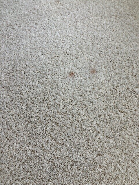

Try a little volatile solvent. May be an oil from the plant.todays job had some spots that didnt come out. I tried everything. Customer said it was from an aloe plant. Suggestions?View attachment 131768

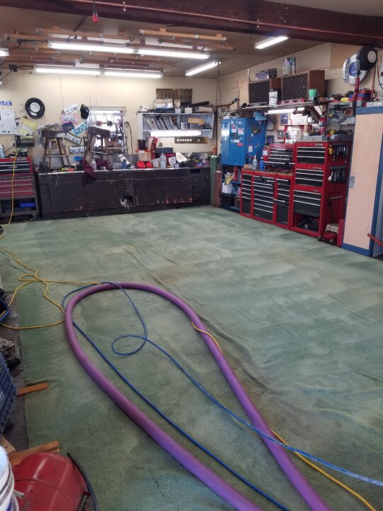

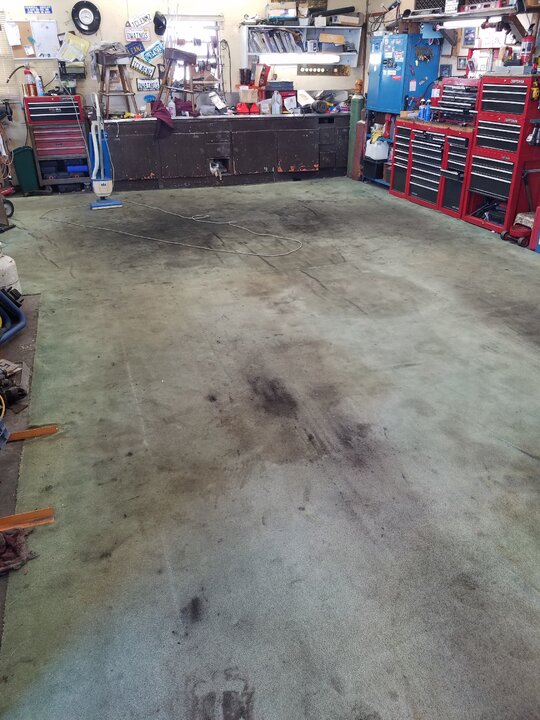

It’s time DwainWhat ive found to be a great spotter for small grease/ oil stains is a quick shot of brake parts clean quickly followed by hwe i keep a can on my van all the time. Picked up that trick keeping my repair bays carpet clean if at first it didn't come up with the prespray and rotary a squirt and another pass and it's always gone

Just be sure when using brake parts cleaner( aerosol lacquer thinner is what it really is) that you dont over saturate and you immediately rinse it out so as not do damage to the carpet structure or any glue down backing . Where i live theres still alot of homes heated by wood this has been extremely effective for dissolving and removing pine & fir sap chunks/ spots from carpets and area rugs around fireplaces / woodstoves and wood boxesthanks for the suggestions. Will buy both as what I have on the truck did not work.
