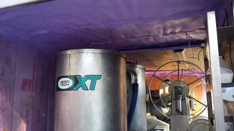

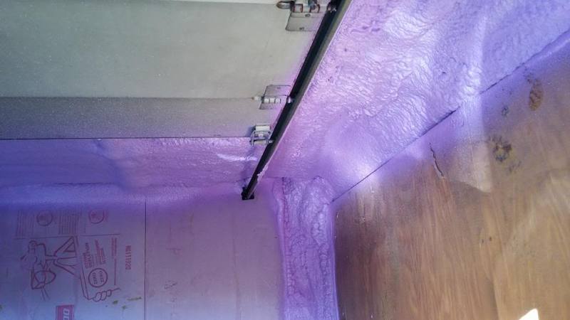

just got it back from being spray foamed :D
r7 per inch. Tech said its between 2.5- 3" overall
Considering there was allot of equipment in the way they did a pretty good job
Truck definitely isnt fully insulated where I want it yet but getting closer
I'm not thrilled with the look, wish it were smoother but that R-value has to help and it's the best way to insulate tough areas. It should even help with deadening sound too. :icon_cool:

If they are able to do a box with nothing inside it looks allot smoother. The product is heated and sprays out around 1300 psi from 12 to 18" away.
So for a tight area it turned out well.
It's either yellow, white or purple. The underside of the truck was done in yellow and I don't for it.
I'll probably be sanding a few areas down, like about the recovery tanks.
Just under $4/sq. A comparable sheet of 3" r18 is $80 (4x 8 )....but the time plus you simply won't get the same results.
Sent from my SM-N900W8 using Tapatalk now Free
I agree it would be difficult to do once the unit is in and the truck is setup. It will serve its purpose and it's just insulation so it really should matter what it looks like.

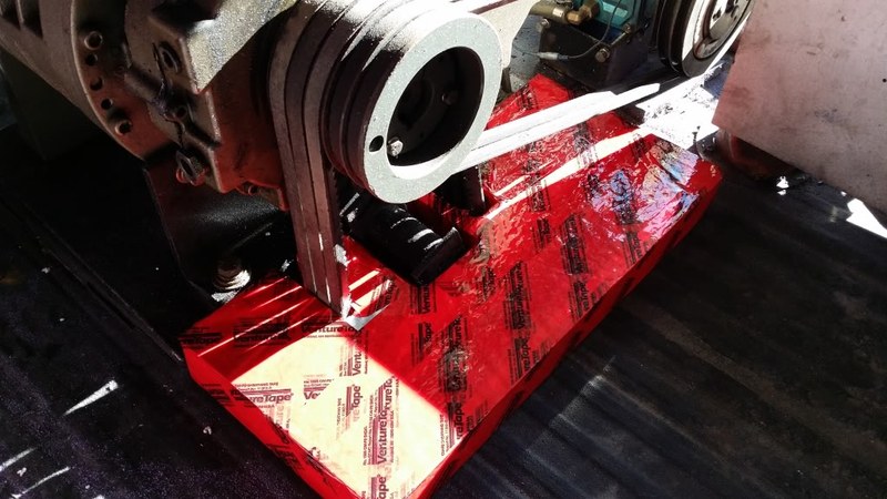

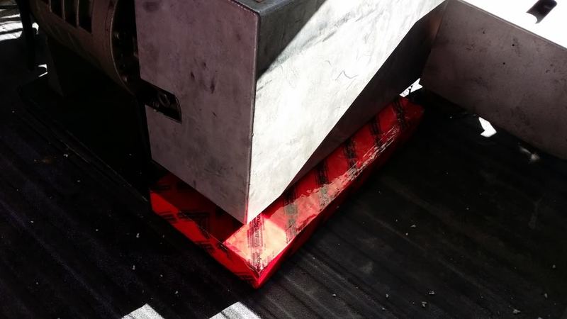

Couple areas need more insulation but getting there. I made a r12 piece to slide into where the pto belts come through the floor (for when not in use of course)

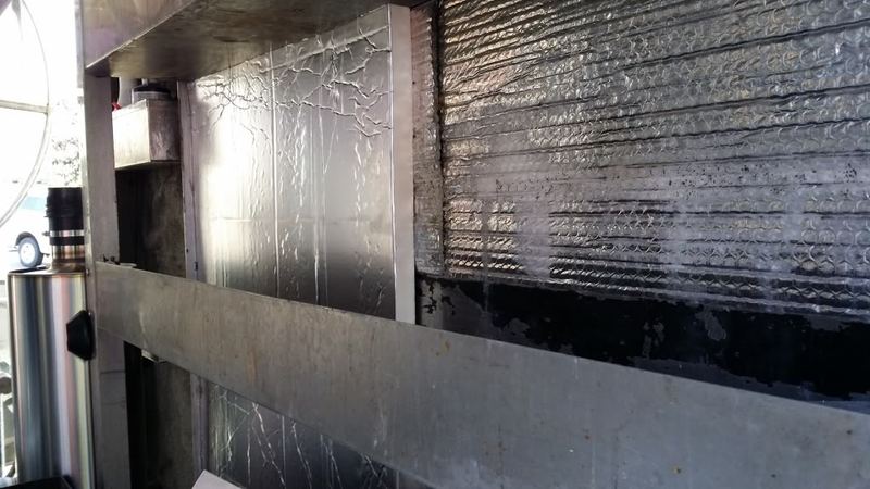

Also put reflective r7 behind my chem rack
Fort Worth , Texas
You need to make yourself a warning hangar for reminder purposes to hang on you pto switch every time you use that insulating board for the belts.
Just a little bit of a reminder on a day you might be in a hurry will save you a mess on the inside of the truck.
Very good idea on the insulating block for the belts for sure.

Thank you. It slides snugly under the cover as well
I was thinking about that as well... don't want to think what would happen lol

Two soft bristle push brooms mounted under that open area, interlocking with each other, allowing the belts to slide between them, keeping the chill out.
This will also cut down on belt dust.
Will be doing this with my V, will post pictures :)
