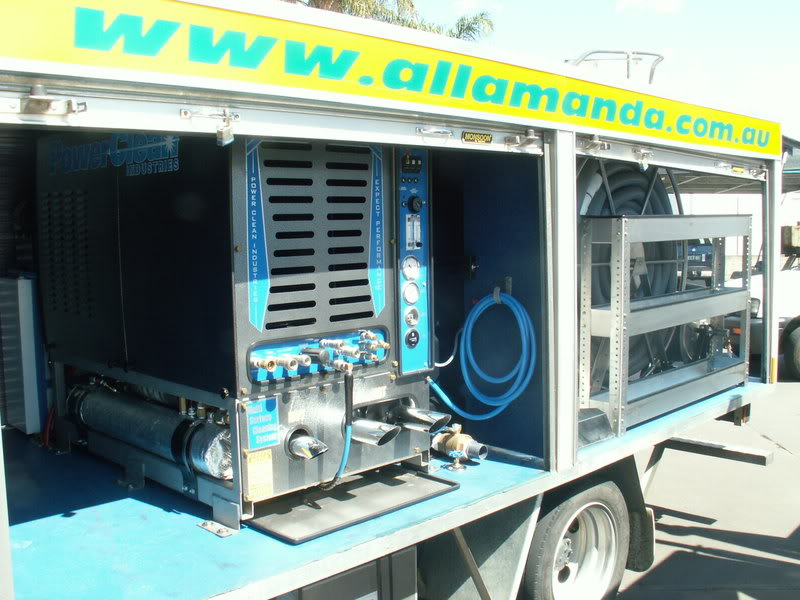

We had a few customers the used Rhino lining due to their location and after a month, it was peeling off. This rig below was sprayed a month prior to us getting out hands on the truck to do the install. He was only carrying around airmovers and dehums in this truck before he had the Genesis installed, and it was already coming off in sheets!
It seems to be that Rhino really needs to applied by someone that knows what they are doing. Line-X however is more idiot proof due to the pressure and heat that it is sprayed on at.

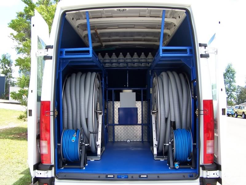

This is Line-X that I have computer color coded to match the exact color of the van. We have it sprayed 8 inches up the walls and cover the wheel arches as well so if you want to hose it out, you can, without any fear of water penetrating anywhere and rusting underneath. This looks very neat and professional!
