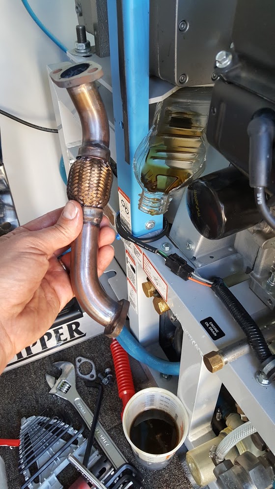

I use to have to vacuum out the oil from my Vortex when a drain bolt stripped out.
TOTAL PITA!
You never get it all out and it takes forever..
I was told I'd have to do the same with the GD on the 370..
The stubbornness in me found a way to drain.
Remove the header that goes from the motor to the thermal well and you'll now have access to the drain plug AND be able to McGiver up a funnel from a half bottle to drain
pdZMrHWal5qUs_58Nxf9tMCoAFRlQbSh-gV0j42MIo6h1wCf0HcOMj-bfPjflIU05iOc_bVuEENR9uRR-Z1=w560-h995-no.jpg
Put a nut on it not the valve.
I looked over the 370 at Interlink Friday. That small foot print is unreal. :cool:
If you extend the drain port with a hose make sure you put a nut on it, like a lawnmower would have. Not a petcock valve that could be jarred or bumped and you lose oil.
