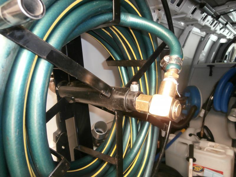

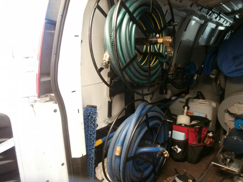

I have the same APO...its not that hard...I have mine hooked into a live reel...
bottom reel is the APO..top reel is my fresh water..both are live reels...

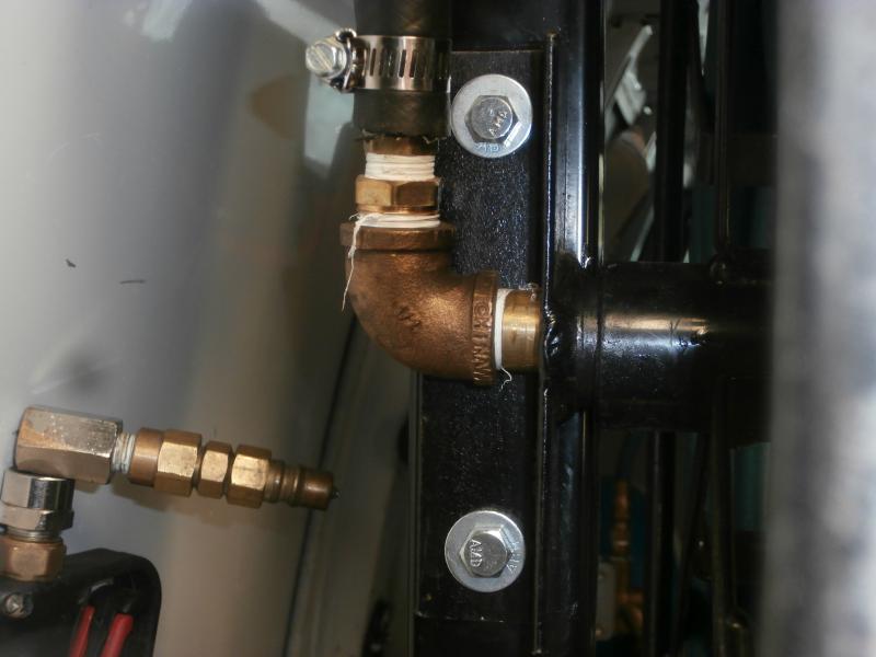

this is the swivel that I use..best price on swivels and out last all of them....
you can PM me your number and I can walk you throughout is simple enough...

APO gets used every job...I don't want to carry
carry around the extra weight of smelly water all day..
The swivels I get at windtrax..about 30 bucks and the rebuild kits are about 5 bucks....
I use them on my live APO..fresh water..and high pressure hose and I have only rebuilt 3 in probably over 6 years...
i can figure out how to do the live reels, great idea. i have the room. thanks for the pics..
