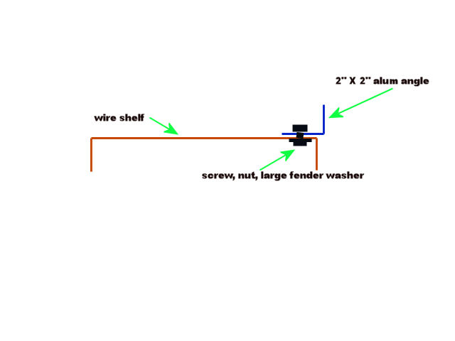

I already have it so that's what's going in. The main problem is it doesn't have a lip on the front since its for a garage. I have to strap down the compressor or it will fall off. Gallons will also slide around. I might come up with something until I get a chance to make the stainless shelves. I still have the aero tech spool waiting for me to change my hose reel. To many things and not enough time. It's not a complaint, I just have plenty of work. When you can do things yourself it can sometimes get in the way. Sometimes it's better to pay someone and be done.

install them upside down and you will have a 1" lip
I think I tried that but it wouldn't work. I forget why. These are designed to lock on to the bracket. That may have been the reason. I'll look again.

How about:
