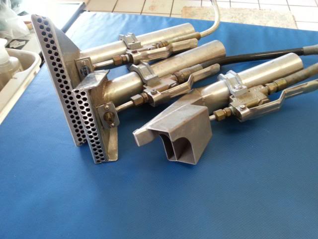

I use this older 40" tool.
I pre-spray the risers and treads, then go up the stairs, holding the tool in front of me to clean the risers.
When I get to the top, I reverse the tool to the normal holding position and come back down cleaning the treads.
I prefer the straight handle rather than the "S" bend style as I find it easier to control when holding it away from me going up the stairs.
For extremely bad-bull nose, I use the tool at the front, called a "Hugger".

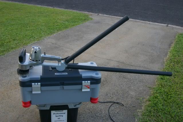

Other times, if the stairs are not really that bad, I will use my Cyclo with extension handle.
Shown here with both handles, although I mainly only use the shorter handle, placed in the position where the long handle is.
I also use this in the same manner as my stair wand, re; going up and coming down the stairs.
Without the handle, it can also agitate the bull-nose effectively.

Short wands from the Shortwun. Most impressive collection, I think you win the obsessive clean stair award.
Thanks Bryan, the Hugger was bought for upholstery on the round corners, but I found it better for stairs.
The other two are drape/curtain tools.
Shorty.:very_drunk:

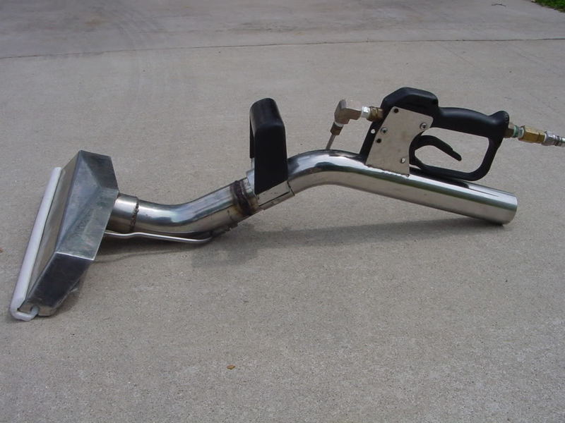

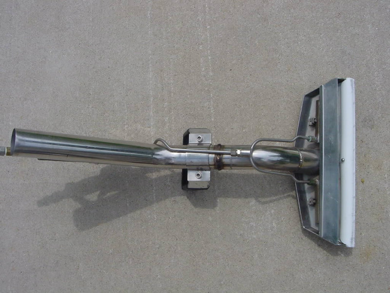

Doc, surely you've got a number of wands laying around that are no longer used. Play around with a couple of them, have your welder cut out the middle and weld it back together. Try different lengths and styles. This is mine, I'm only 5'7" so this works well for me.DSC00848.jpgstairtool.jpg
