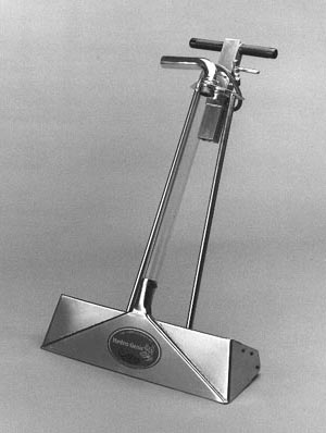

Man I loved those things back in the day! I think we still have 4 of them but I think only one works. Two need new valves one need the spray bar welded it has a pin hole. We use don't have a need for them.... yet.
How did Jules say it in Pulp Fiction?
This was my "Bad Mofo" in the 70's
