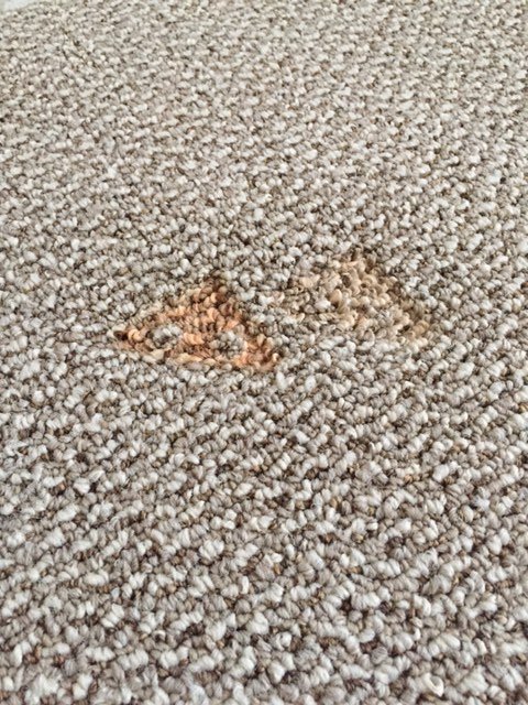

Carpet is one year old. It's developed an orange stain where there was pressure form furniture-couch legs, bed frame wheels, etc. Not all areas that had pressure turned color. Any ideas what would have caused this? The legs/feet/rollers where black plastic and never caused issue before.

How can black plastic turn the caret orange? Never been cleaned. Somewhat humid location, not overly. Strange. Have not tried Stain Magic.
It must be the compounds in the black coloring. ???
Concrete is porous and water vapor move through it, it was have reacted with the legs. Any other furniture like dressers or chest of drawers leaving discolorations?

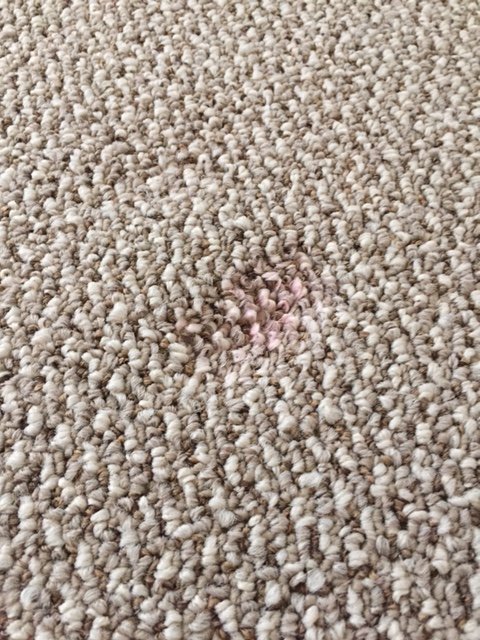

No urine. Stains are on slab level and second story. All bed frame impressions had from no staining to light orange. Couch had the picture shown to no staining. Very strange. Didn't see any pressure points from heavy furniture other than listed. Carpet looks very cheap.
