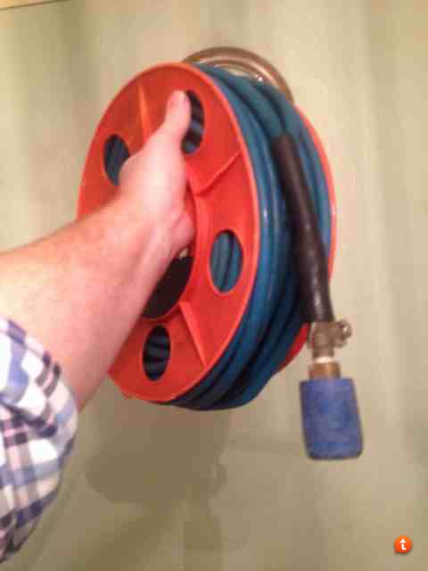

I like raptor blast. 100 ft on a orange hand held hose reel. Carry it in the house and reel back to the truck.
Pictures ?
Worth 1000 words : )
I'd like to see this set up as I use the jerk n run method off the reel.
Sent from da bak seat of a Purple Caddy where the roadkill is real : )
J
JS41035
100' on a hose reel. Go to the farthest point and reel back. I still have a live reel. But this is nice because you don't have to drag hoses in. Just use the live reel when I'm a few feet short.

Usually have 3 100' reels like that on the truck.
Water feed hoses are similar, 50' sections of 3/8" air hose with garden hose and related quick couplers on same size cord reel.

Even if you only put 50 on a reel it's still handy.
Yeah there's a black knob. They last about 3 months. I like being able to walk up stairs with 2 reels. 100' of solution. Hydro force and wand in one trip. Plus you always know exactly how much vacuum to bring up next.
