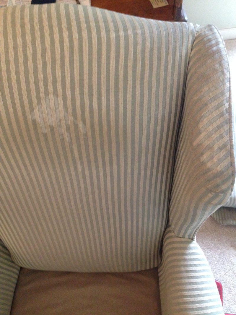

This chair was 25 yrs old and the previous cleaner started it and said oops ... I took it on - written as - to improve a damaged piece and was able to blend the bright areas as I removed most of the green. It was like the color let go. What you see here is before I started. Ive never had a piece lose the color like this one. They loved the fact the areas didnt stand out like a sore thumb.
That's a wet clean fabric. What did the cleaner do to "F" it up? Looks pretty soiled.

Yes it is a wet cleanable .. it had a ws code not that that would matter .. the soiled looking on top right is his water and detergent drip. Looks flooded without proper extraction. Custy says it was not like that before he did it. Im thinking ammonia based cleaner/spotter may have done something? Im guessing he left product on the fabric .. I really dont know why the green was cleaning away. It was like a snow cone effect. The more I extracted - the more the green faded.
I've seen it happen and I hate it. Fortunately its rare. The bigger concern is that its generally not me doing the cleaning so the guy behind the tool must recognize he must stop when something doesn't appear right. Not always an easy judgement to make when different fabric look different when wet.
