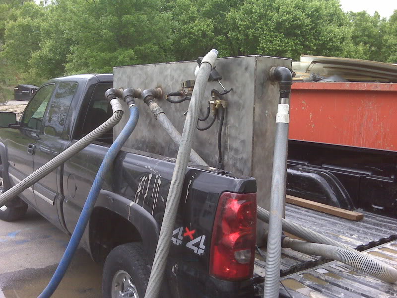

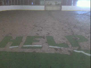

Silt from a near by creek washed across indoor soccer fields leaving about an inch of muck! We are use a 110 gallon waste tank as a giant filter box to catch the rubber infill, sticks, leaves and assorted stuff. Anybody have an idea for a better way to do it?
The manufacturer says to pressure wash it, however the silt stays on the rubber creating a dust issue. Any thoughts?

the rubber granuals, are supposed to act like sythetic soil. Well with that much gunk that got tracked in there, it wouldn't be very sanitary to try and filter out I would think. Might be better off power washing and extracting with super large wet vacs. like the kinda that go on 55 gallons drumbs, then just have a bunch of drumbs that can be capped and move to the next empty one. After all cleaned up, have them bring in some more rubber. Seems like it you would have alot of time dumping that wast tank.

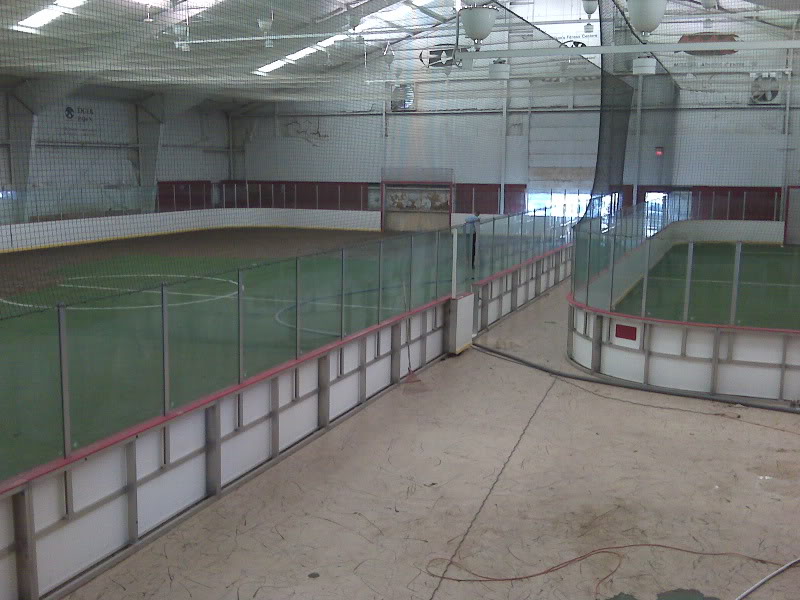

The Big Field is a Full sized Soccer field then the kids field is 1/3 the size.

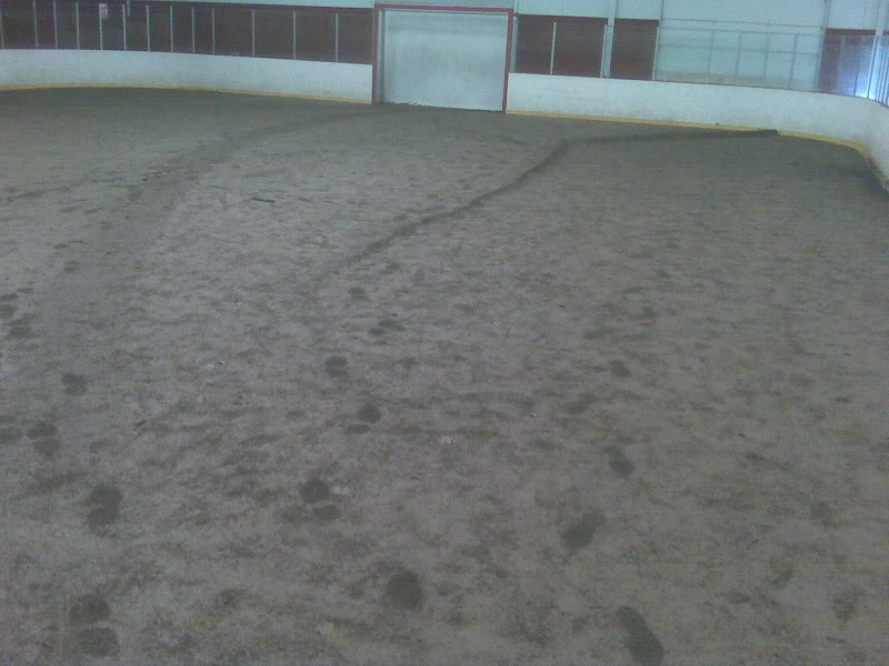

We are going over it and vacuuming out as much mud as we can then going over it with a leaf blower to remove the debris and coming back to clean it. By using the spare tank to catch the "Gunk" we can clean for almost 40 min before it stops up the filter! It is slow and gets boring after the overwhelming sense of hopelessness!

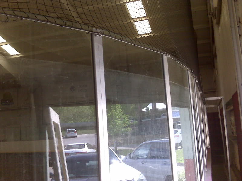

The water line on the glass.
This is the next problem the water made a wrinkle that needs to be removed!
