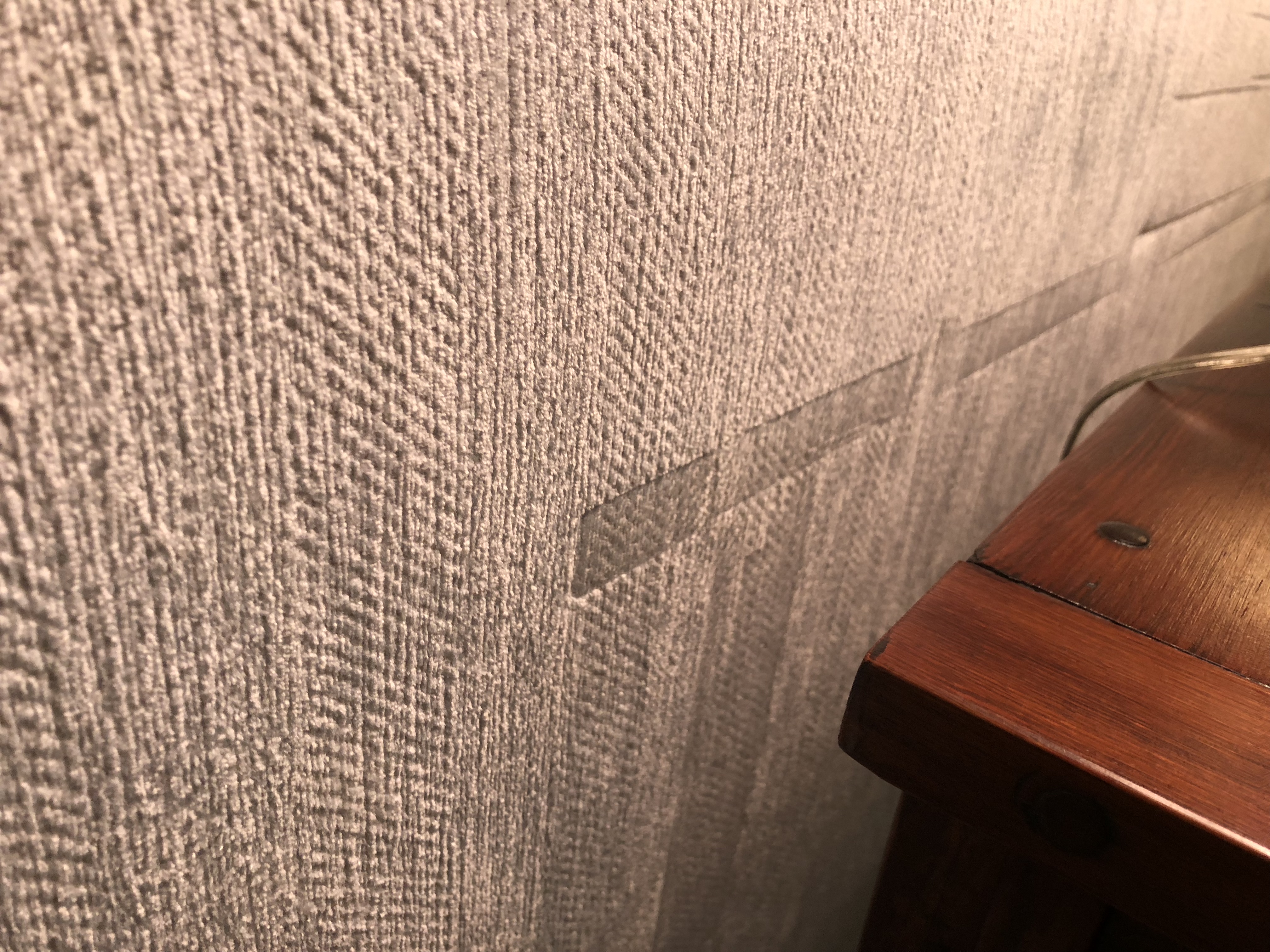

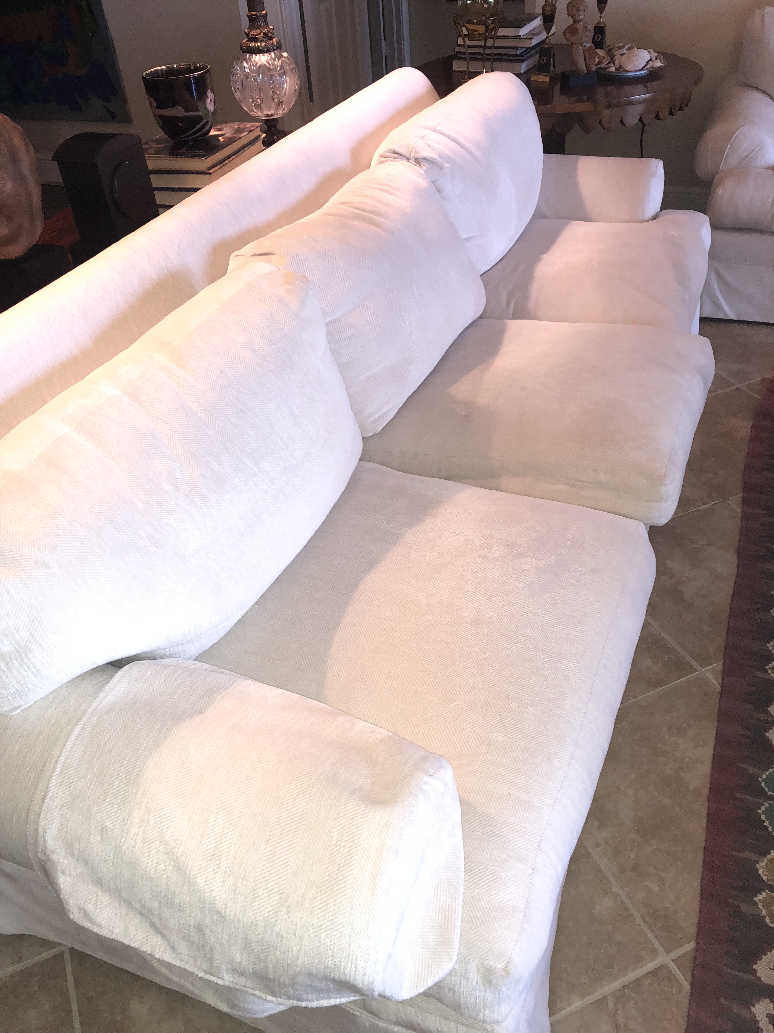

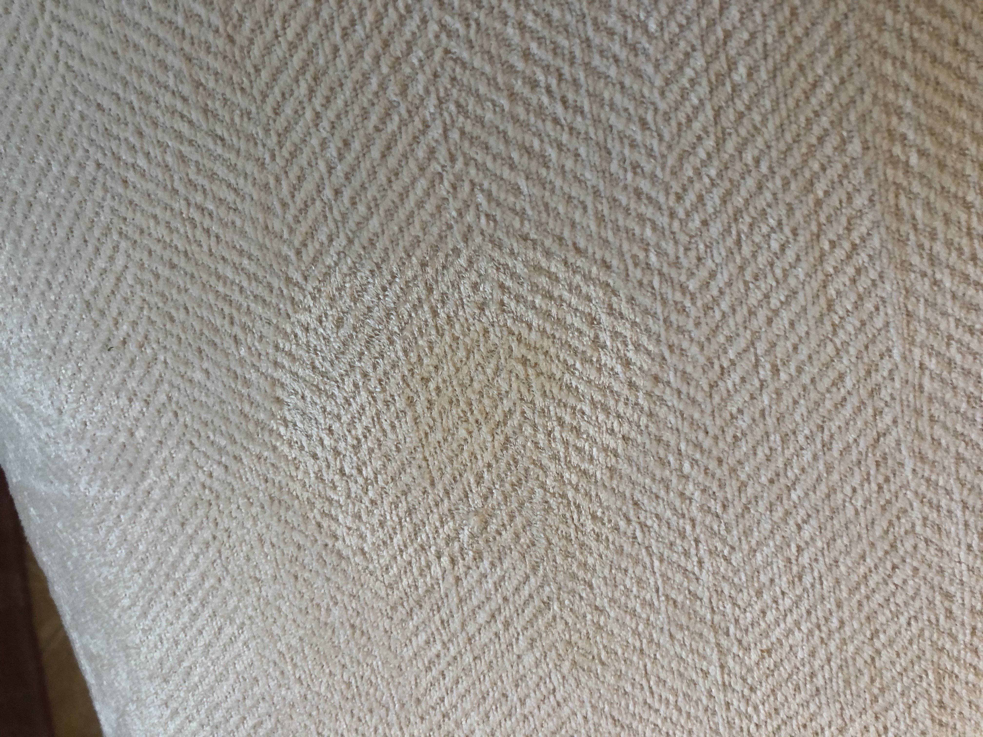

Pictures.

Doesn't look too bad. If they are willing to take a slight risk, test the zipper size of a cushion and see how it dries.

make no promises about texture retention
Texture- That is the thing I noticed first and the thing that I doubt will be satisfactory when dry. The finish is almost a sheared velvet. Very reflective of light since it's white. A few water drops that were pre-existing almost looked like bleach spots... but viewed from a different angle they just looked out of alignment. The picture against the table with the line from the compression of the table shows the difference pretty well.
The picture of the spot that someone tried to clean also shows this.
Most natural fiber velvets and velours don't respond well to spills. They change texture as you describe. Cleaning doesn't necessarily leave it with the same change. I'm not sure if it's due to grooming or if the vacuuming during extraction leaves it dry enough not to crush the fiber down like a spill would. ???
