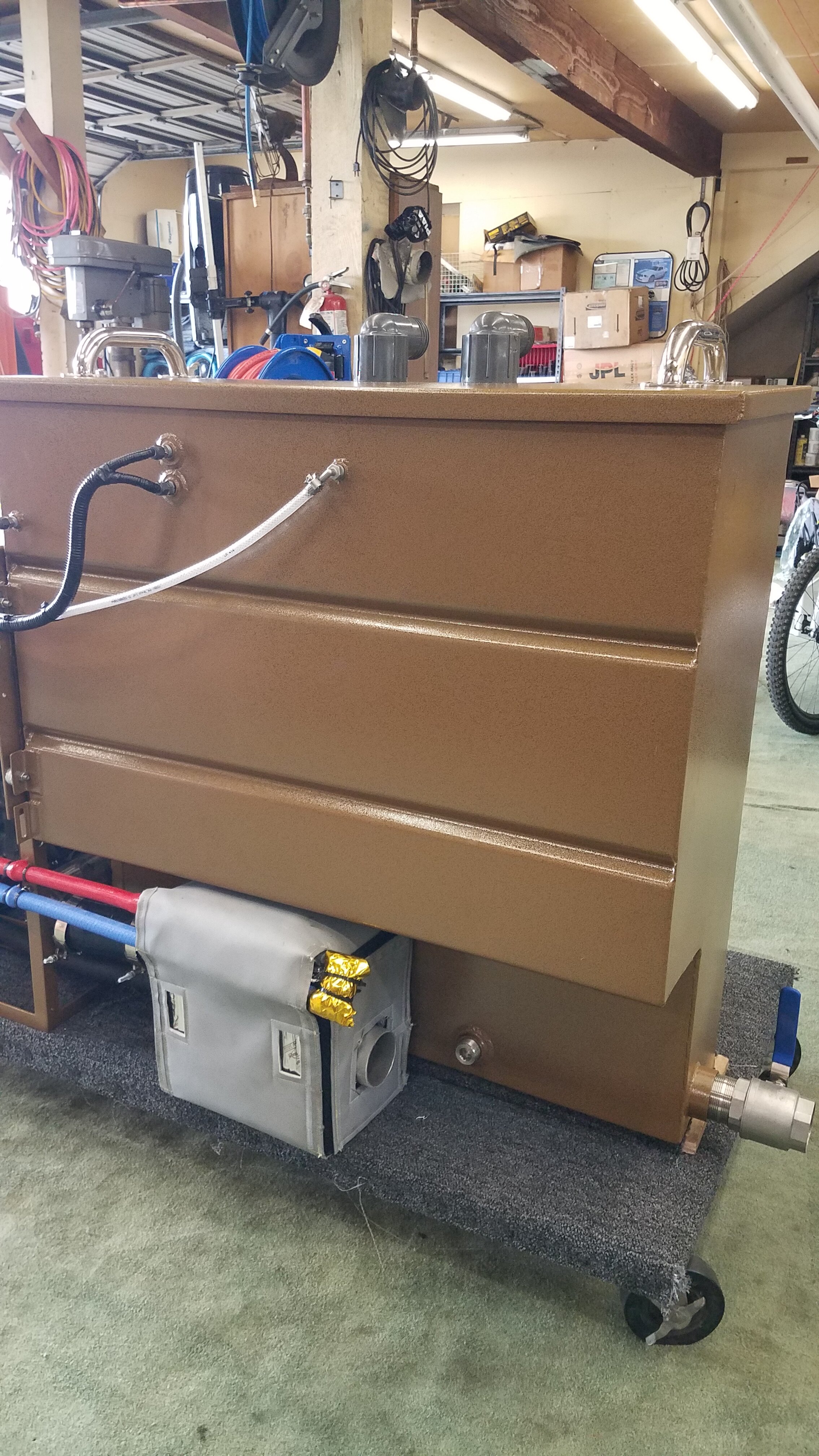

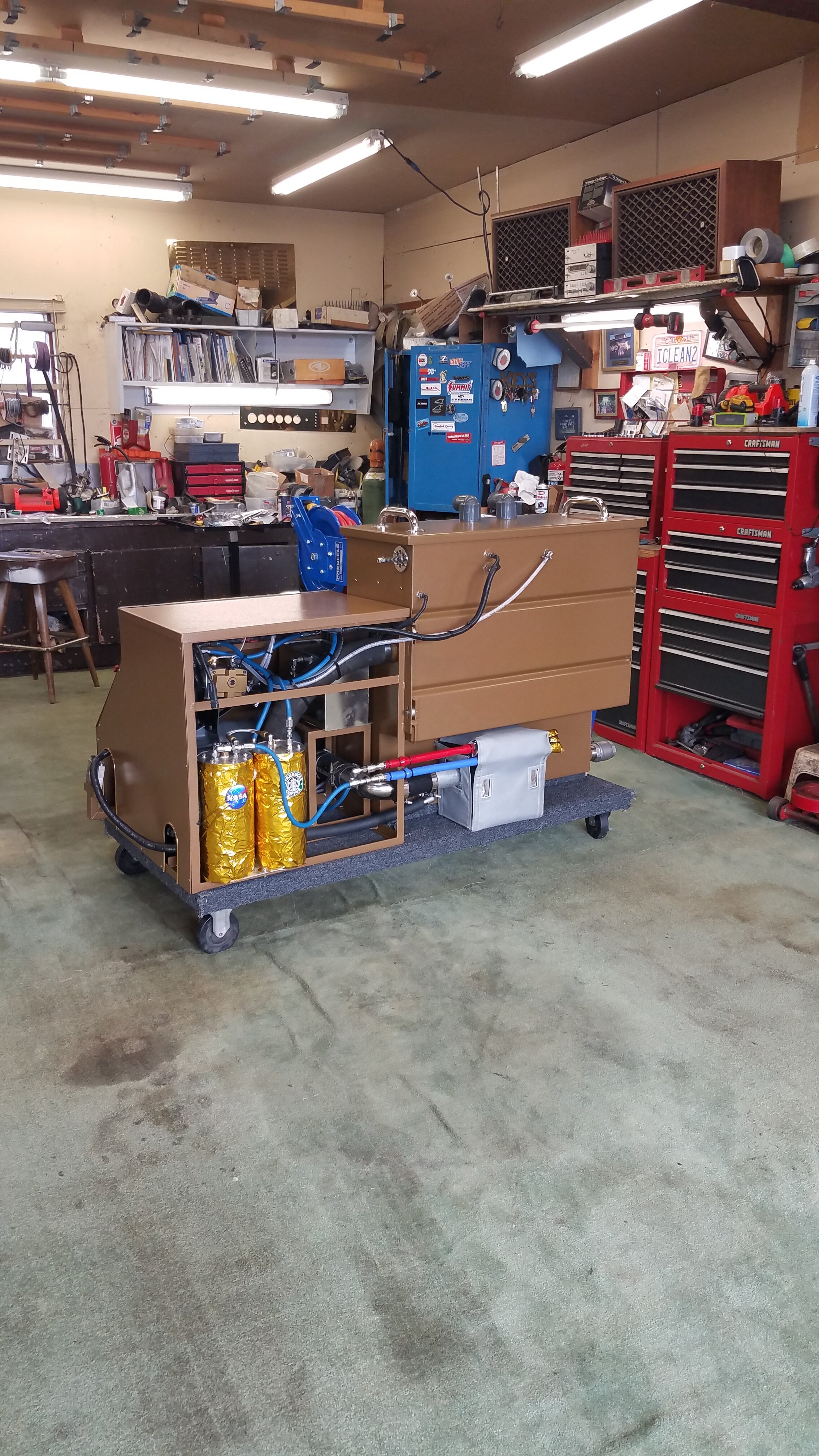

It has a pretty and modern looking control panel (but no room for a second chem jug). The salsa afterburner is one of the best and easiest adaptable blower heat exchangers ive found to date ( Frankenstein's got one). A side note if you go to buy a salsa unit, don't buy a complete unit. Buying it as parts and assemble it yourself its around 175.00 cheaper that buying the complete assembly and just requires you to bolt on the side plates and sticking it in its cover.

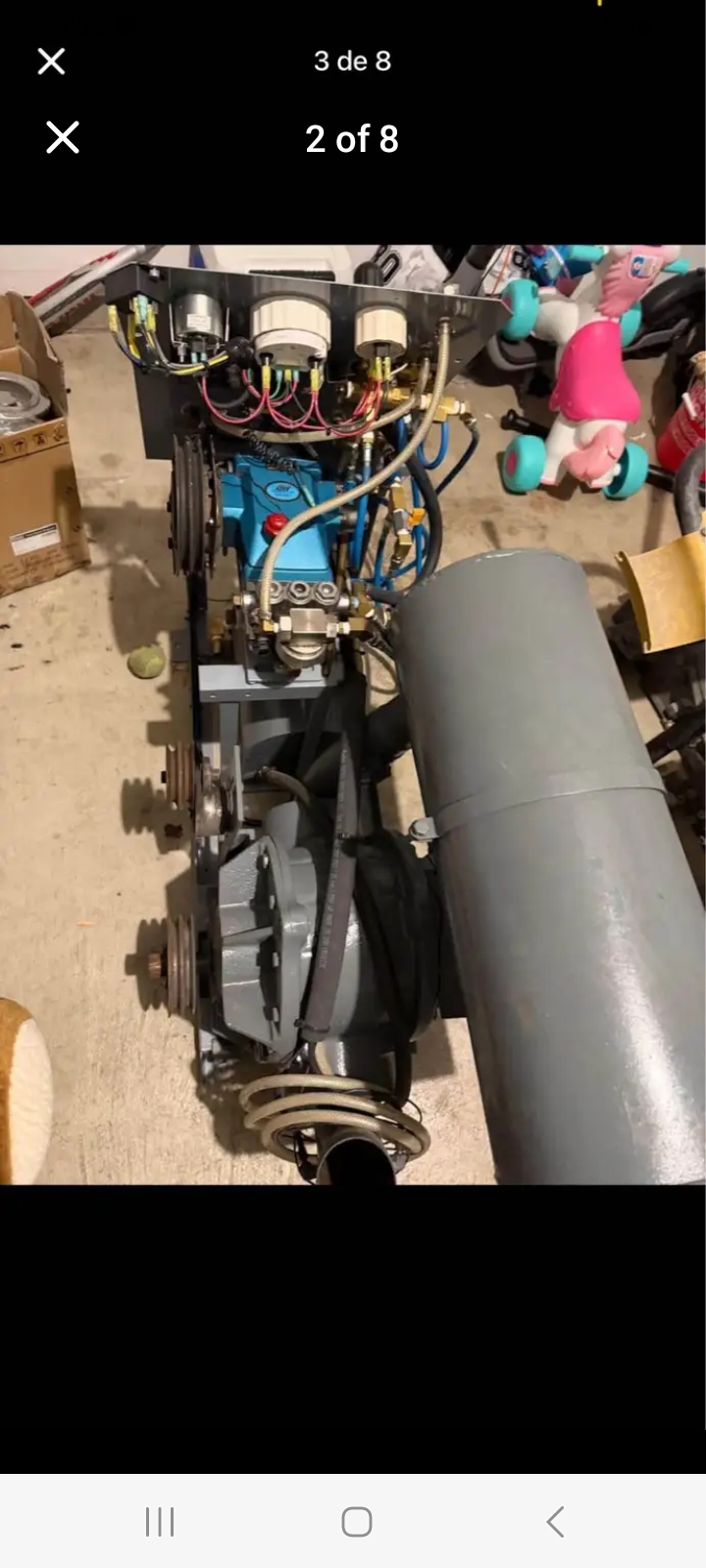

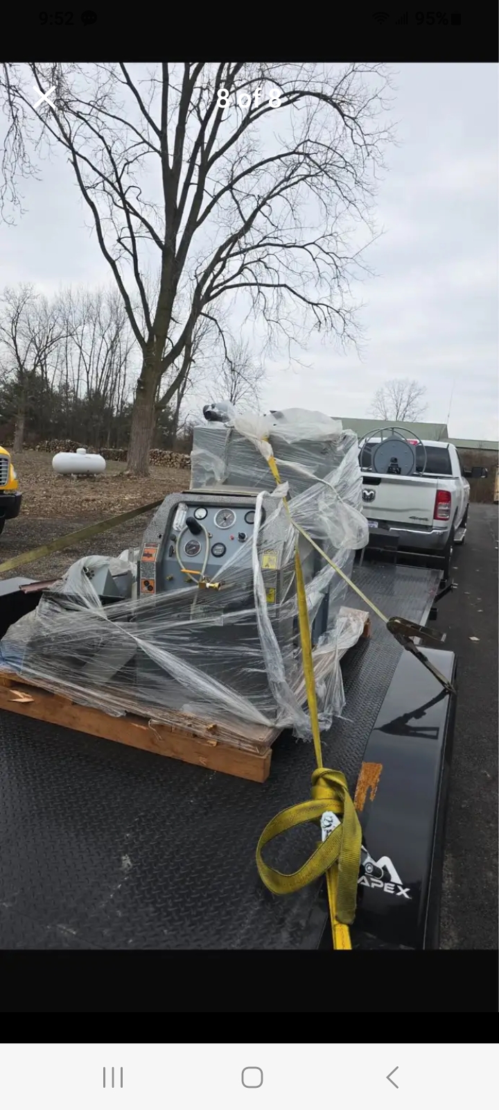

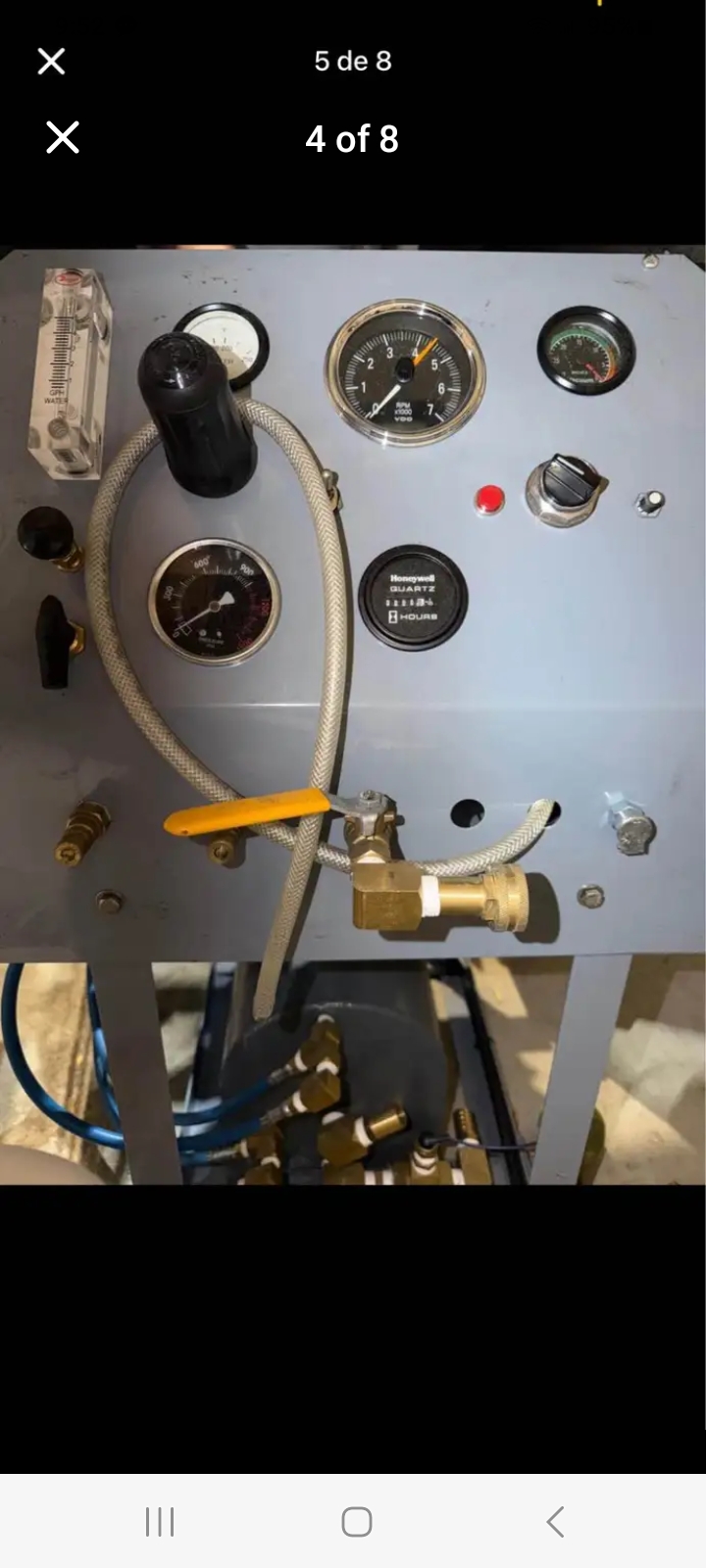

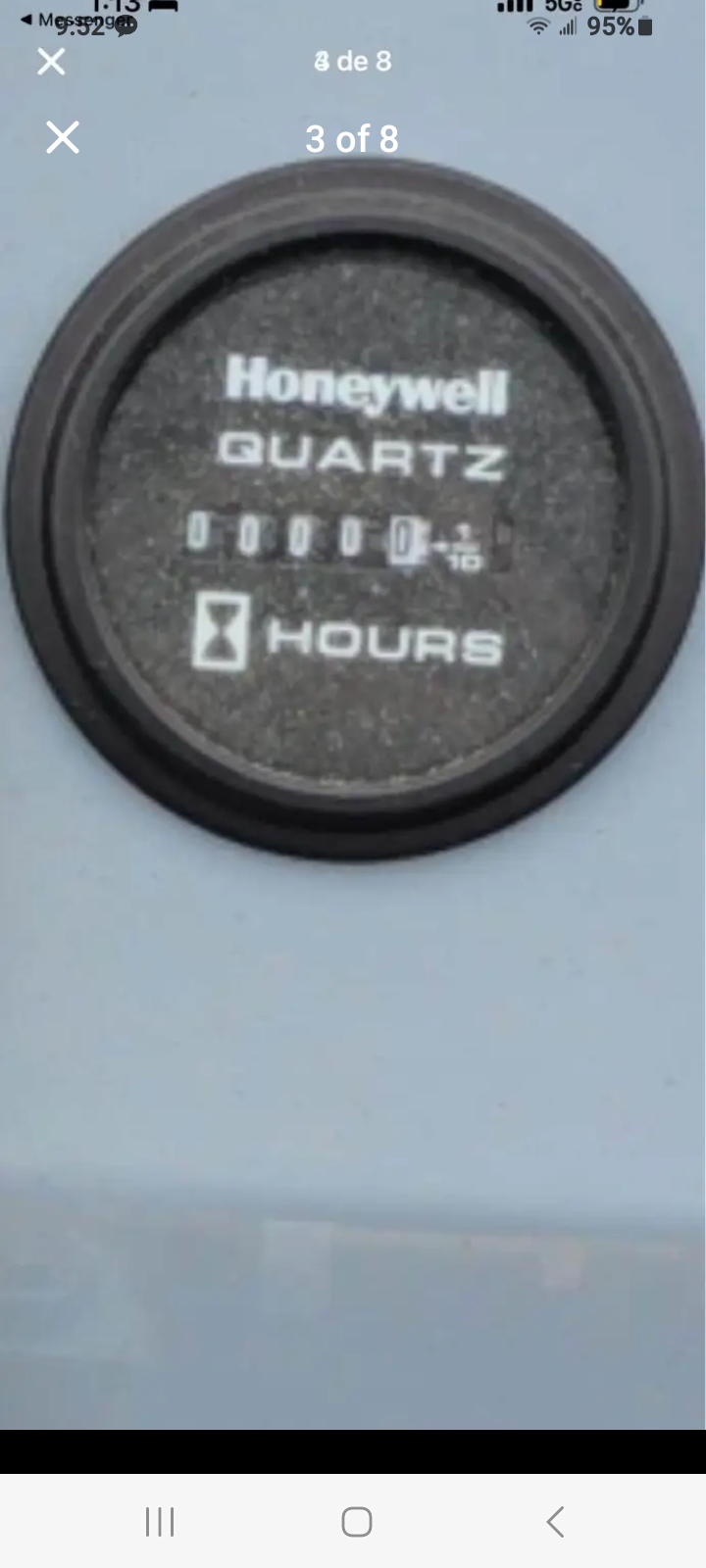

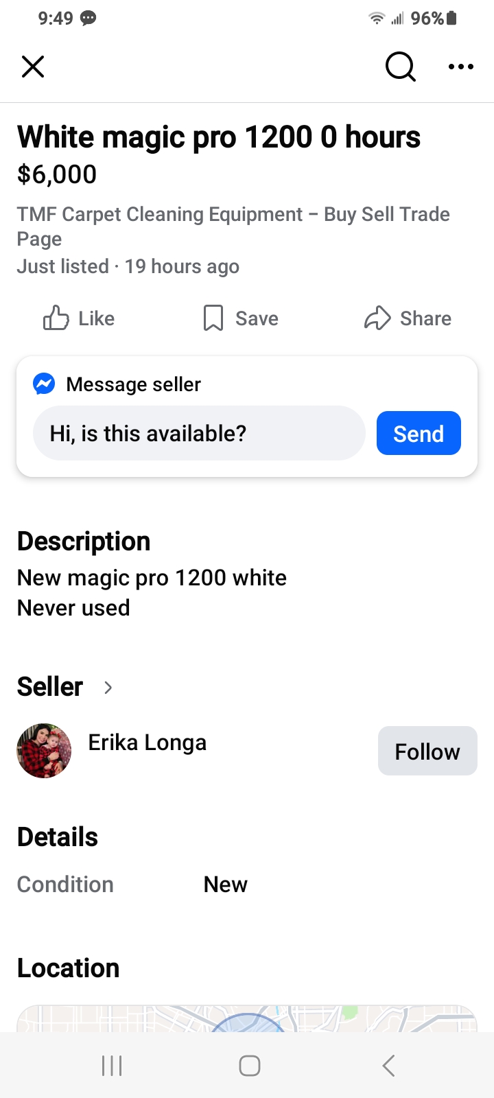

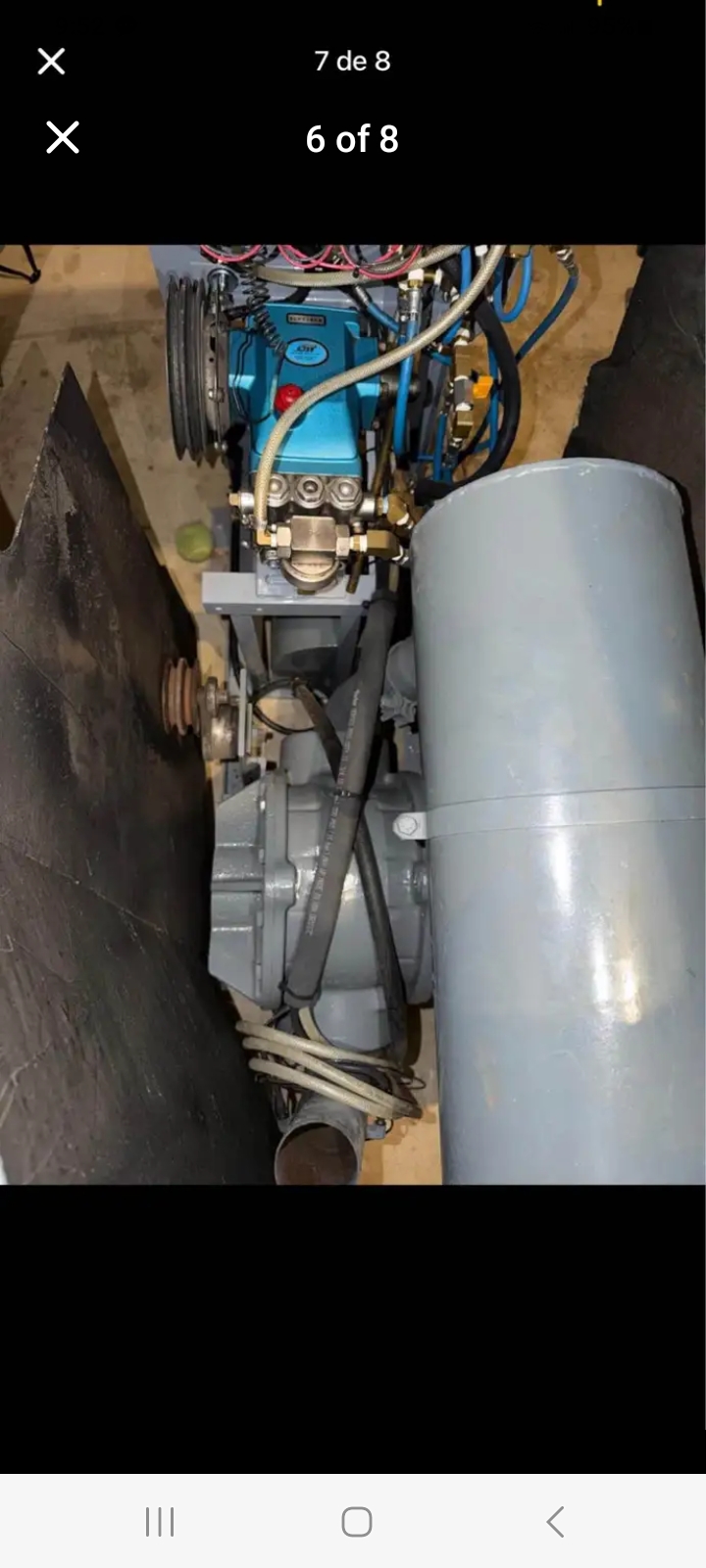

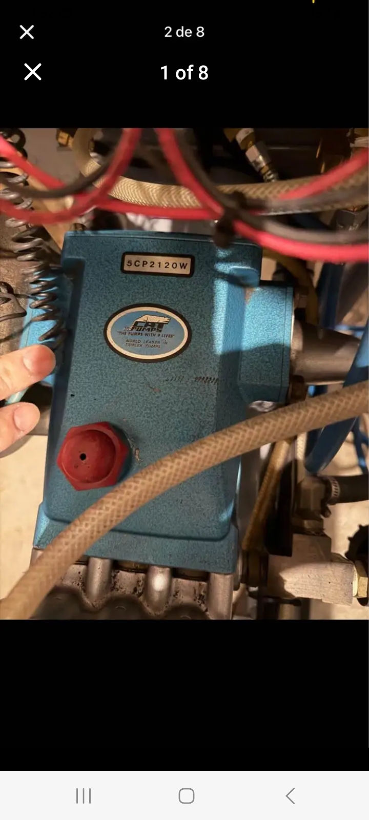

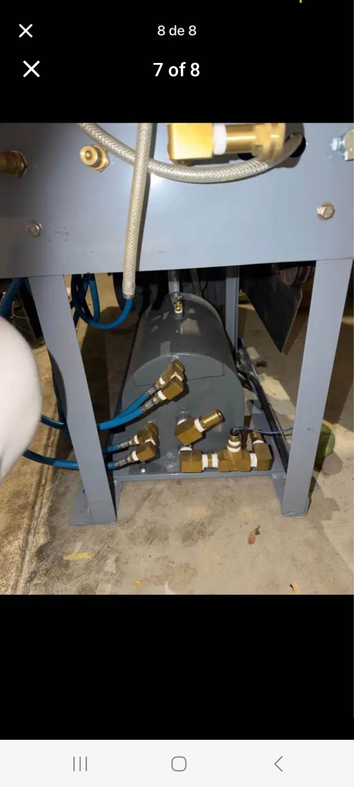

yeah, I talked to that chic about that she's selling. She said a flooring business bought it, never installed it and kept it tucked away in their wearhouse. I don't know, she seemed a little shady from her Facebook page.

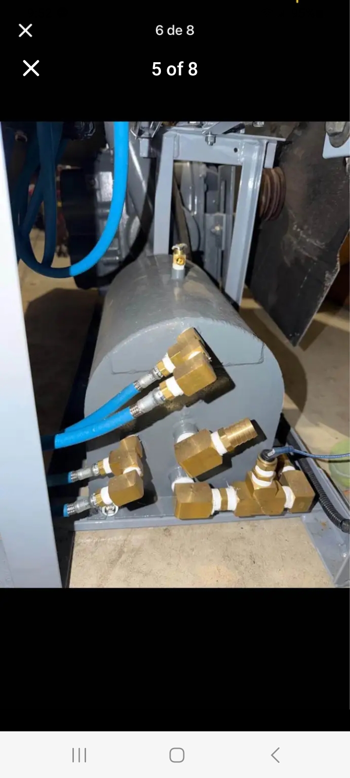

That's the third one of them I've seen being sold as new never installed. That particular one i would have to see in person. It doesn't have the control panel sticker/ silkscreen. But for me that wouldn't necessarily be a deal breaker. I would want documentation/ owners and installation manuals and be sure all the parts are there ie: driveshaft/ front&rear mounts/ throttle controller/heat taps etc etc . For me it would be the little things like weather or not it has doghouse hardware, look inside heatexchangers and blower loabs to see if ever used and maybe rebuilt. and just how complete the install kit is should have everything down to 30' of 1" heater hose. But from the pictures, if i were looking for a new machine,id drive the 500 or so miles to check it out. But thats me...🤓

It just looks like a really good parts machine for someone with an older white magic already in their van. And for that in mind, it’s a really good deal

I think this unit is for some VERY familiar with what is involved in hooking one of these units up to their van. I don't know if the "front end kit" is with this unit, and even if so, what vans it would work on now.
I'm sure Dwain could figure that out on about anything, but most couldn't

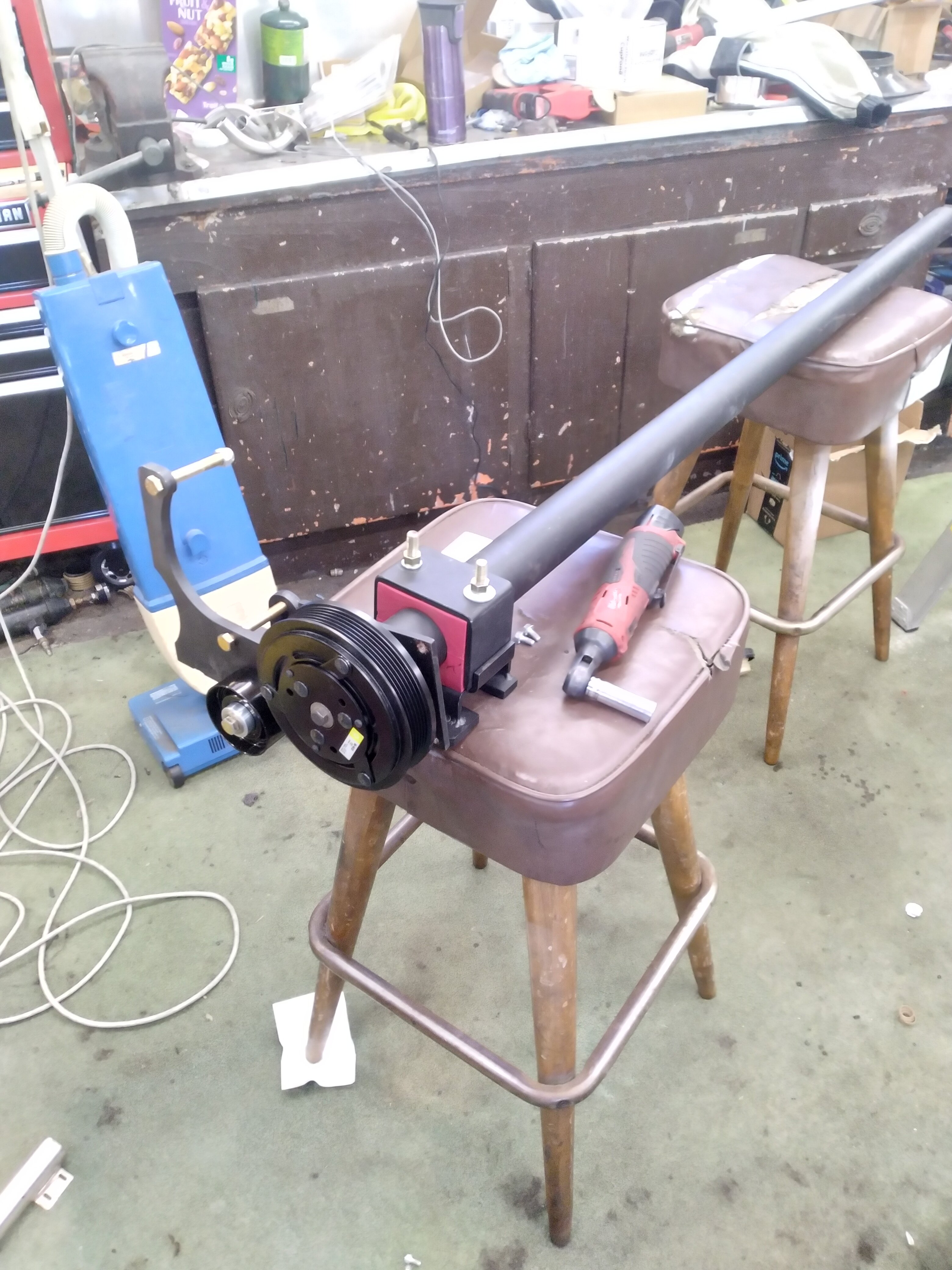

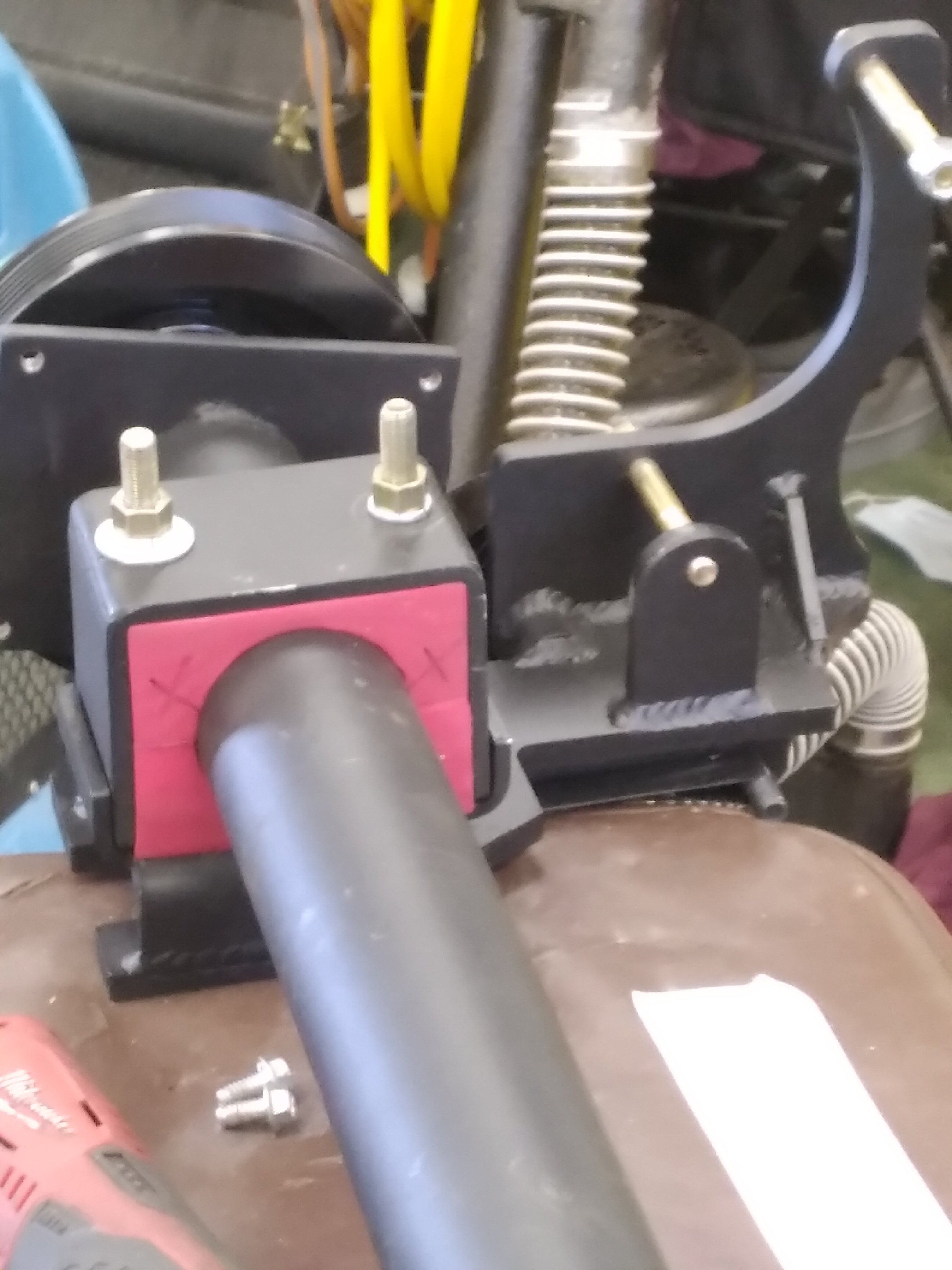

Fortunately most all pto's with the exception of steamgeni and hydramaster master used the same driveshaft. The butler,sapphire scientific, cleanco,white magic and i believe even the areo tech DDS all have the same. I've searched before to find it and the manufacturer on live and i did once but when clicking on it my fat fingers hit the wrong button and i haven't found it since. But its so universally used in the cleaning industry that an engine mount can be found. When i built Frankinstien none of the old 90s engine mounts i had would work on a 2020 chevy 6.0L i bought a complete cleanco frontend kit that came with complete driveshaft mount, air cleaner resonater relocate, coolant taps and hose, electronic throttle controller, doghouse boot etc. Because i have 7 or 8 steamgeni driveshafts i decided to modify the engine moumt to fit by boring out the bushing ¼" instead of buying a cleanco or other others shaft that already fit off the shelf

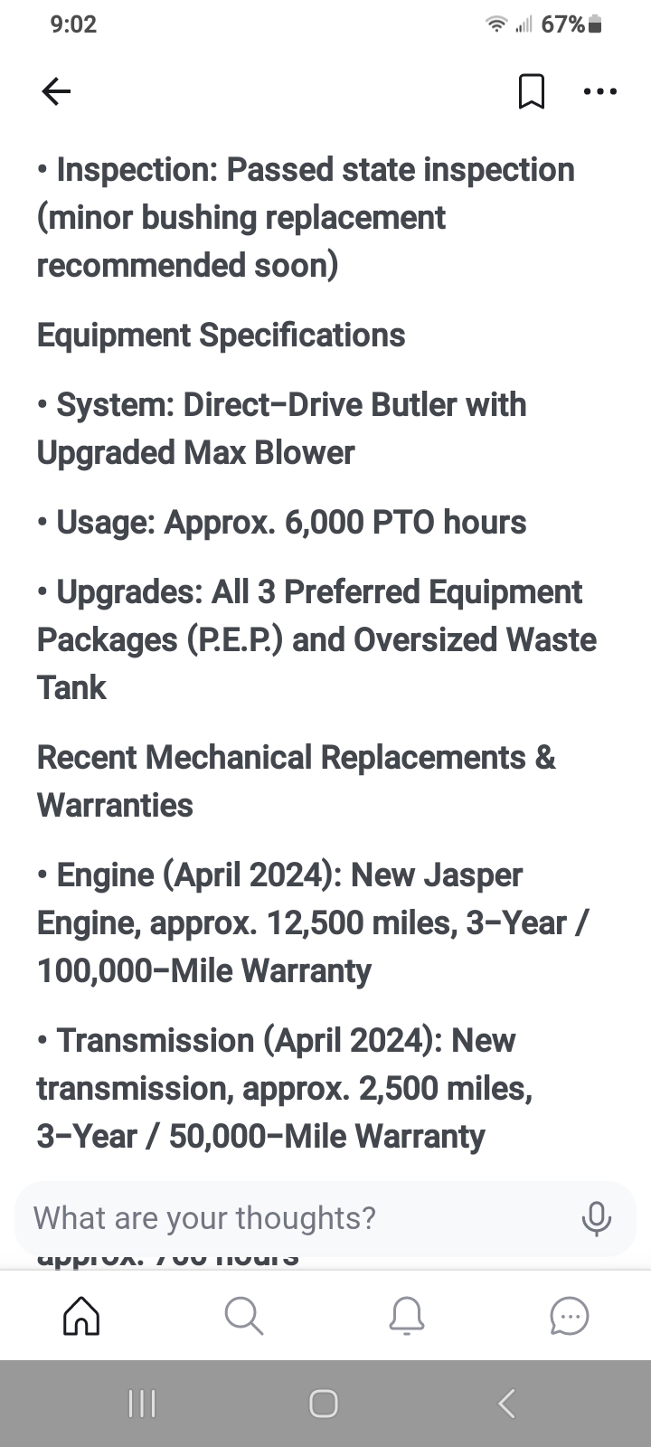

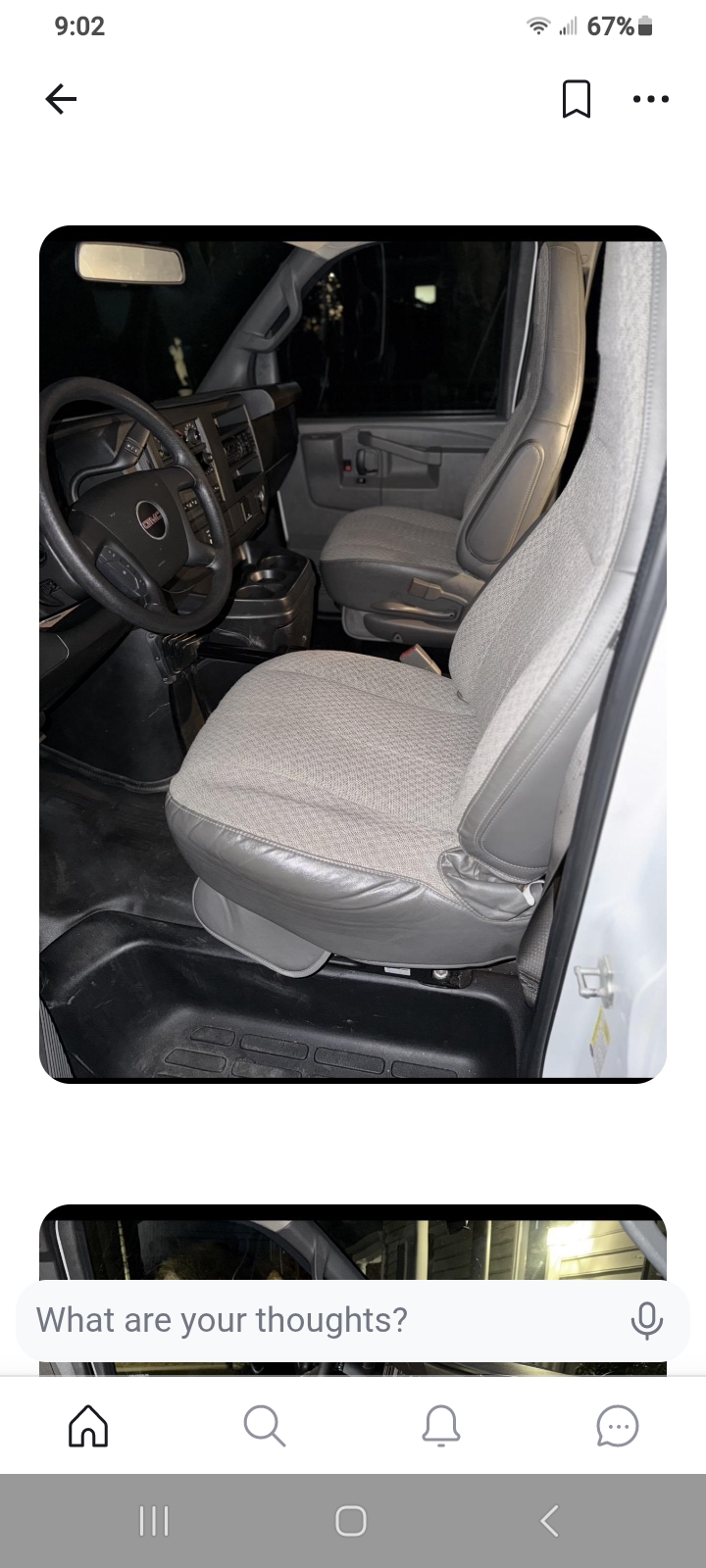

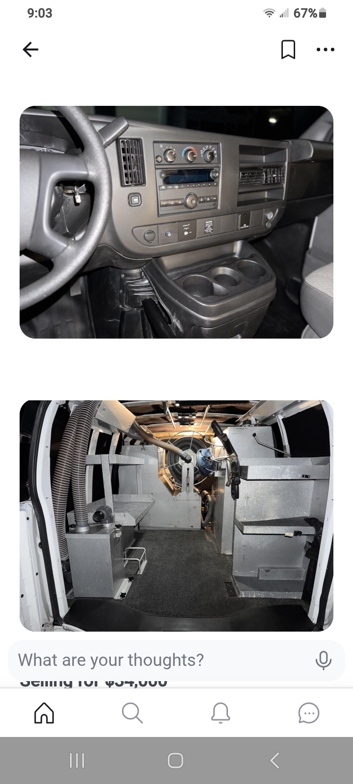

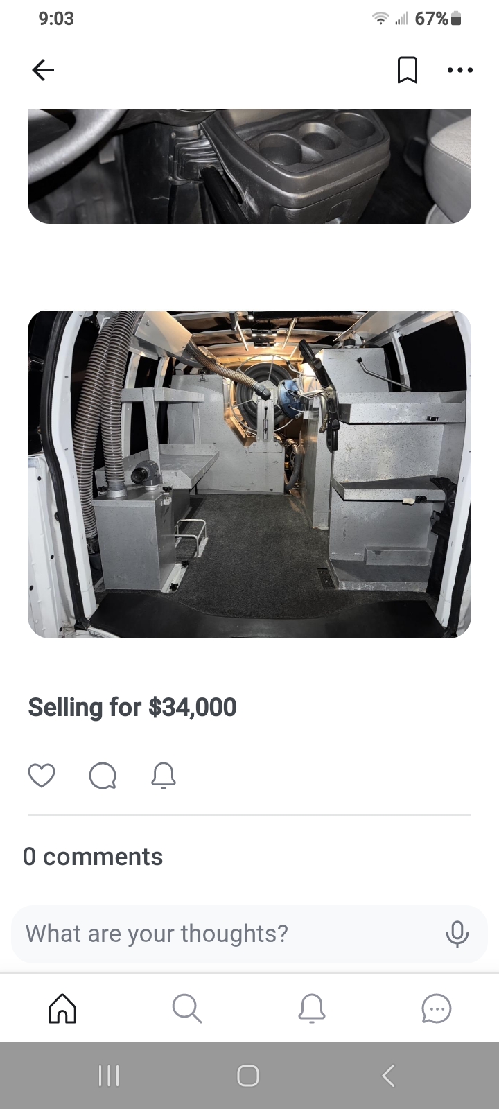

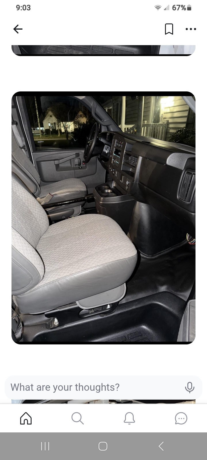

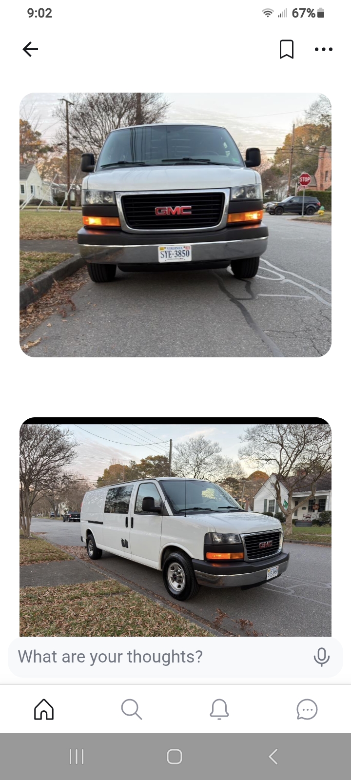

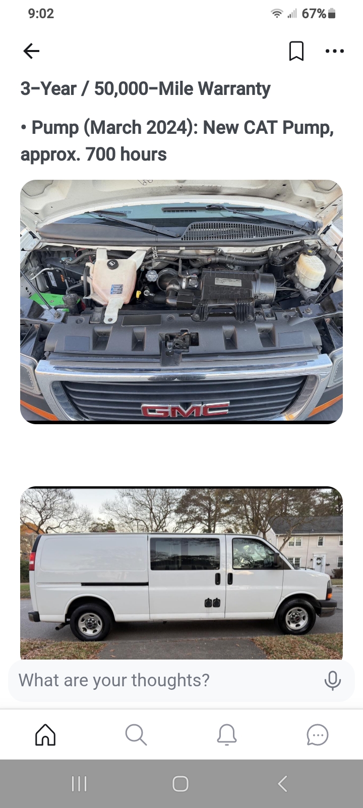

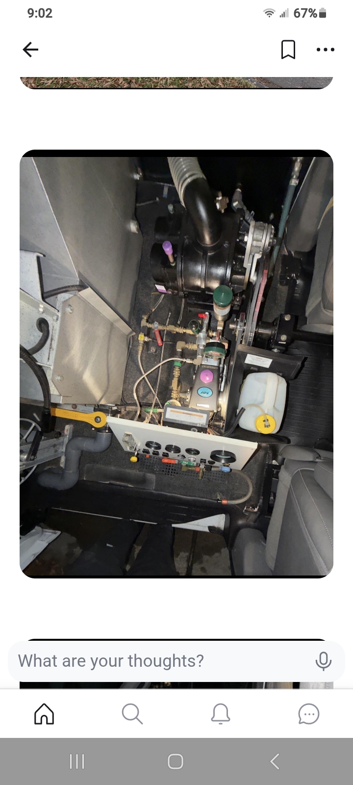

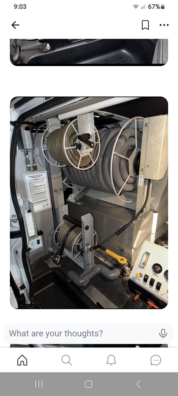

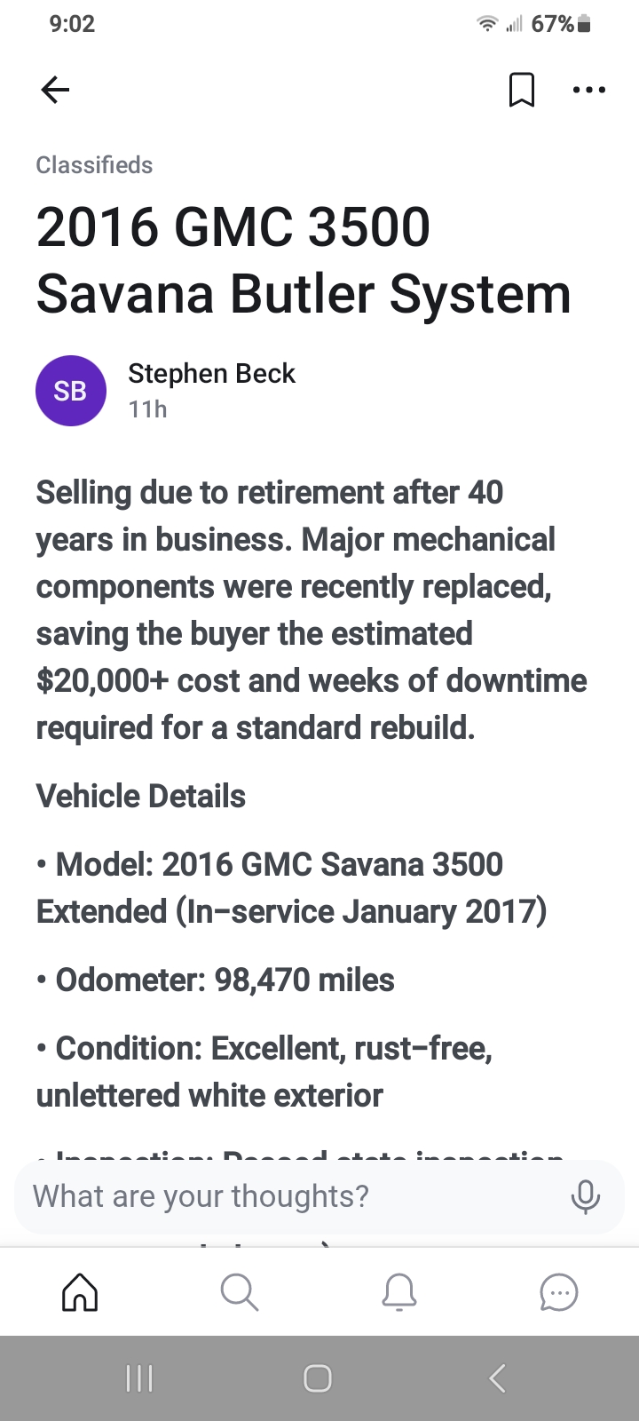

Theres a 2016 butler with a engine & transmission new and under warranty on tfm for sale pictures make it look well maintained asking 34k. Its new enough that a credit union may finance( according to the guys bio hes a few hours away from you in Norfolk Virginia)
Screenshot_20260315_210203_TMF Community.jpg Screenshot_20260315_210214_TMF Community.jpg Screenshot_20260315_210223_TMF Community.jpg Screenshot_20260315_210231_TMF Community.jpg Screenshot_20260315_210249_TMF Community.jpg Screenshot_20260315_210256_TMF Community.jpg Screenshot_20260315_210301_TMF Community.jpg Screenshot_20260315_210307_TMF Community.jpg Screenshot_20260315_210314_TMF Community.jpg Screenshot_20260315_210320_TMF Community.jpg

That is a good deal with a new engine and transmission. I'll check it out. Thanks Dwain-o!
