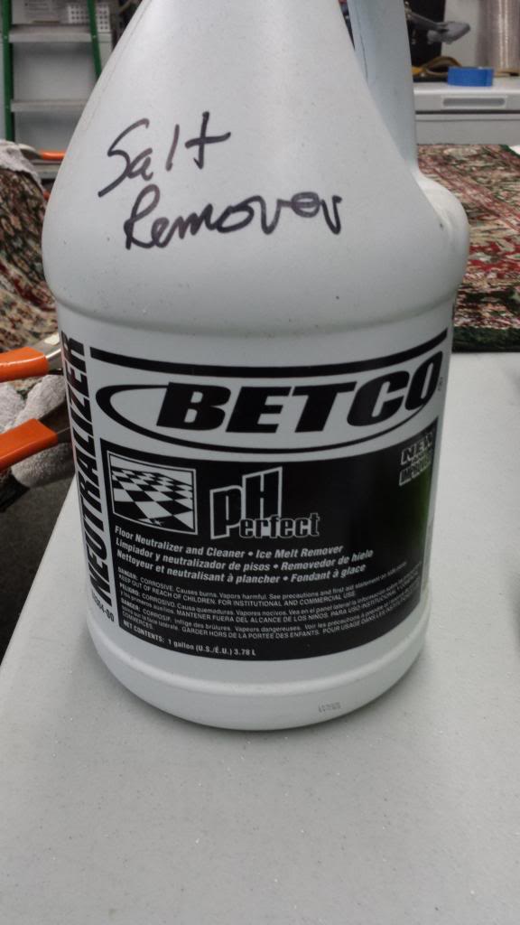

Here is a product I get from a local distributor friend of mine.

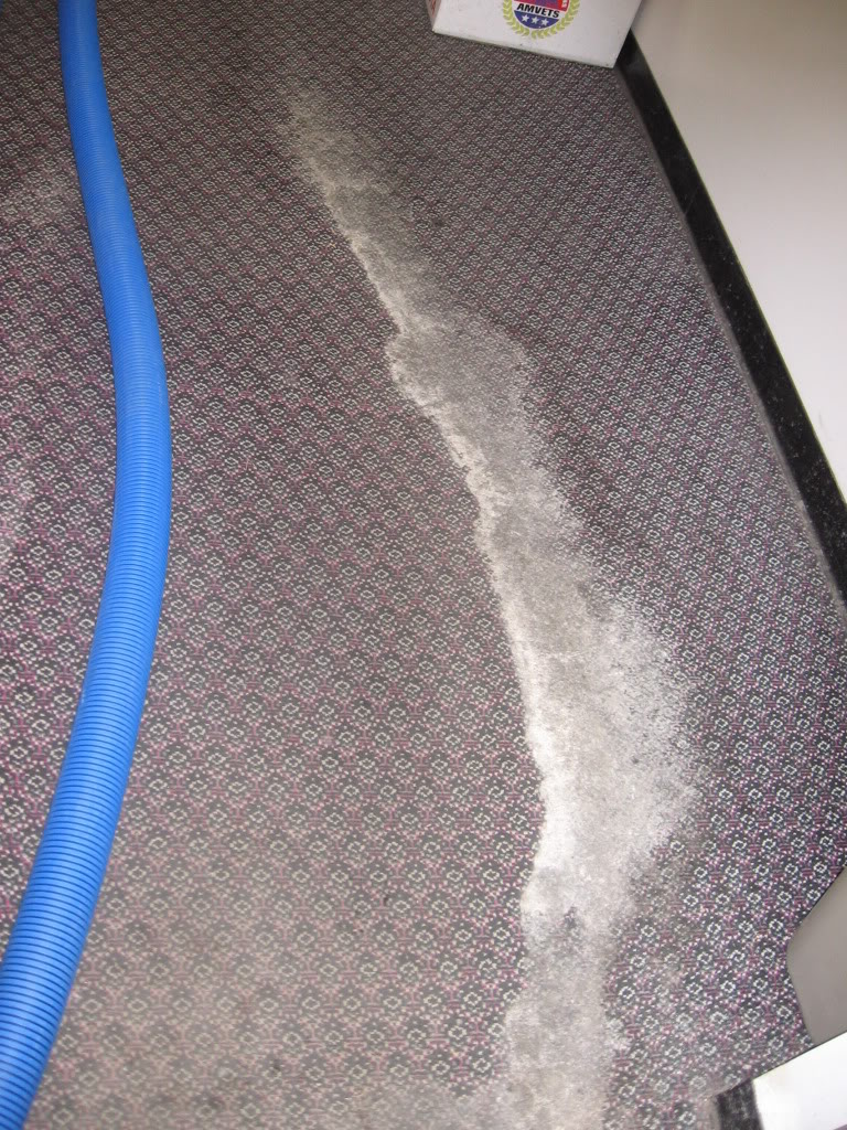

He gave me a sample once and I really liked it. We get a lot of salt residue like this around here.
It takes more than one treatment when it is hard as a rock, but we have got that stuff out with this.
This works great and I know Jondon sells some of the Betco products.
