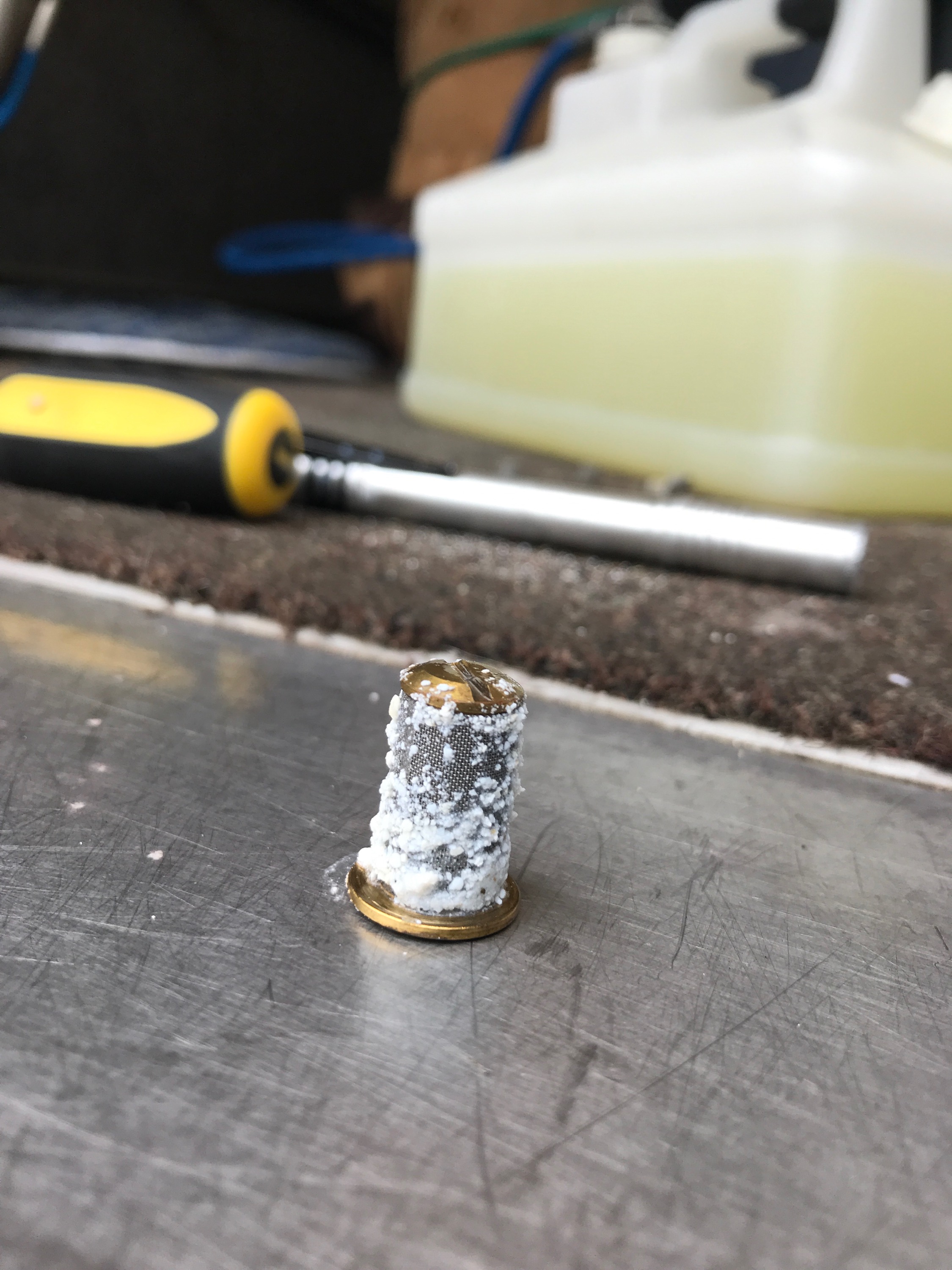

The boys have an issue with the AT
114,544
Every day the wand filter is collecting this...
We know the Kinetico isn't working right but this is beyond excessive..
Jun 20, 2016
6,393
Bc
Jeff T
Flex ICE rinse..View attachment 84646
Exactly the same problem I had. It would collect in the wand filters, and bunged up my machine completely.... yup, Flex Ice rinse... switched to End Zone, haven’t had the issues since...
23,898
Redding
Mike. I know you won’t listen to me, but that is Flex Ice doing that. If you listen to me i’ll buy that ugly ass Workhorse vac.
Matt B
Jan 27, 2013
153
Florence al
Matt Briseno
Mike. I’ve been getting the exact same stuff the last few weeks. To the point that the tool won’t even allow any water through at all. A couple times just within mins of the filter being cleaned. And I’m not using flex ice I’m using Harvard heavy duty liquid rinse. Does the stubance look almost like very fine sand ??
114,544
Ive only seen the picture above...
I know the jet screens are even worse, needing daily attention. Been running ICE for two plus years. never had this issue.
Matt B
Jan 27, 2013
153
Florence al
Matt Briseno
I used ice for several years up till 6 months ago never had any problems
Dec 20, 2006
1,171
cape coral fl.
jack zerkie
Where is that filter from and where does the chem. go threw that filter or just water into that filter My old hydramaster had same water filter but never had that build up.. Once my water softner backed up doing that.?
jcooper
3,232
IL
Jerry Cooper
Flex ice for sure. Had the same issue after a month or so.
And yes the (acorn)strainer was on. At one point I wasn't getting enough flow for the hydro force to work... Bummer.
11,197
Grand Rapids, MN
Maybe a change in your water quality and the Chelating agents reacting more?
Water Softener problems like mentioned?
Not hot enough water to mix?
Just tossing out thoughts
13,737
Georgia
Or he needs to quit messing with the powder alkaline product and go liquid. And if he's stubborn on wanting to use a powder, just use plain soda ash Arm and Hammer. It dissolves just fine.
Charlie Lyman
2,608
Meridian, ID
Charlie Lyman
I loved the Flex Ice, but someone warned me that it would do this. Sure enough it started jamming up my filters. I switched rinses and it stopped. It's too bad because I swear it would kill it on dander jobs and white berber would pop with it.
114,544
They boys went through the AT yesterday..
Filters were currently installed in the chem jugs but a month or do ago, they had worked their way off, for how long is anybodys guess
No builld up in the jugs
Fresh tank filter is clean
If its ICE, why now?
Jim Martin
Arizona
Jim Martin
They bous went through the AT yesterday..
because they NEVER make chemicals consistent....
