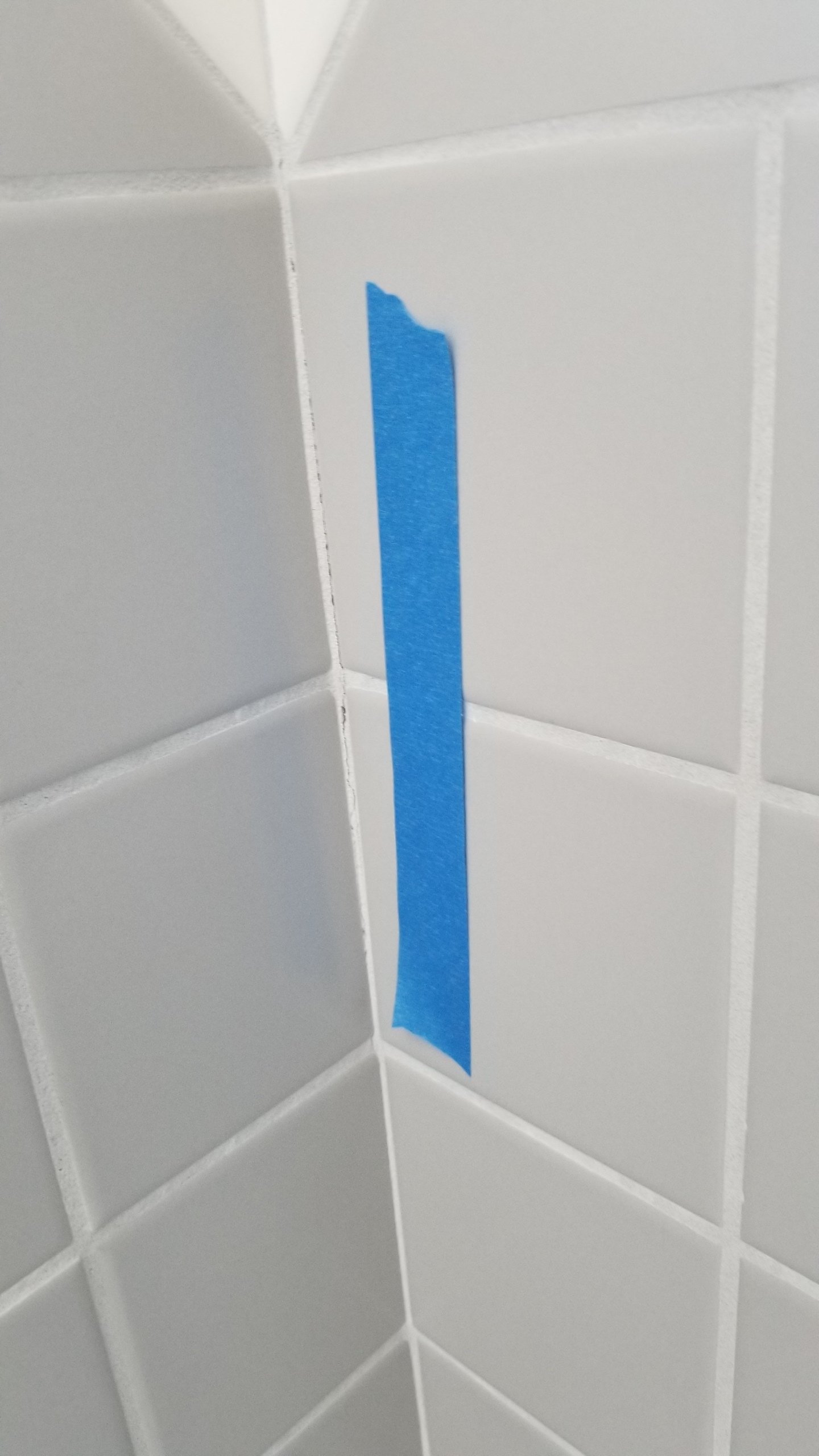

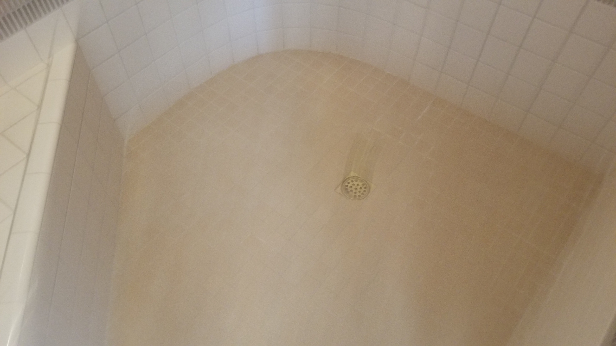

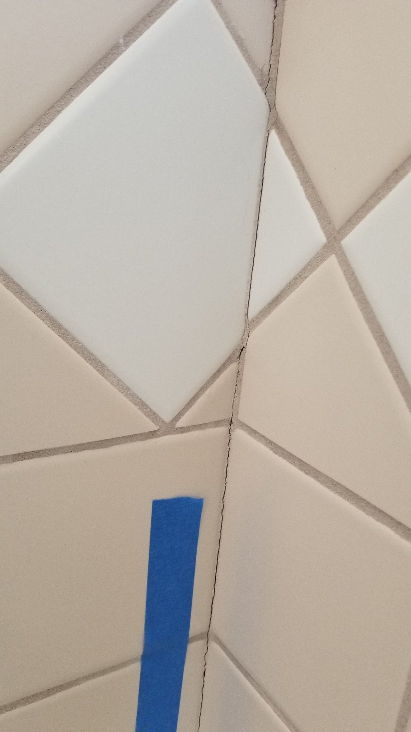

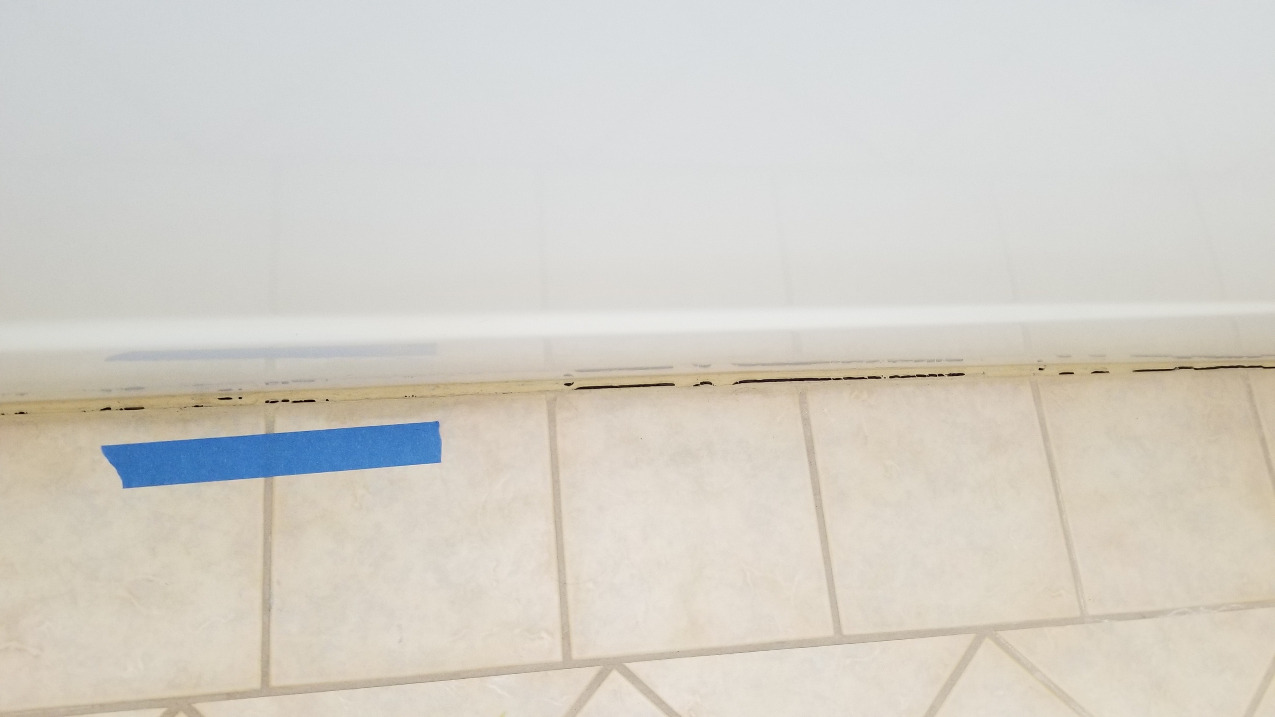

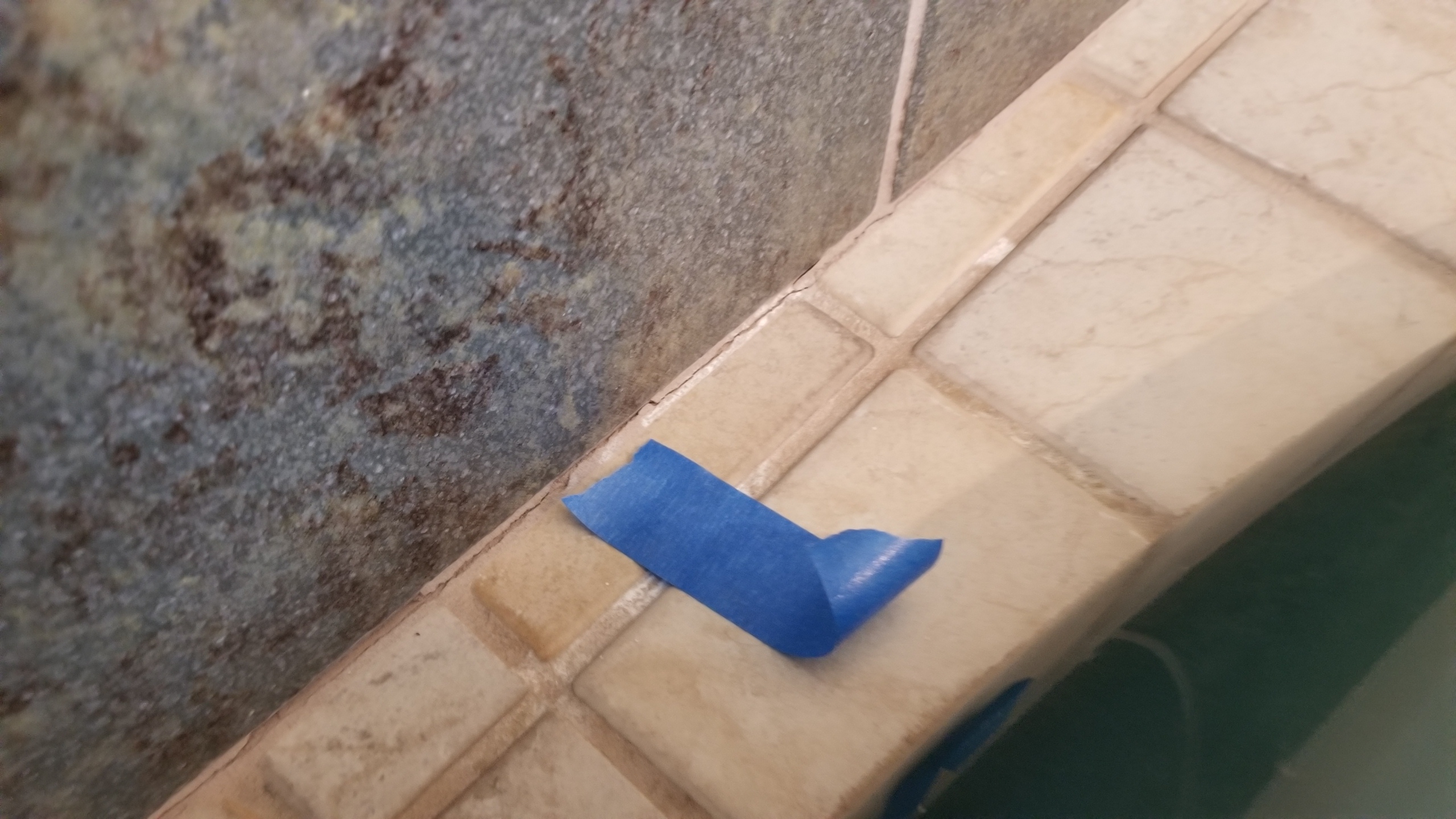

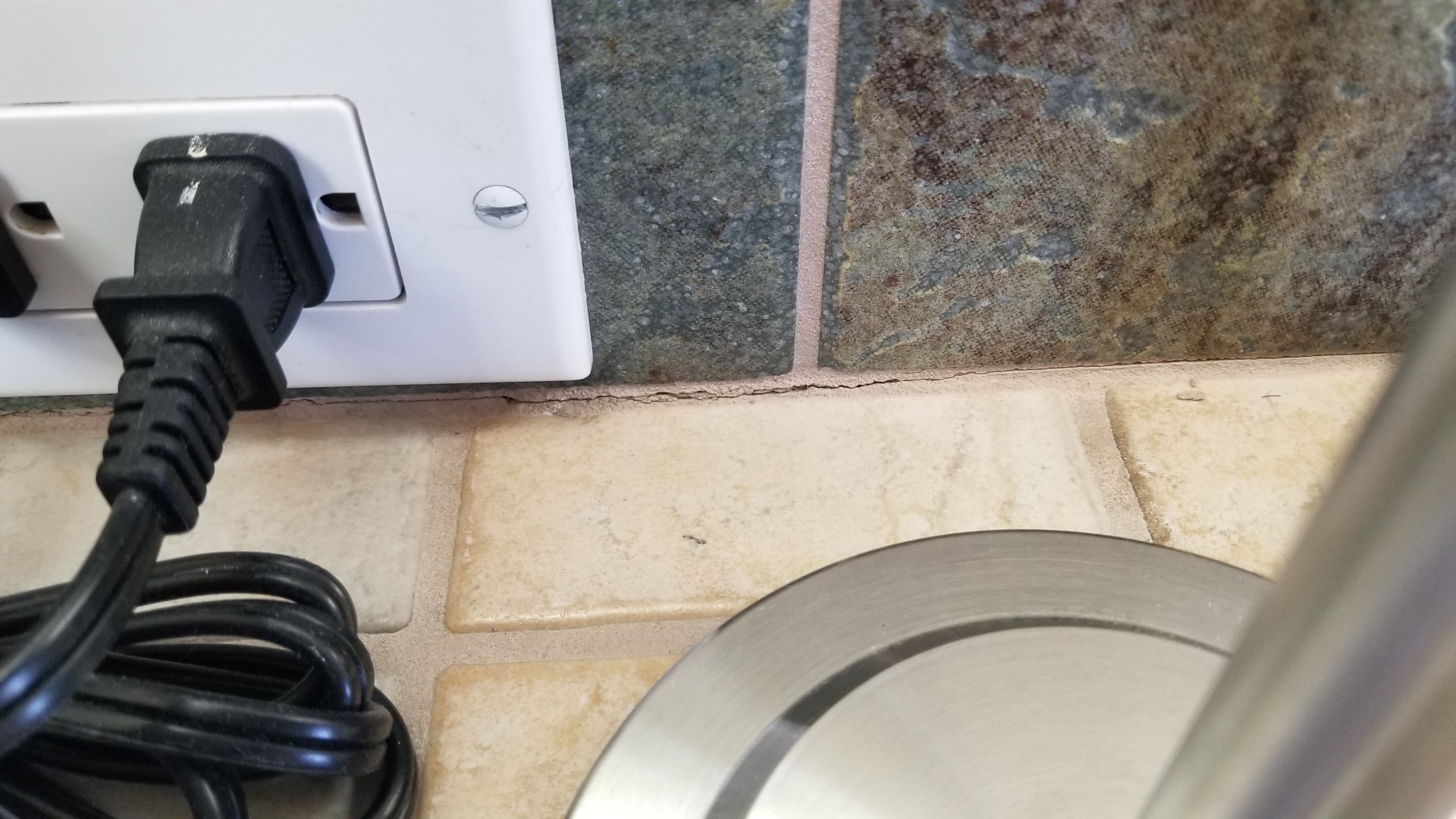

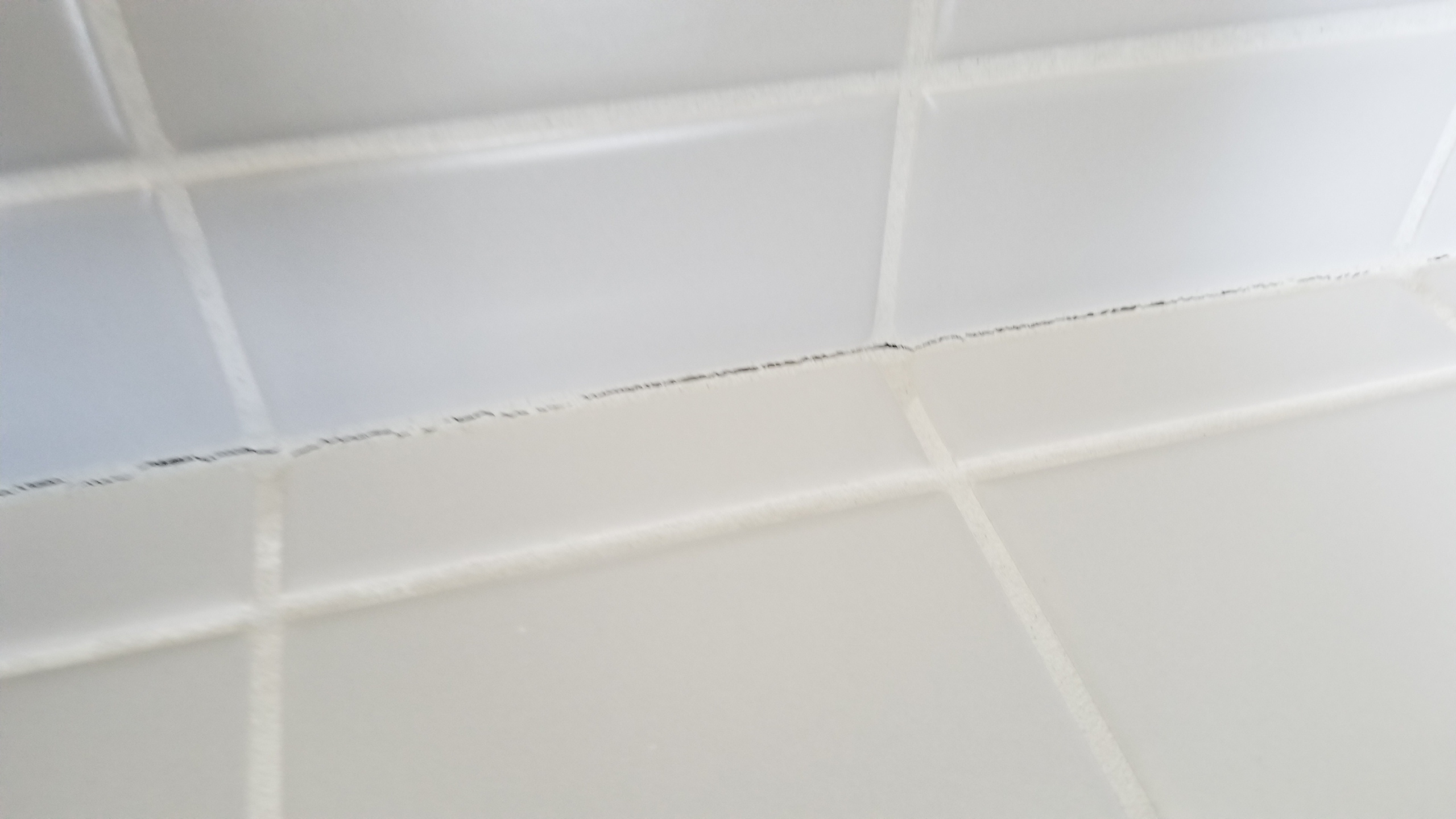

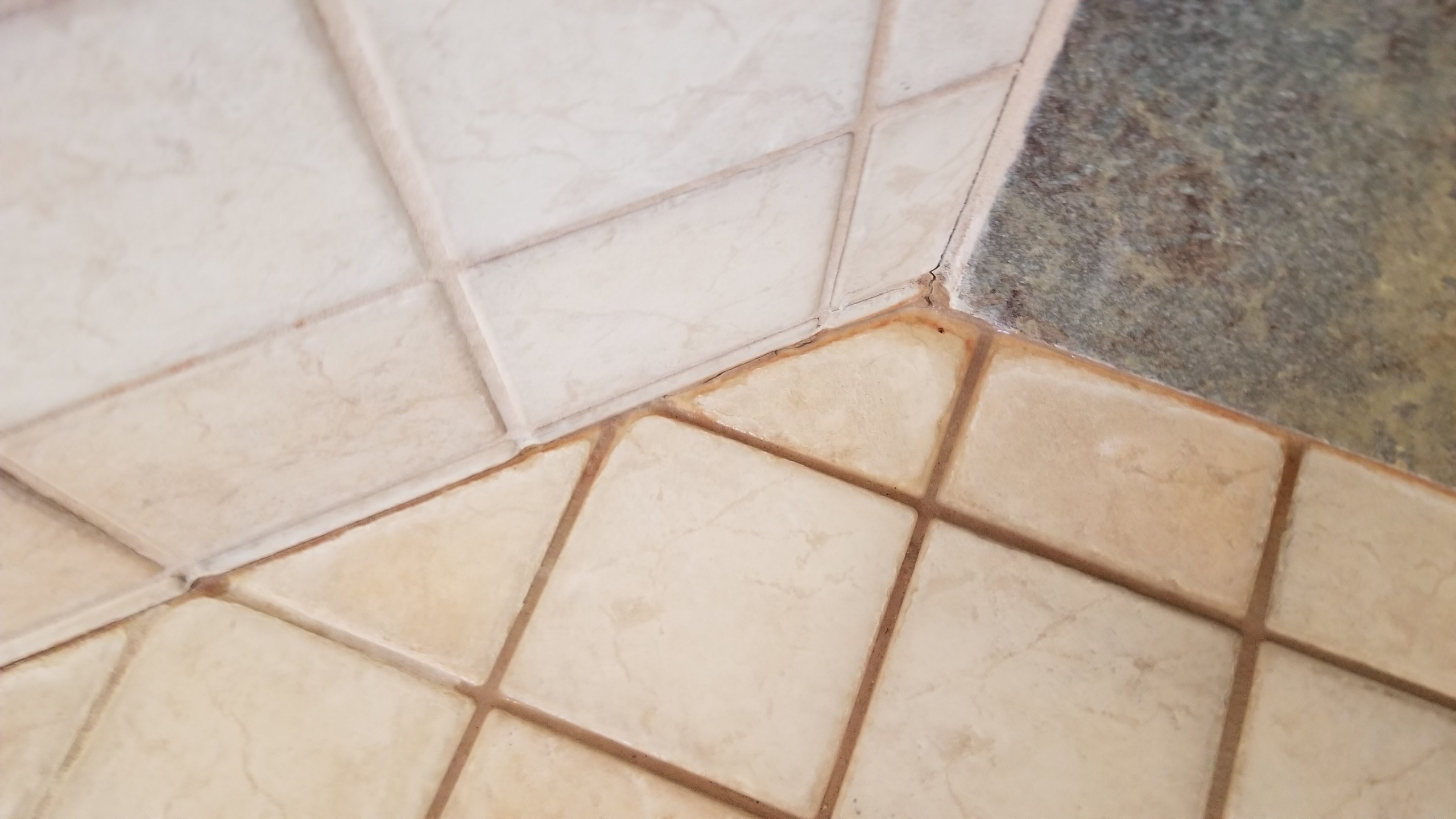

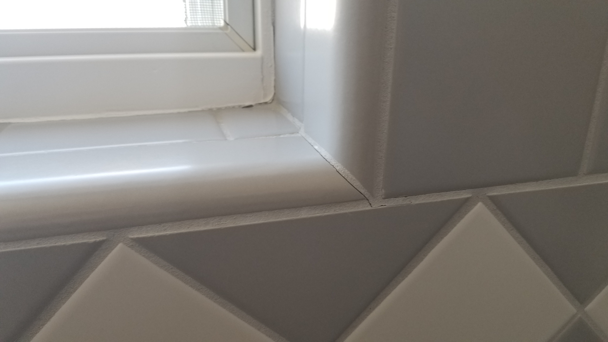

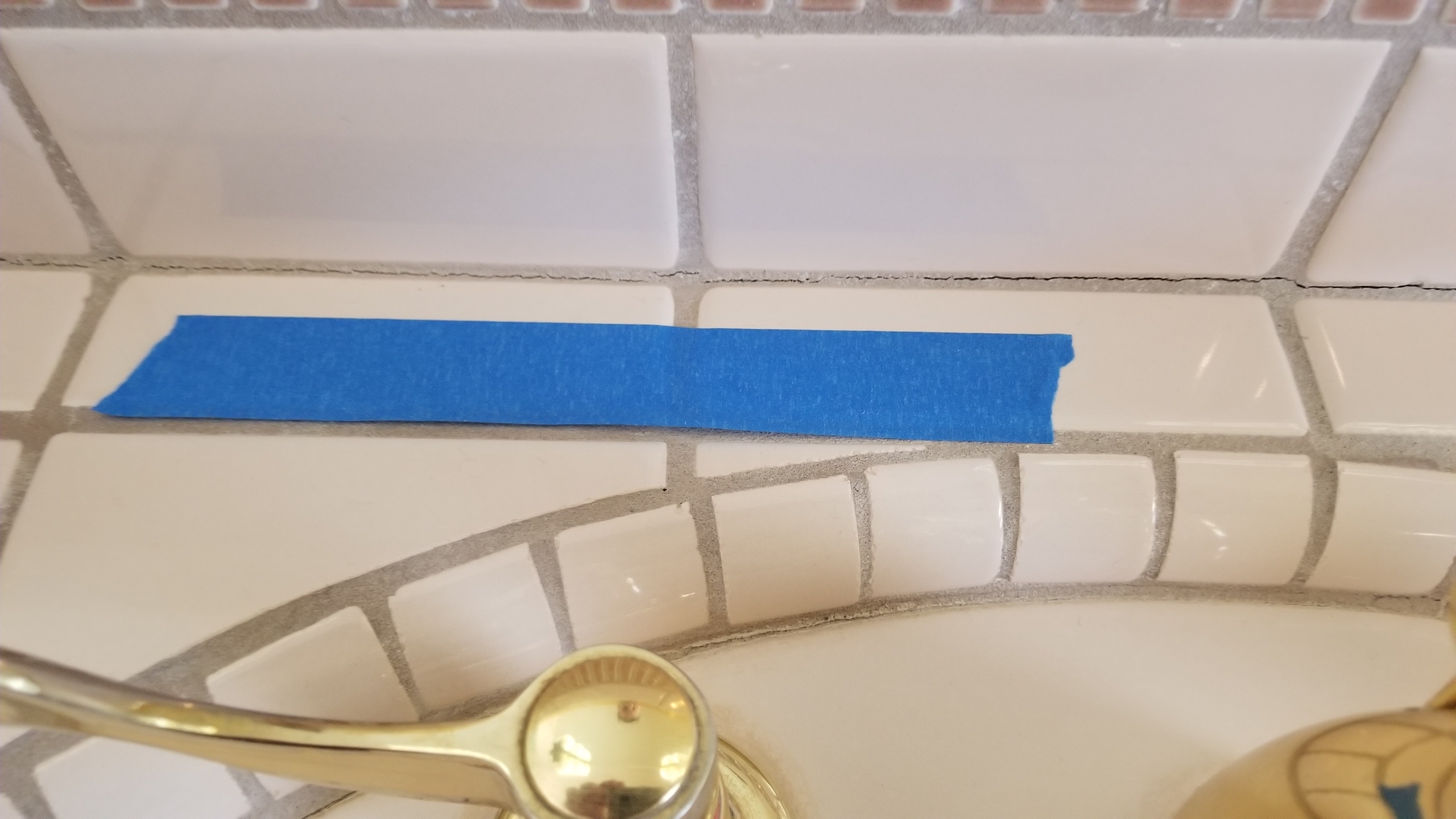

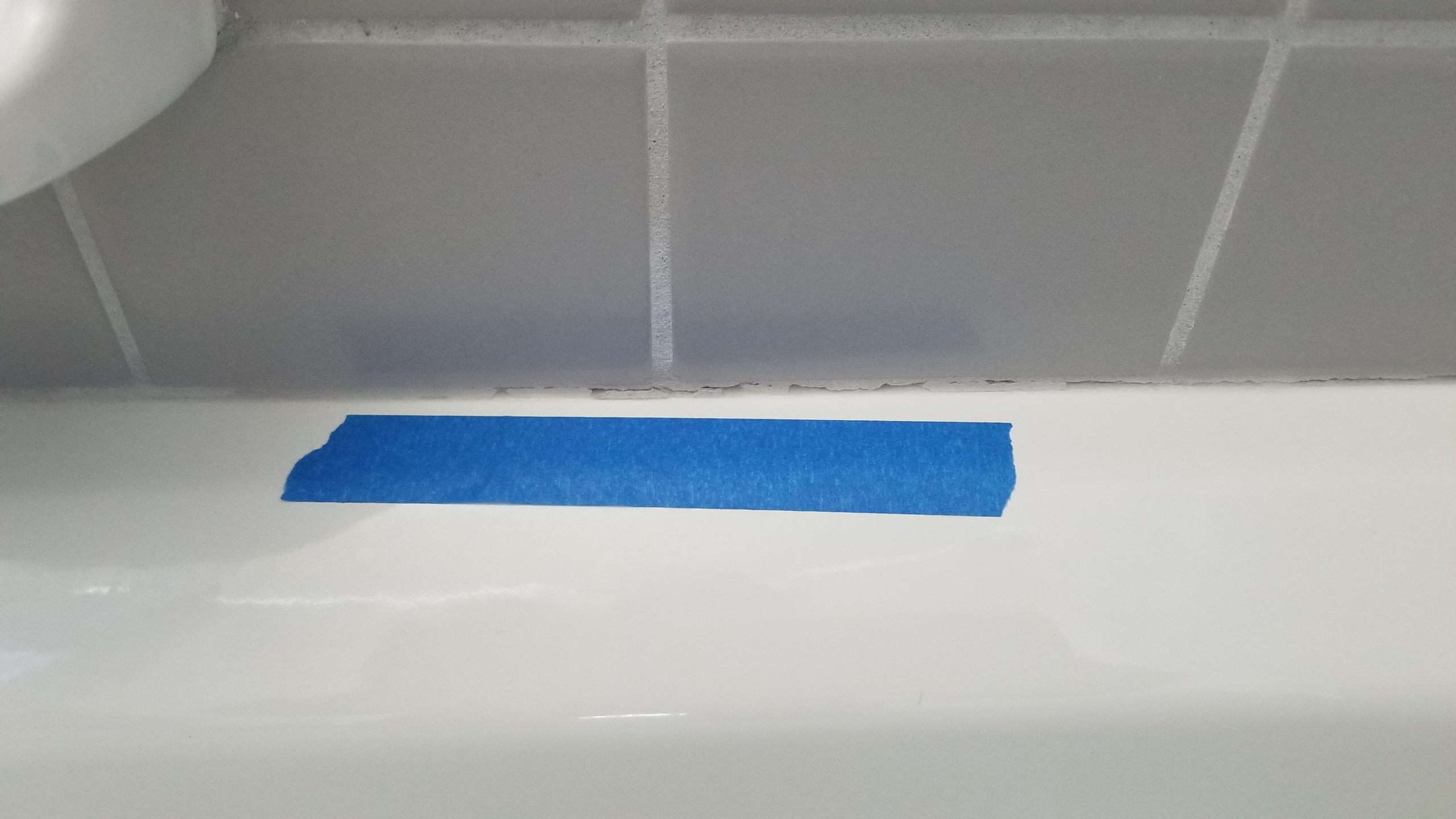

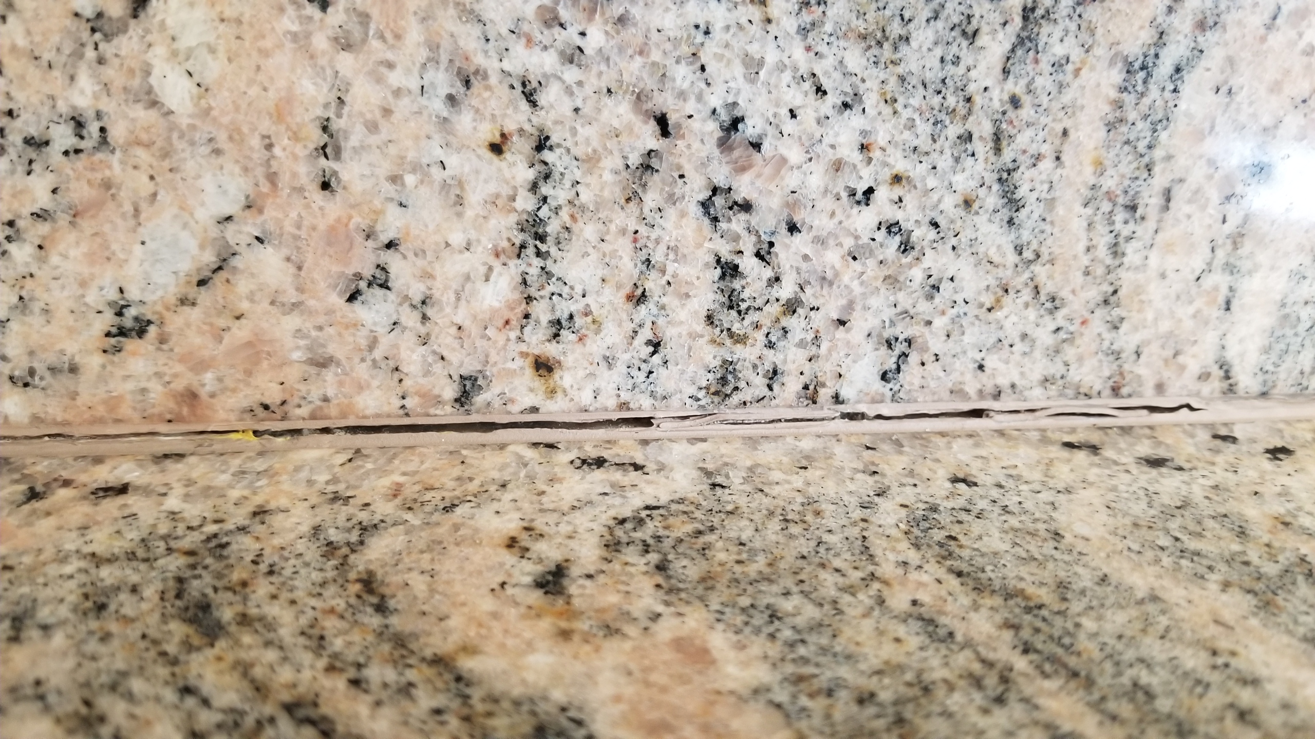

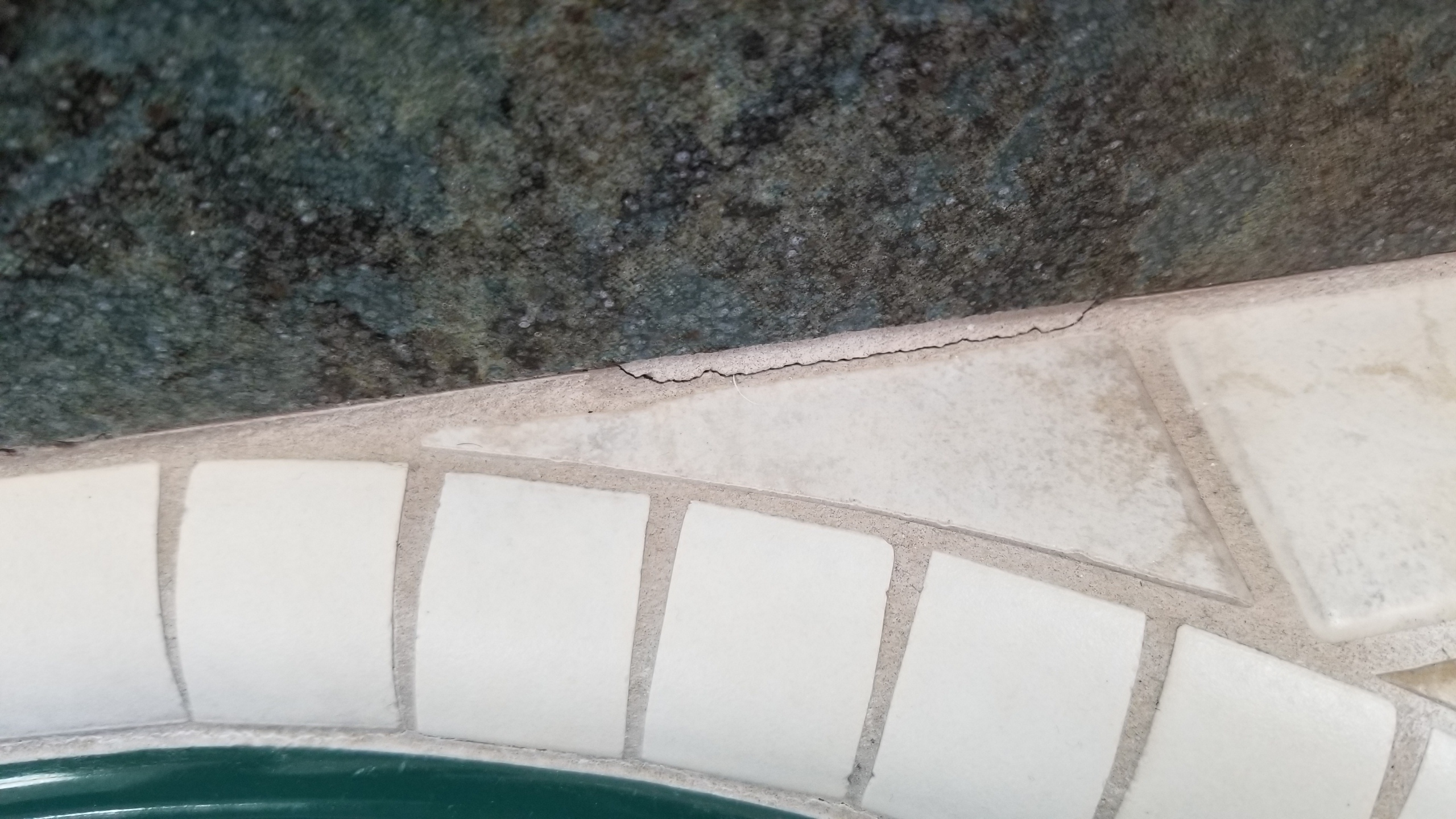

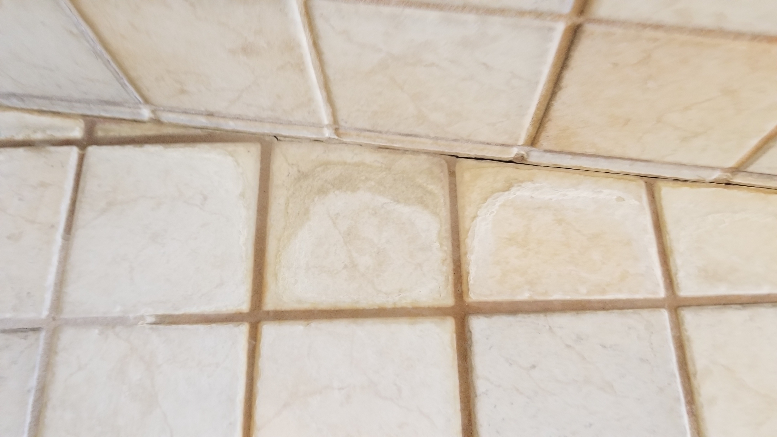

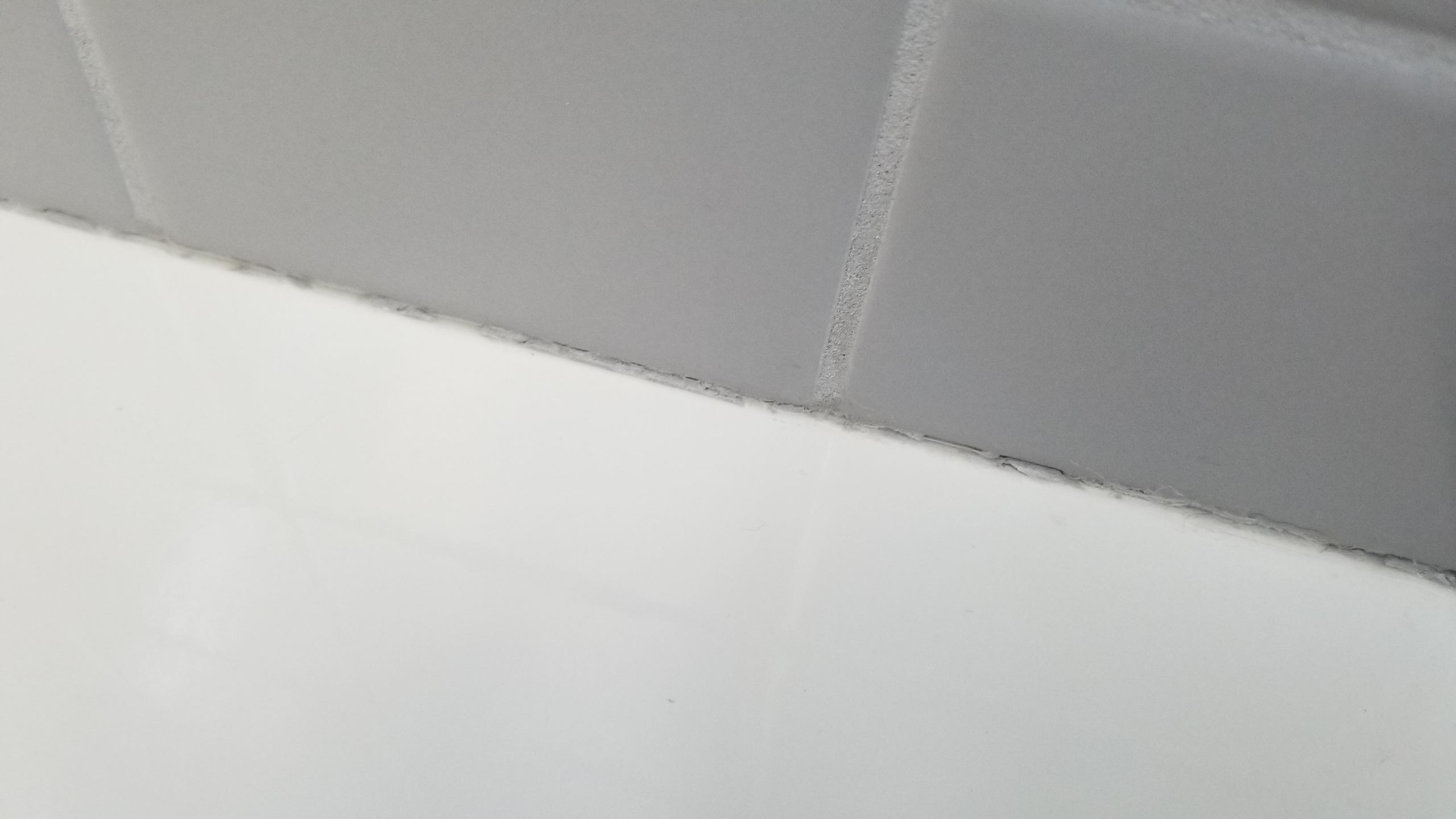

20 year old home that will sell for 900k. 5 acre horse property.

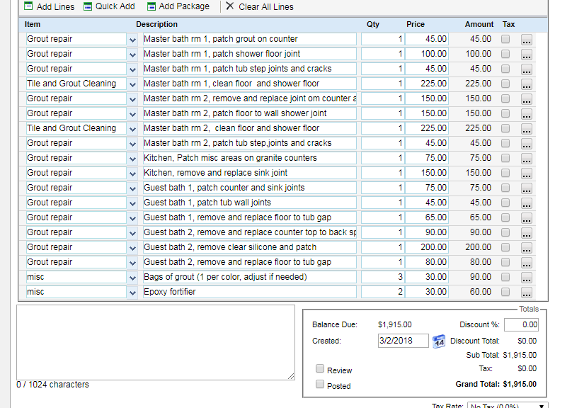

Working on tbe bid over breakfast on this grand day..

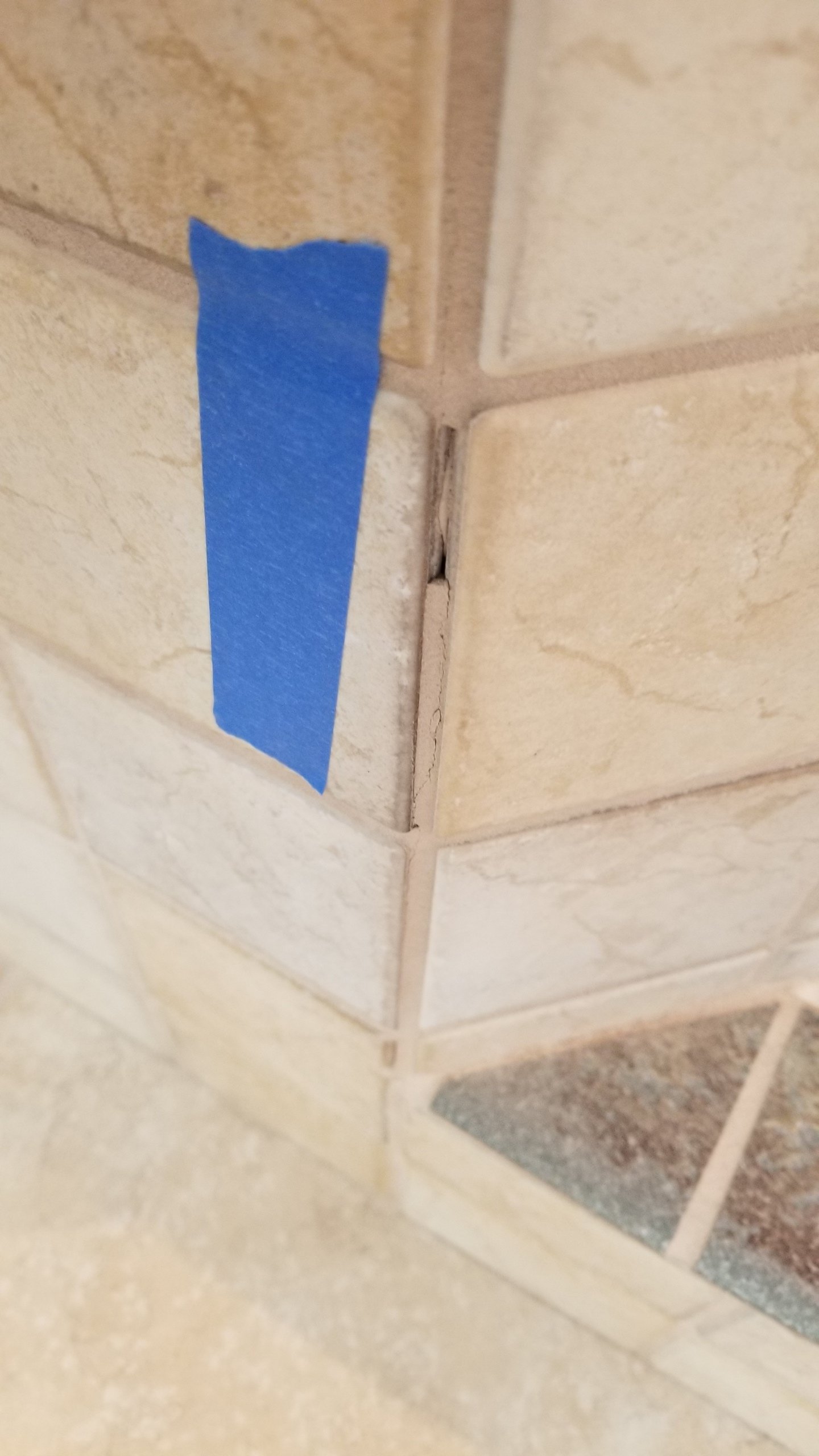

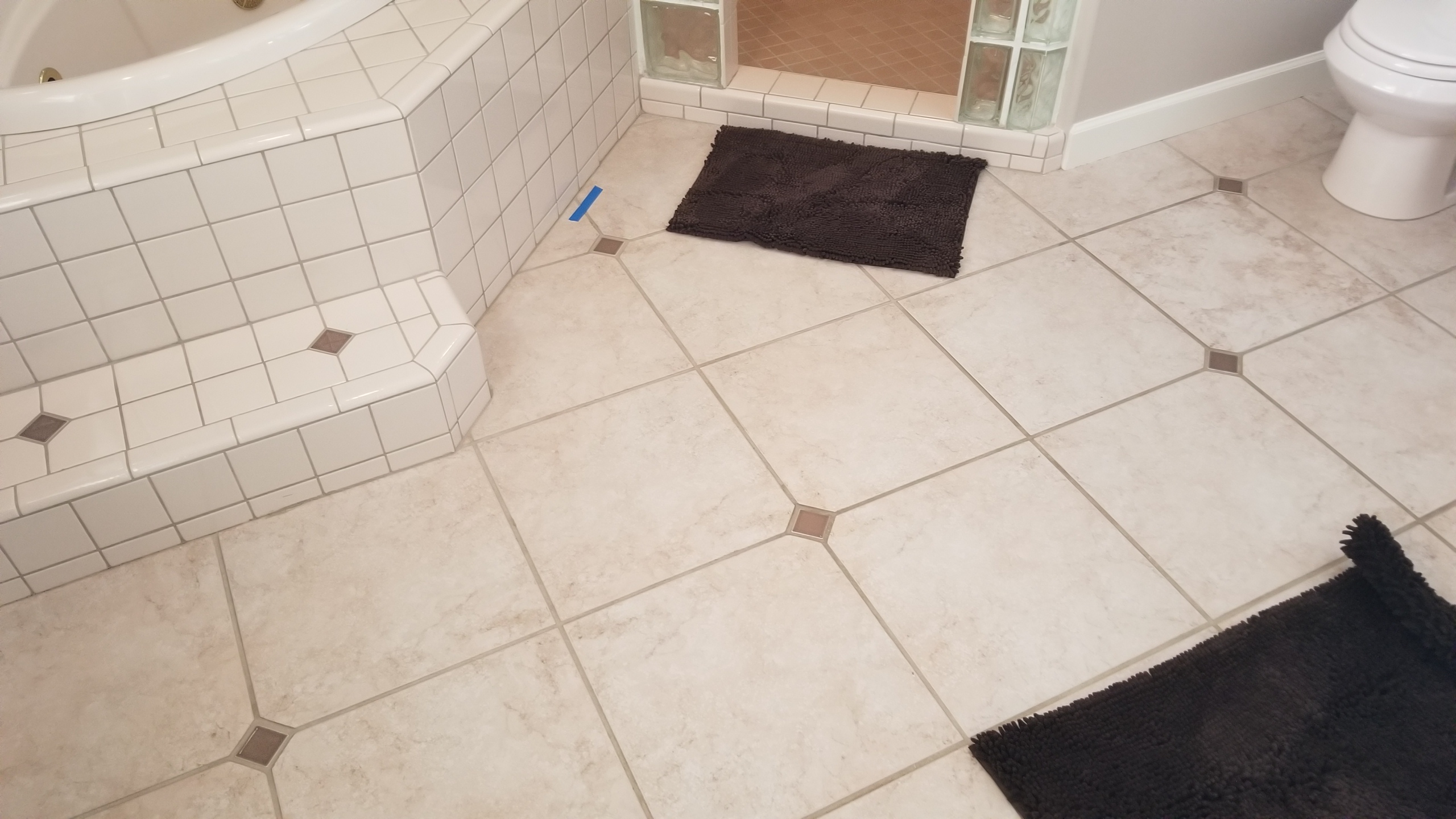

Jeez, that house go through an earth quake? Seems like a lot of shifting/settling going on.

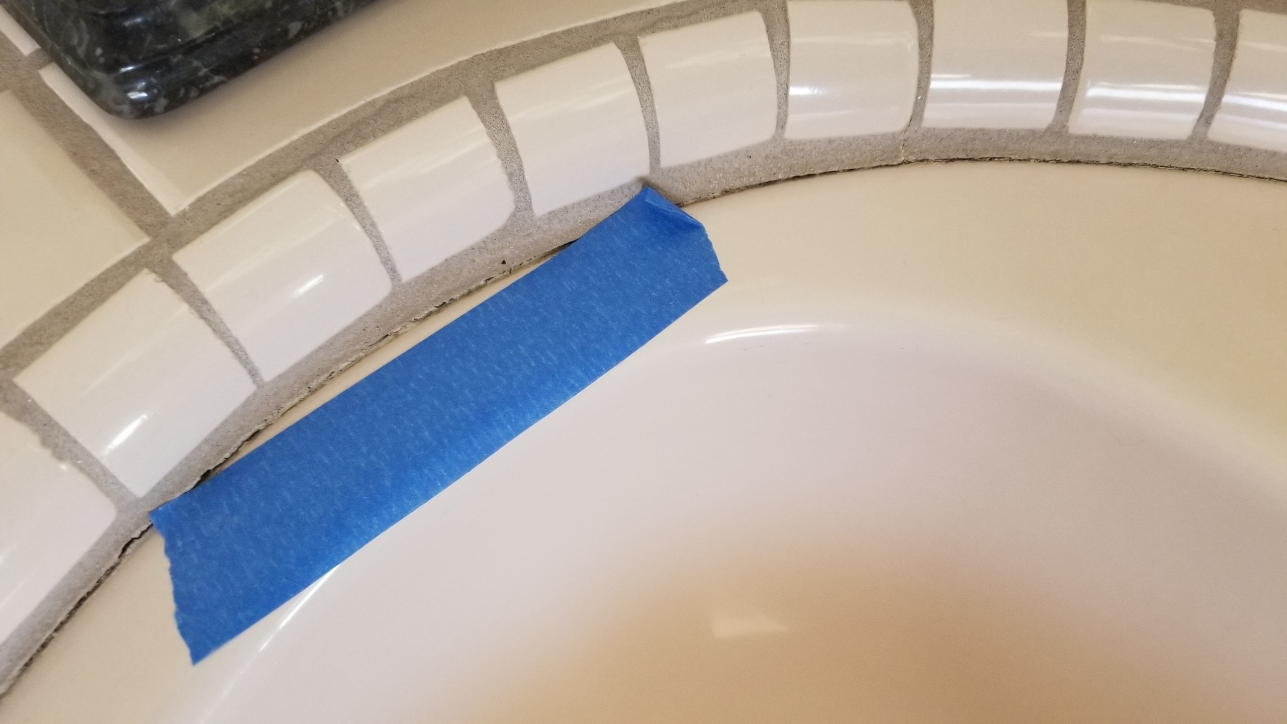

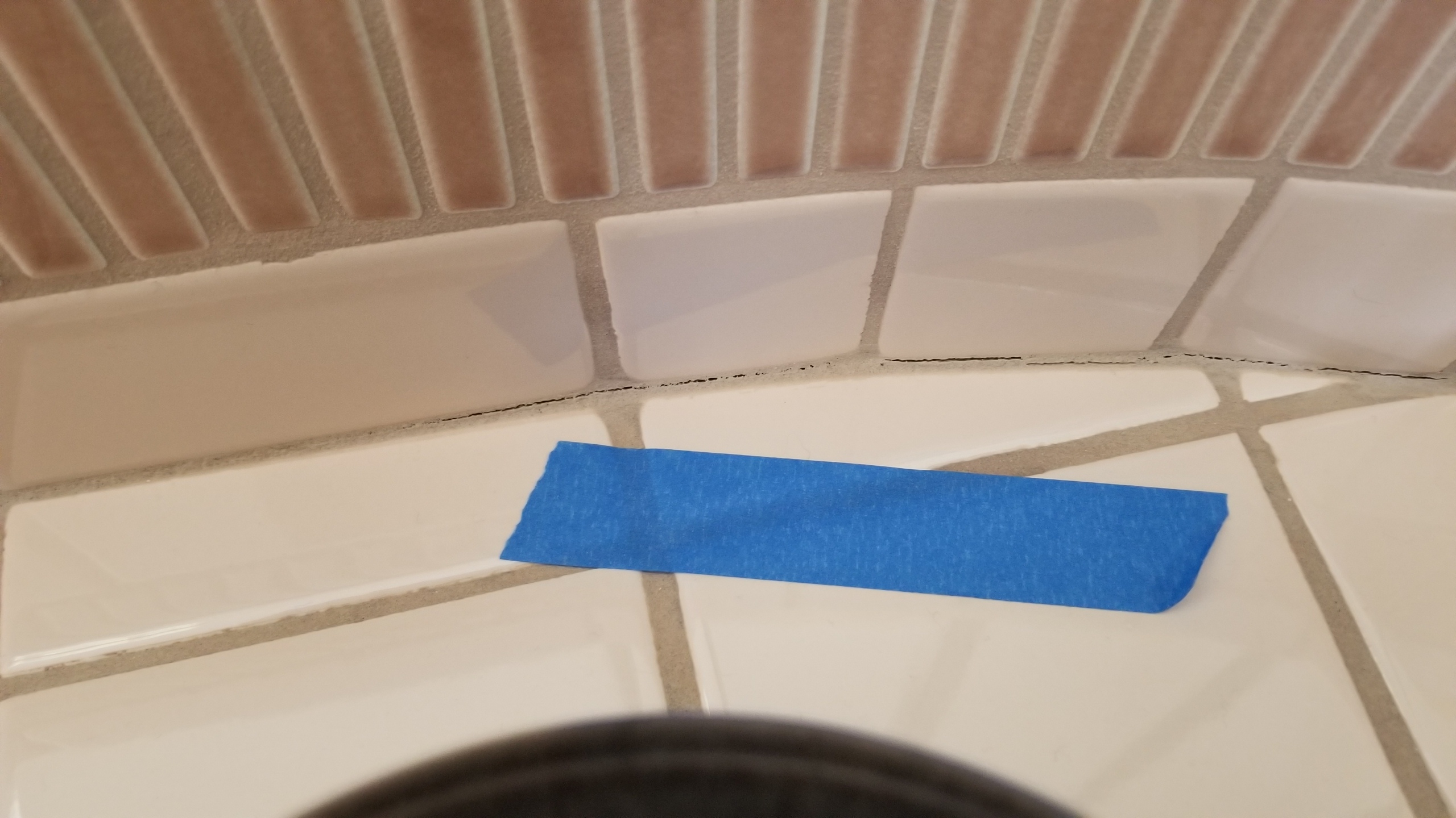

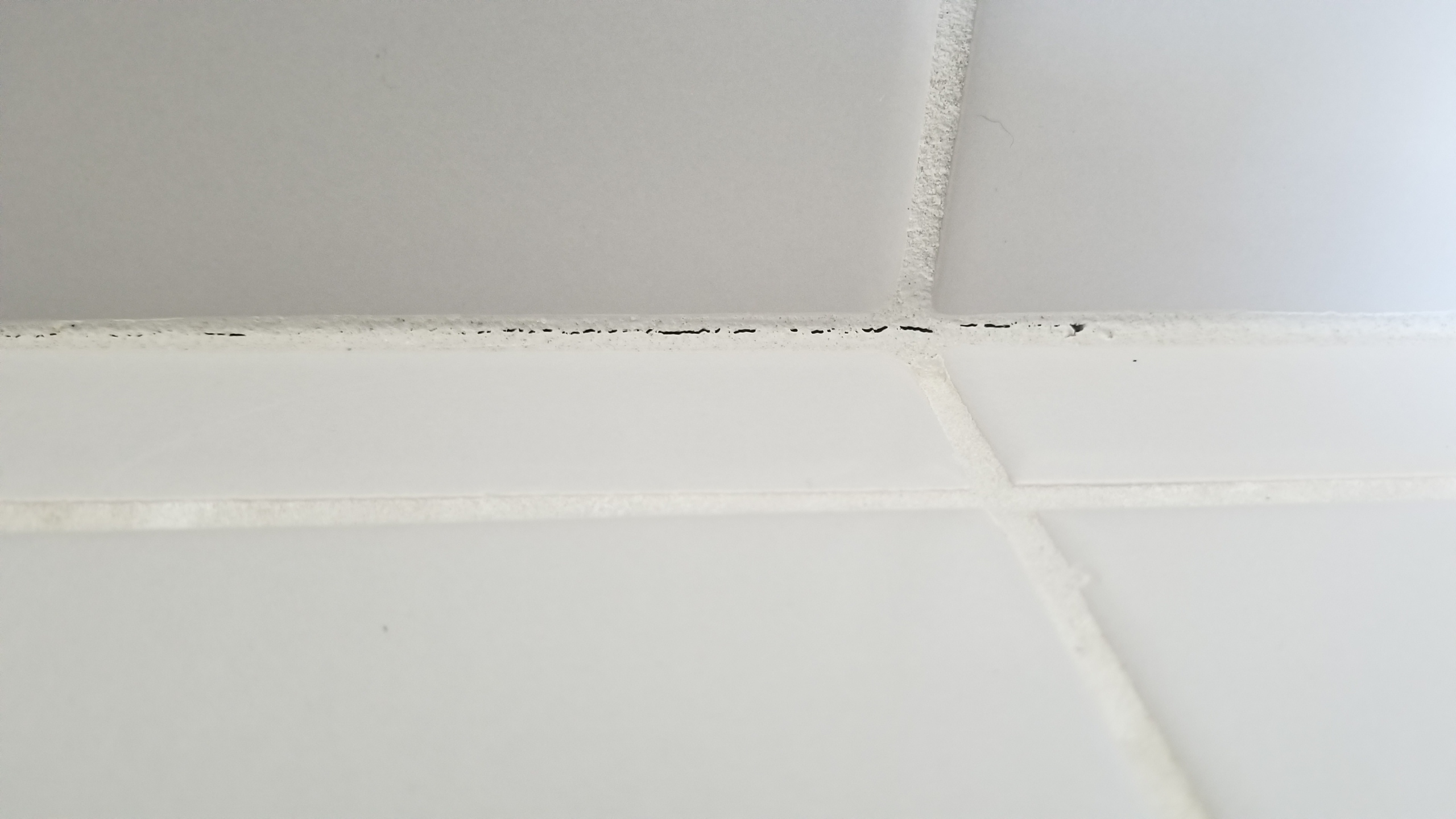

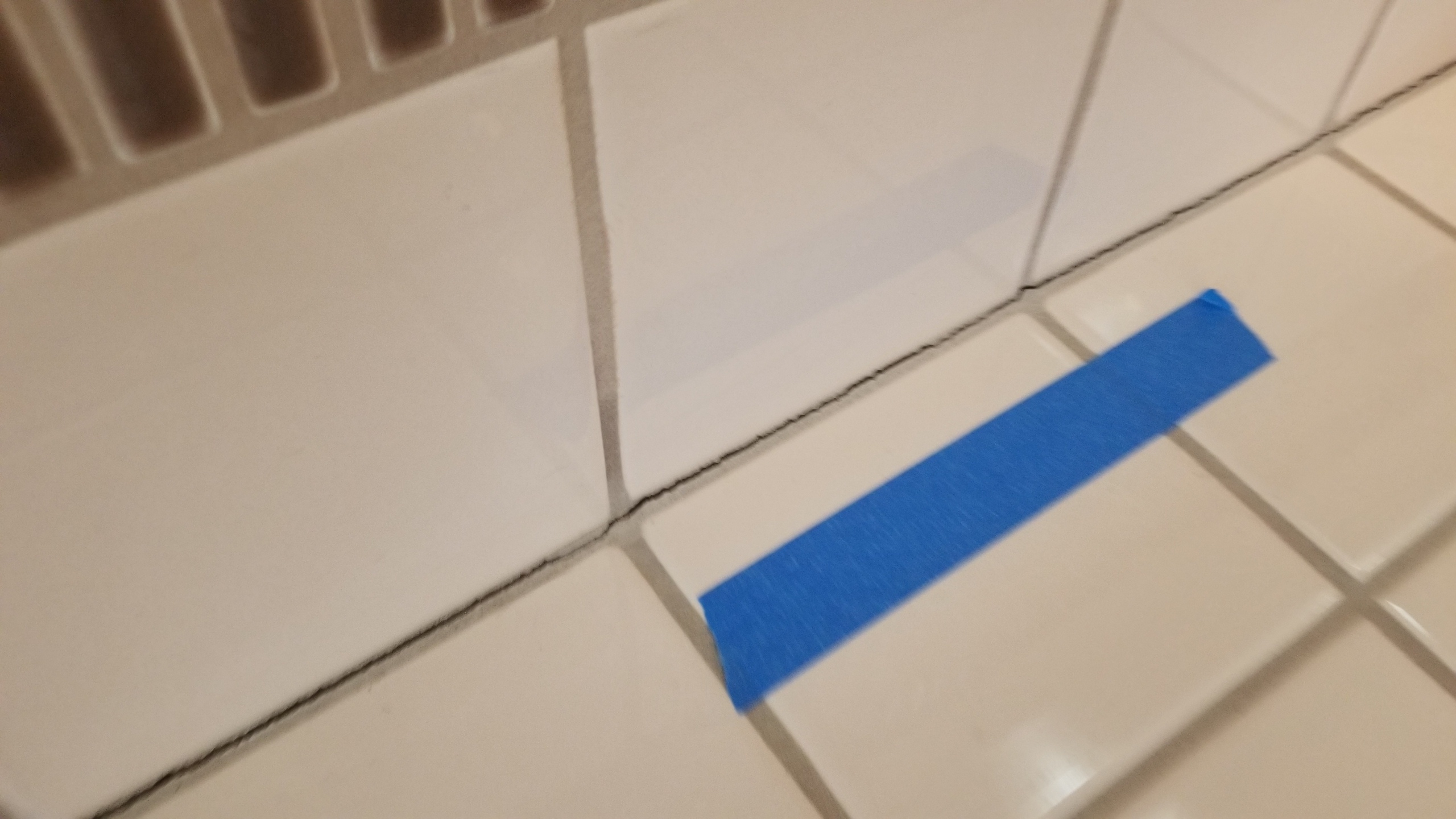

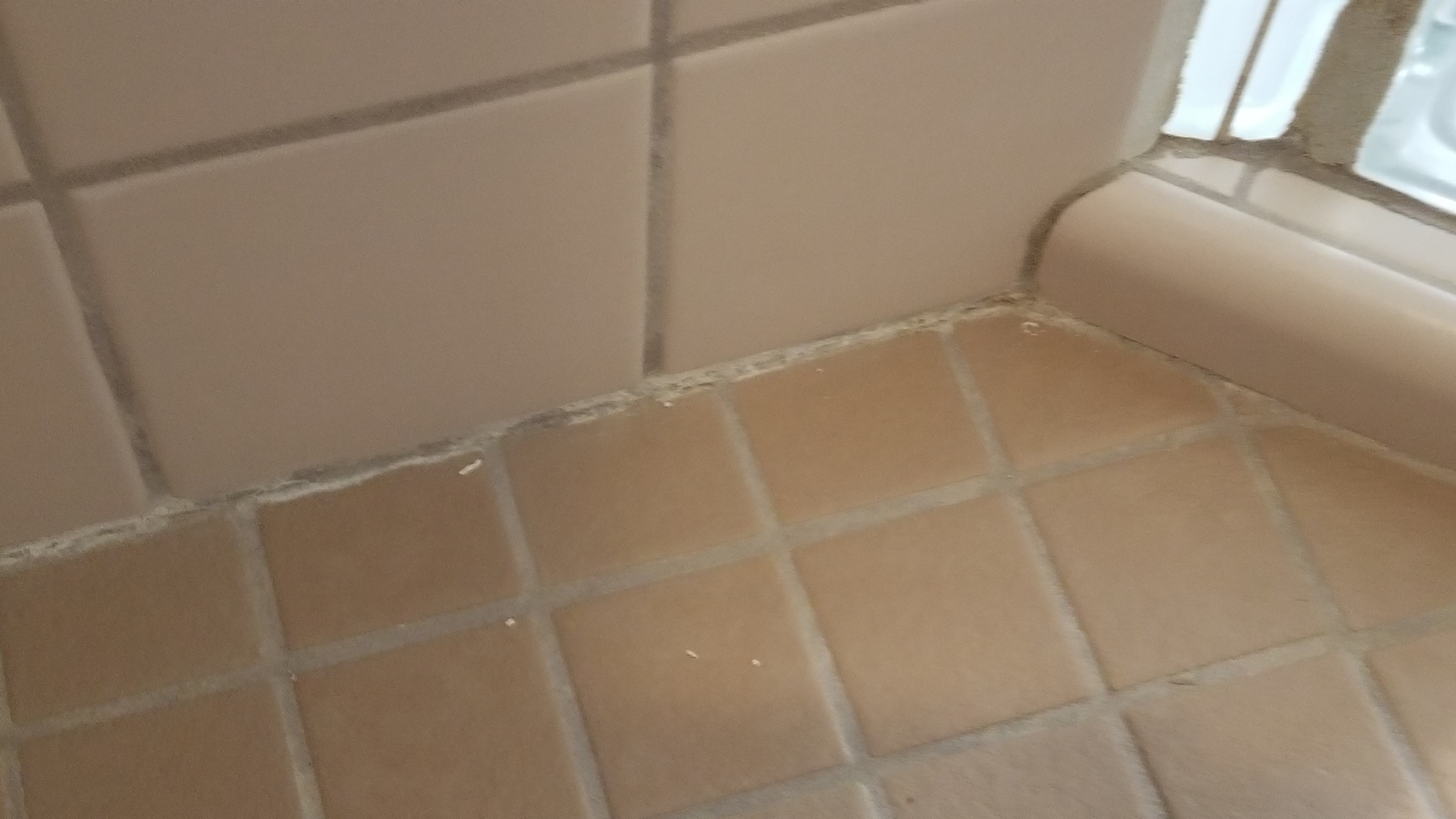

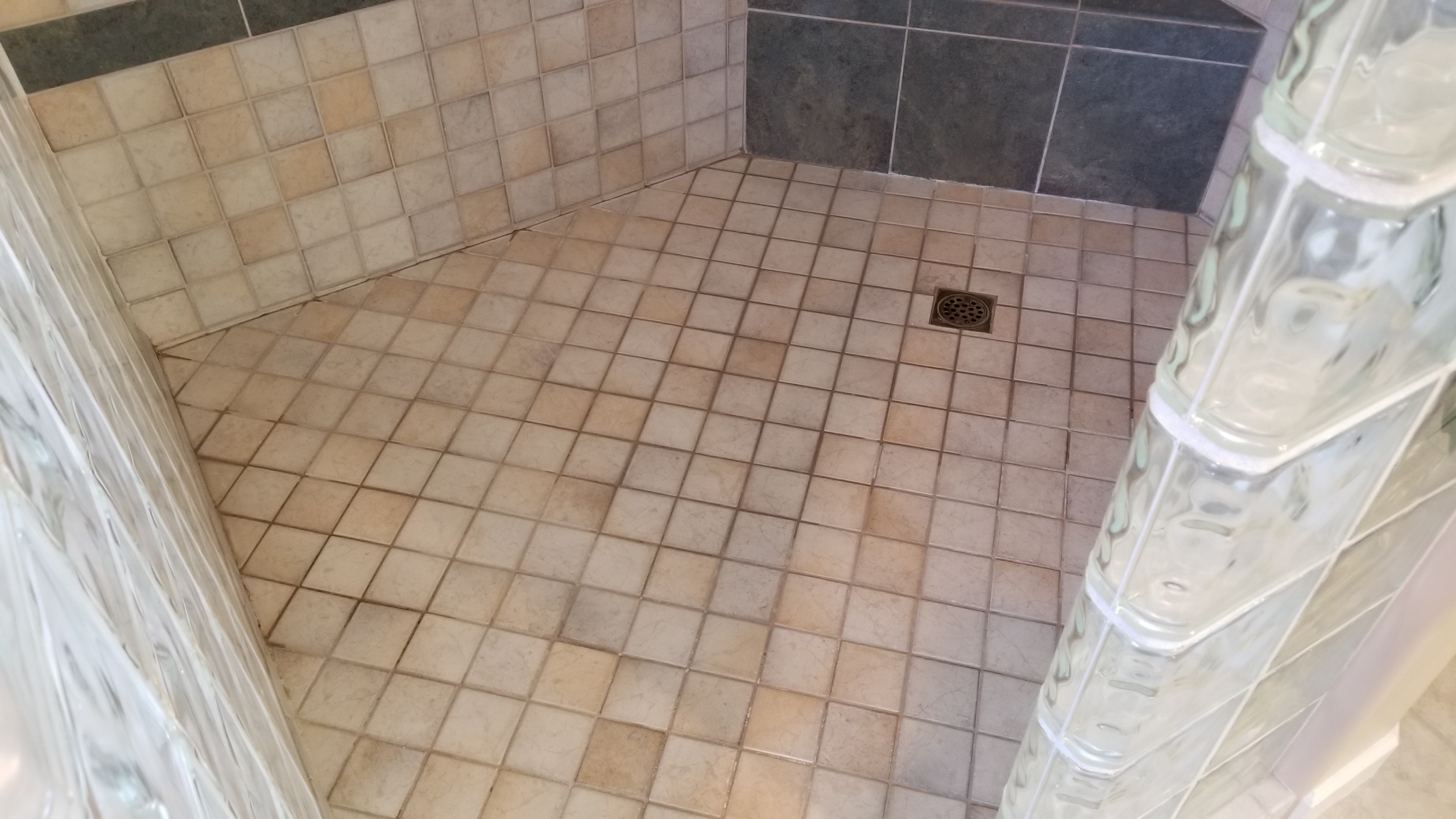

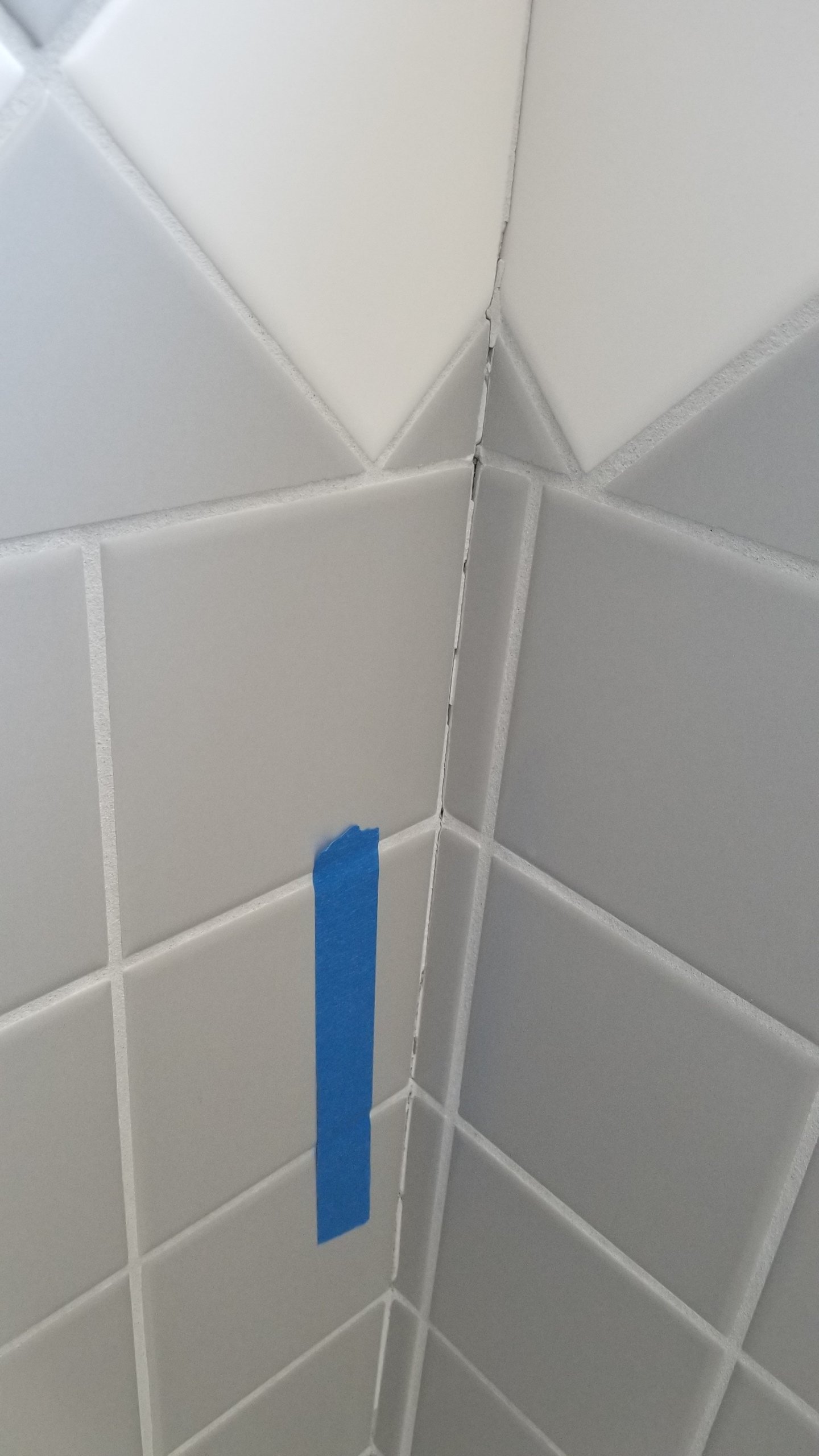

So how do you cut the bad grout out?
Do you have to color-seal the whole area of that particular tile in order to get a match on the grout, or just the area you repair?
Unsanded grout on walls and back-splashes?
115,924
So how do you cut the bad grout out?. Box knife, many areas were filled with this crap..
Do you have to color-seal the whole area of that particular tile in order to get a match on the grout, or just the area you repair? SGA fortified sanded grout
Unsanded grout on walls and back-splashes? Unsanded to fill hairlines (that I'll carefully open a bit, sanded on everything else.
I've used chisels when lots or all of the area need to come out, lightly tapping. There is a nice grout drill bit for a dremel tool that works well close to tiles. It's not super fast, but can work.
This kind of work I'm way tooooo slow at. I get all OCD in the head and will work way to long trying to get all the grout out when it might not be necessary.

every house east of 395 through town is built on sand....
Very common to see this and much worse.

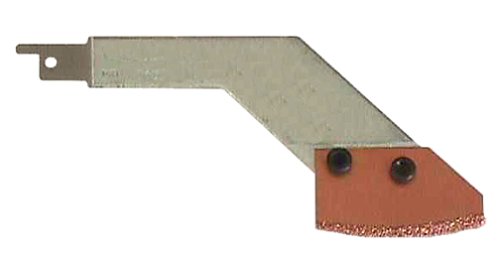

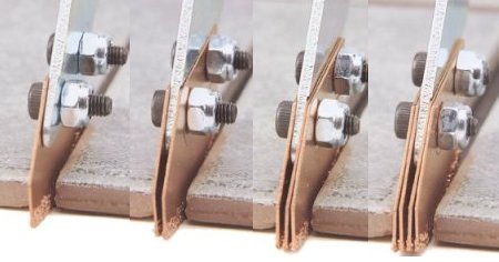

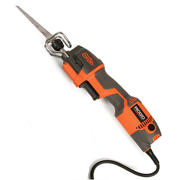

grout saw
need a short stroke sawzall with variable speed for best control
(like smaller Bosch, Millwaukie and Ridged )
otherwise, too easy to bugger up tile edges with large and long stroke saws
