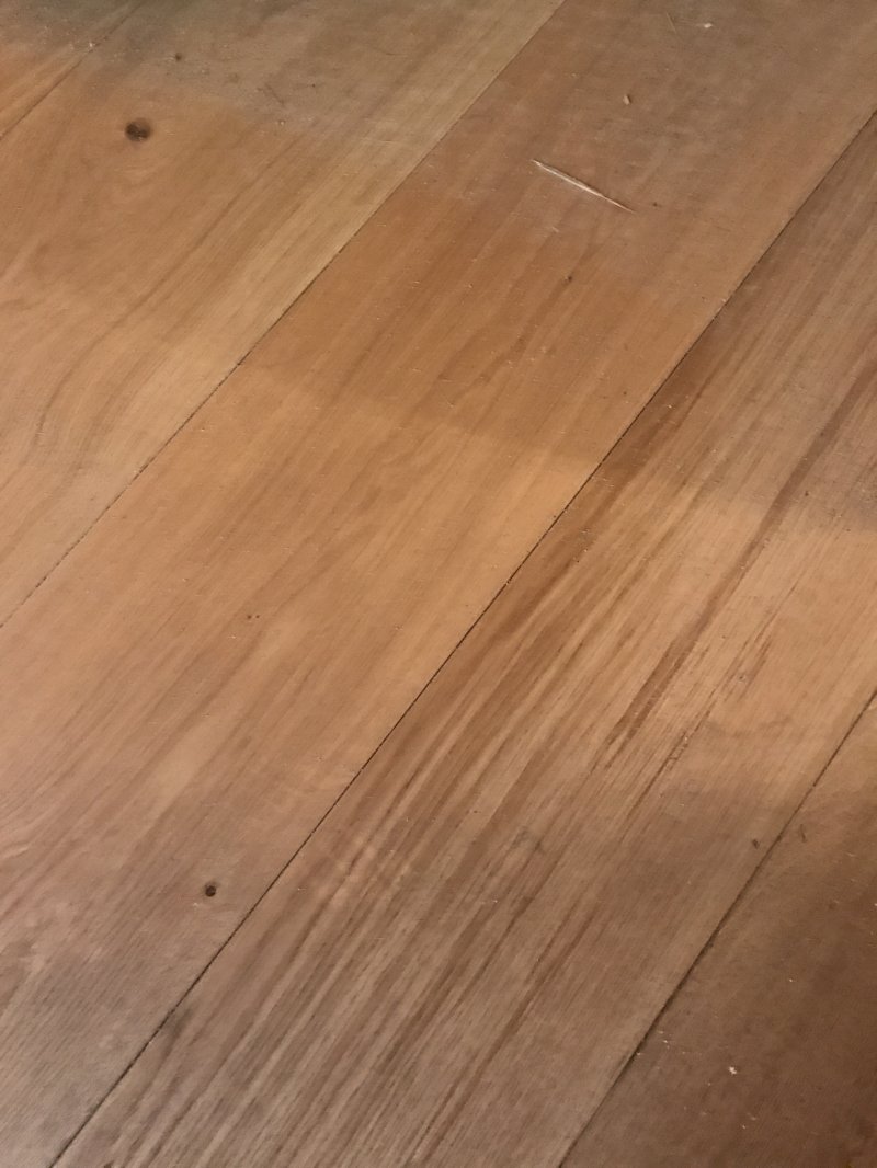

Seriously works.View attachment 75312
Maybe these new popular fake wood/tile/plastic floors could be just compound crb-d. I'm gona try a couple of those floors with the billions of tiny grooves...see what happens.
Makes me wonder though about the moisture in the compound.... What sort of residues might stay there. (if not rinsed or wiped quickly) Will the floor be very slippery if there will be some moisture like rain water on shoes?
I don't know... Maybe it's just the six hour drive home and sipping on the old scotch whiskey that's talking. Maybe tomorrow morning I'll feel differently about those floors.

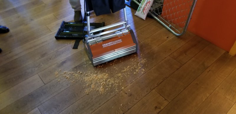

There wasn't any residue that could be felt by hand. There isn't anything that needs to be rinsed. The most difficult part is vacuuming up all the compound.

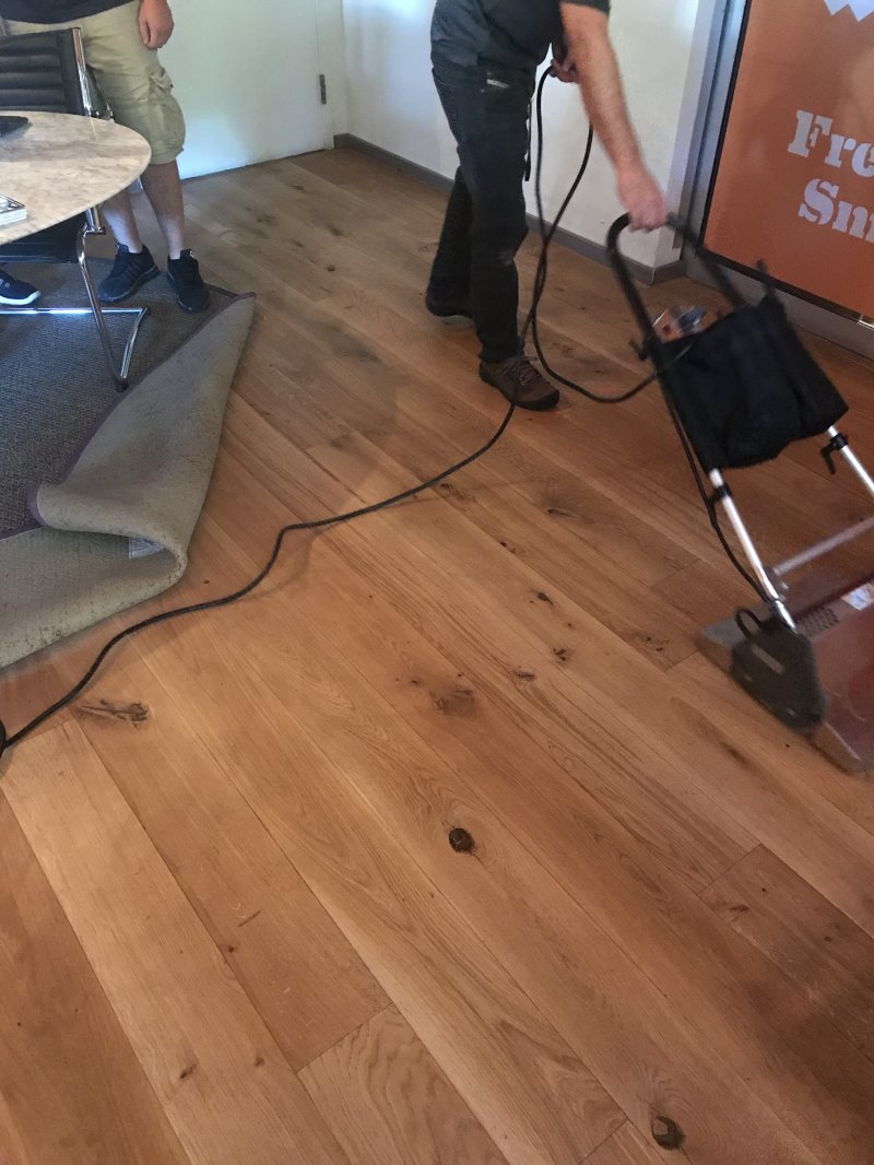

Friday I used Saiger’s Cide in my DP-420 to clean and freshen the oaken floors in an old house. The results were wonderful.
That is very low moisture; the floor dries in a minute.
When you used compound, did it remove dried spills and other gunk?

Suppose you could just mist on a neutral cleaner and crb it and then just use a micro fiber mop to clean it up. That host powder is expensive and has a solvent so I think it would leave a residue.
It seemed to remove the spills and gunk. The results were extremely impressive. You would have to try it out a few times to figure out the cost of cleaning per sqft. It might not be the most cost effective way of cleaning, but it did seem next to impossible to cause damage.

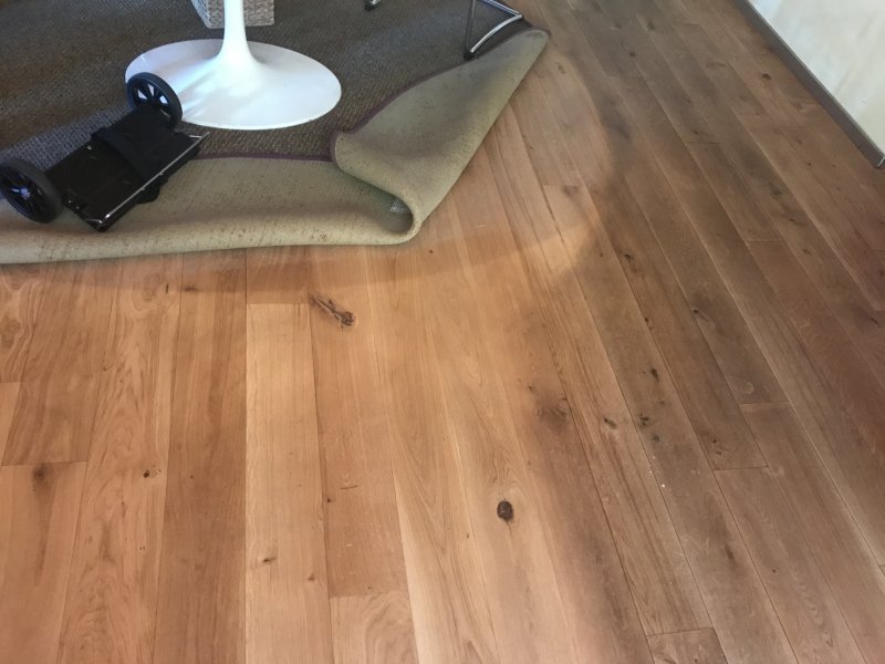

Was learning how incredibly well a CRB and compound works on wood floors.
Reg Roger's who performed the demo was even surprised.
Zero risk, think about it.
Pretty awesome...i love that stuff. It is what i have been using since the start of my carpet cleaning..

The magic of cleaning with a brush. The crb Brush really engages your prespray on the carpet with the dirt, makes sense it would engage a cleaner with the hard floor or wood floor also. Not having to worry about swirl marks on a hard surface helps too. It is easier mechanically to rotate like a 175, but it seems the rotary action of a crb has some significant advantages. If only they held up like a 175...
