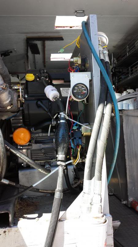

I posted pics of the outside of the new install.
Had a challenge with the new gas engine. Oil pump seized out of the box, took them almost a month to get it replaced.
6mth project. But here she is. Have a few things to do yet but doing the first job with her this morning.
Not the prettiest but its functional and everything is secure.

Wish I had the propane still. Its a lot easier to control and gave me all the heat I needed.
Have to learn the operation of this exhaust hx. I buried the temp needle!!
Those guys claiming 280 at the truck are full of it. I was blasting steam! Bit of a learning curve.

Yes, Don built the hx
The truck is a 95 Ford cube van, 14ft box. 11000gvw. Has the 7.3L Ford Powerstroke diesel. Almost out accelerates my car even with a load.
Definitely don't need anything more than a 4.7 blower. I think I broke a weld! and I only running at 3000rpm. Still have 600rpm in reserve.

The complete HX kit was about 3500. That incl the dual HX, the diverter and cable, exhaust wrap, hose and muffler clamps, flex tubing, dema and needle valve, murphy switch, pretty much everything I needed. The only extra piece I bought was a pressure relief valve, $60CDN.
Don't know about what gvw you'd need for yours but this is basically the same truck as my original but 8yrs newer and A LOT better condition. I put air bags on it as well for a better ride with the weight.
