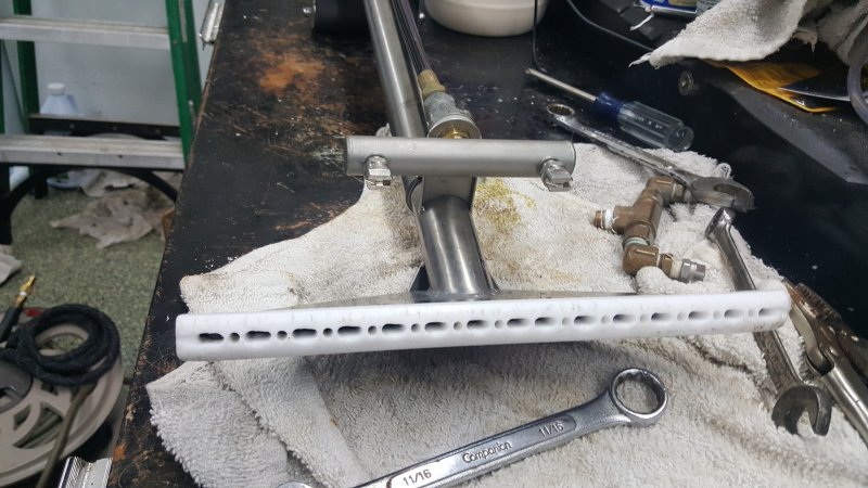

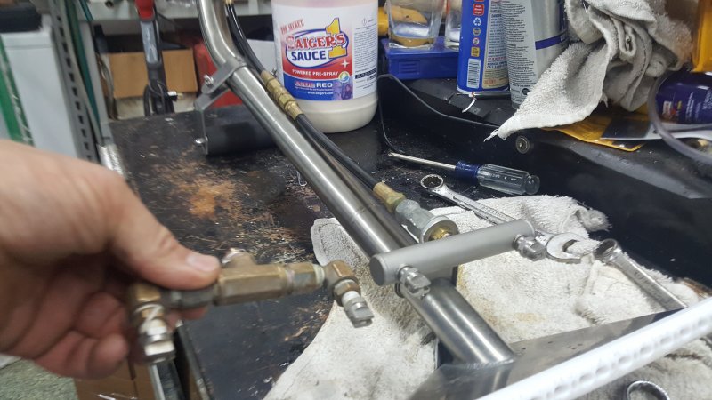

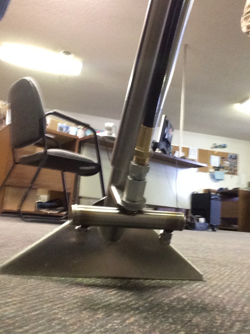

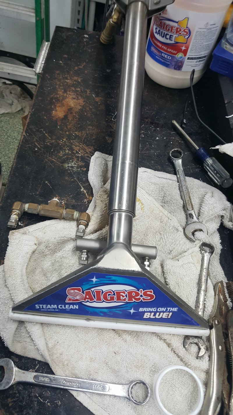

I have been doing this to these wands for about 15 years now....and I like them...much nicer to clean stairs with and good flow....and I don't feel like I have been beat to death cleaning stairs!
Here is some of the info on the new Dual manifold made up now by PMF....
We have been using them now and really slick....
We have a Greenglide Hybrid on them right now
Part number that will fit any PMF single jet stair wand
THIS IS THE COMPLETE DUAL JET MANIFOLD WITH JETS AND HOOK UP
AC52-RTA
If you want the entire Swivel Head stair tool with Dual jets installed...here you go...
S1540SV - ST 30" SWVL-OPEN SPV2EZ with AC52-RTA

1.5 inch tube....but I hear they can put a flare on it if you wanted.
The V shape of the head actually does give it pretty good suction and lift. The 2 inch tube it has been felt would just make it heavy and not get much more performance out of it.
I tried a 2 inch to 1.5 inch reducer on mine a few times, and ended up going back to a 1.5 inch whip...this is the only tool I use with a whip really...
The loose swivel is nice on this tool...but wouldn't want it on any other wand I was cleaning with....easy flipping for the underside of the steps and back and forth....

Slot glide would be soooo much better. Bugs the heck out of me the little holes constantly getting clogged.
The new piece certainly is nice!

Am I the only one who noticed the red saiger sauce strategically positioned in the picture? Mark's doing the type of advertising that's hidden. What's that term?

Glides on a stair tool are not the best way to go in my humble opinion. It makes it harder to get the 90° area where the horizontal stair surface and the riser meet.
The PMF tool works much better with the glide because of where the jets hit. Alignment doesn't work without it. I am surprised that PMF STILL doesn't have their glide done for the tool.

Actually it was there for a local cleaner to pick up...I was in a hurry the other day just getting off the truck to put this together and last minute decide to shoot this video...and didn't clean up any of the junk on the floor or bench....but now that you mention it....it was in a good place I guess for gorilla marketing :)
And that cleaner hasn't still come and got it from my shop....:dejection:
