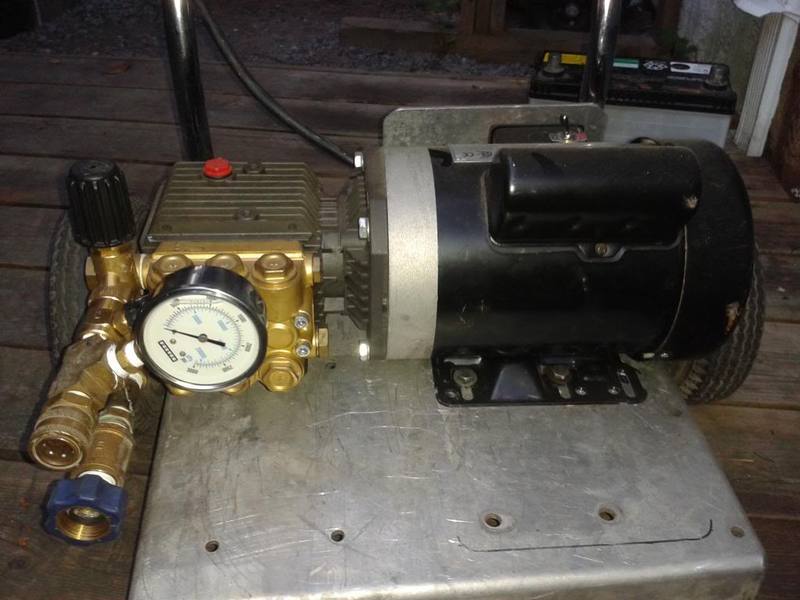

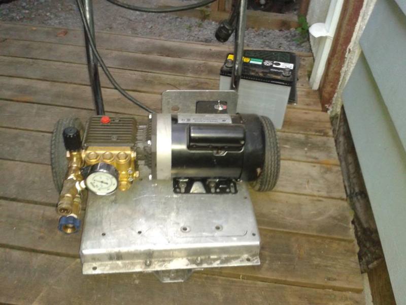

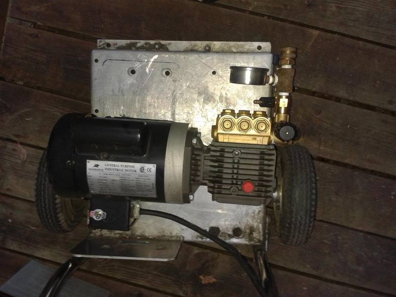

Gonna build a super "modular" porty.(The Redneck Rocket) Here's the pump on a cart. It's going in for some sheet metal work to case it in. Can't beat a General. Coming soon is the dual/quad vac recovery unit. I'm looking for some high volume 2 stages that can run 2 on a 15 amp cicuit. Suggestions Gurus?
