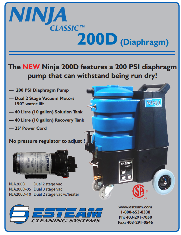

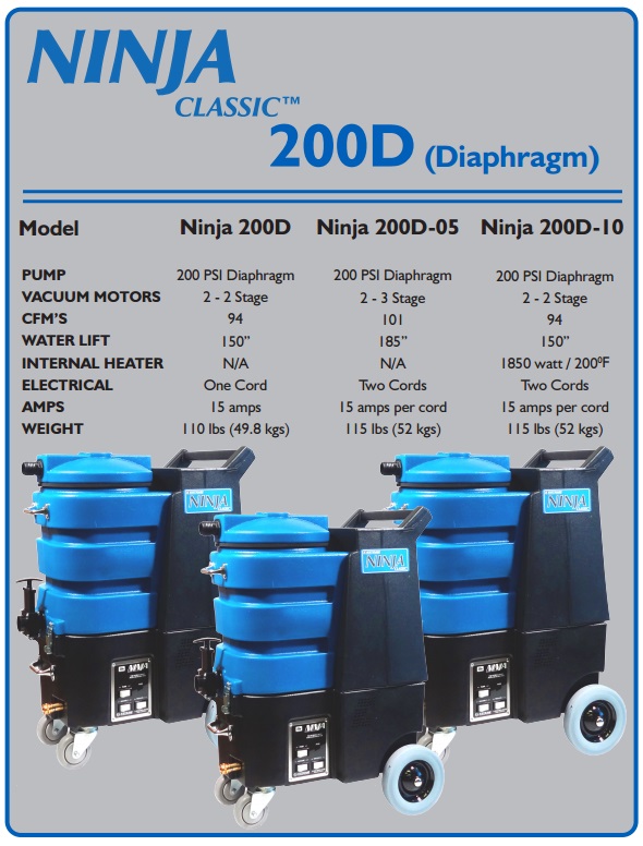

Esteam NINJA CLASSIC 200D
The NEW Ninja 200D features a 200 PSI diaphragm pump that can withstand being run dry for short periods of time. As with all Ninja Classic extractors, the Ninja 200D comes equipped with high quality components such as two or three stage vacuum motors and 1850 watt internal heaters just to name a few. All Ninja Classics are CSA/UL certified for assurance of quality and safety.

Friend has one..........POS. Hate portables.......but a walk behind has value!

That must be their latest model. I've never seen that tank design before...
except pictures from the 1970's....
I wonder how many thousands of that body they have sold through time---I'm sure it is a lot of them.

They were maroon once too. The problem with a standard portable or one with heat is that the 2-2stage vacuums just don't have enough vacuum power. I have had many and still have one today which I use for hard floor cleaning with a 1000psi pump. Take the damn heater out and go with 2-3stage vacuum motors and now you have some suction. If you need a heater, hook up a 3rd power cord. The problem with the ninja's is that they are only 1 1/2 inch plumbing. I would prefer a Mytee, even in the basic model as they use 2 inch plumbing. I have a NSS Rustler 17 gallon machine that I have put a 220 psi diaphram pump into. It gives me 160 psi on a 4 flow wand. You will only get 200 psi on a 2 flow or less. 160 doesn't sound like much but with a little heat it does clean well.
