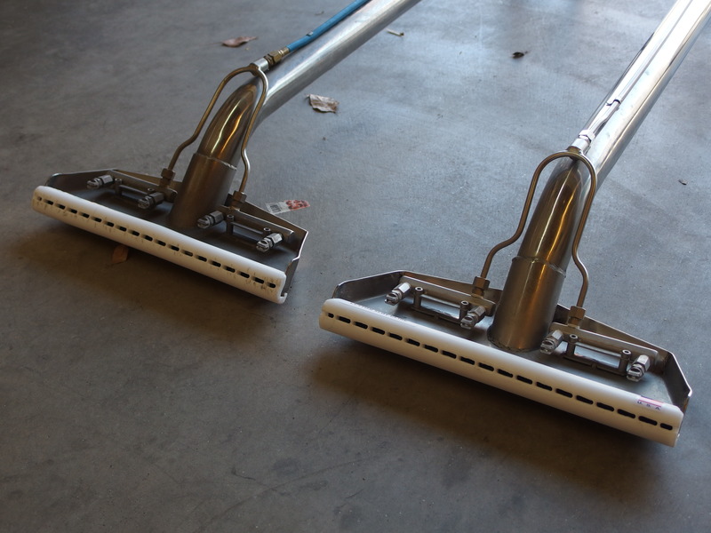

The vast majority of my jobs are hose runs of 150 or less.
I'm using a 2 inch, 6 jet, 14.5 glided SS wand.
4.5 blower.
In smaller occupied residential, trailers it is a real PITA to move all that 2 inch hose around and large wand.
If I use a 1.5 inch lead hose with a 1.5 inch wand, will it really hurt dry times or cleaning too bad at 150 or less run?
If I do go 1.5 inch, just go with 12 inch?
Not going to get rid of my other wand, just use the 1.5 inch as needed.
Thanks, Ross

Use 2.5" hose for a little bit, then you'll think 2" hose is a joke.... I personally wouldn't do it, but test it out for yourself and see if your dry times are acceptable.... If some customers complain, then you got your answer....

We do use 2 inch wand for residential however we use a 15ft 1.5 whip and wand for commercial quite a bit with no dry strokes and have carpet dry to the touch in under 8 hours. We also have a 59 blower which may make a considerable difference. Instead of focusing on wands and hoses for drying I put more emphasis on having fans and air on with the temp properly set. I bet you are right about the smaller 12 inch wand helping.

Ross;
Great comments above.
Using a 1 1/2" whip will definitely cut down on recovered solution/debris.
Using a 1 1/2" (wand) barrel would be negligible however easier to control and use.

I use both and have no problem with dry times even with a long hose run. I agree with the "Tight Spaces" comment. Much easier to work with a 1.5" wand. I would use my 2" wand more, but with the glide, it doesn't get right up to the wall.

get the westpac 2 inch wand with 4 jets..with a short slot glide..you will be further ahead.......
I understand about the hose..I went to a bit softer hose so it relaxes more and a lot of the fight went away........
