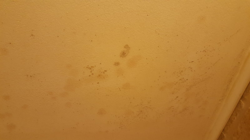

This has gotta be mold? Right?
jcooper
3,232
Jerry Cooper

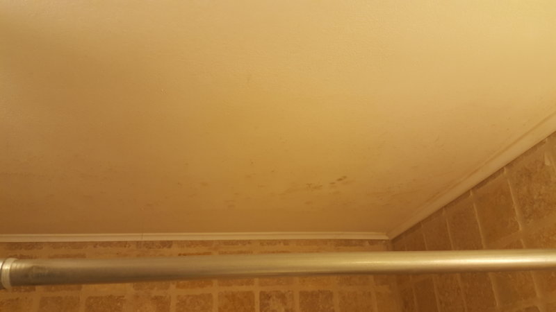

If this is mold what can I do?
How would it be fixed? Does the drywall need to come down(please say no)? Can it be cleaned and repainted?
It's in a bathroom at home. My plumber recommend not leaving the shower curtain closed after a shower. Guess we should have known this...
28,277
you need to rip the ceiling down, smash the wall of the shower stall and pull out......Just kidding! It looks small enough to be cleaned. You want to physically wash the mold off with a mild detergent. Might have to seal and repaint with bathroom appropriate products. Determine why the mold is appearing. Usually lack of ventilation. Check to see if the exhaust fan is working, make sure it is actually exhausting moist air to the outside. If there is no exhaust fan, when showering, open the window for ventilation (and peeping toms) and when done, leave the bathroom door open as well. You always need good airflow to get rid of the moisture. A good way to tell if the ventilation is working, when getting out of a hot shower, the bathroom mirrors should not be heavily fogged and should clear rapidly.

Thanks fellas the advice is appreciated.
It's a small bath, half the room is tub. It's got a fan, guess it would be a good idea to keep the door open(at least when the wife's in there;)).

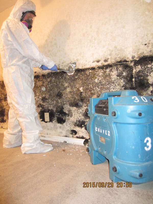

You want to physically remove mold not try to kill it. When you try to kill it and fail to kill it 100 percent, it fights back creating toxins that can be worse than the mold it self. Just wash it off, let it dry, seal with primer such as kilz and paint. Make sure you address the cause.(lack of ventilation) leave the fungicides alone.
If you can kill it, a dead mold spore can still be toxigenic and allergenic. Removal is always the best answer with heavy growth.
Structural members you can sand or use products like Syrum 1000.
