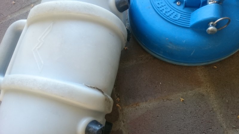

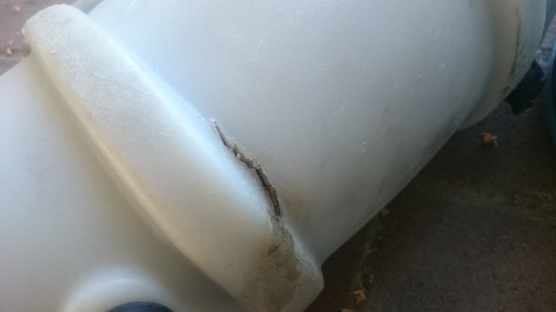

This is what happens...
Zee
Nov 2, 2007
6,162
SoCal jungle
...when you have enough heat and suction going through your pos inline filter and it collapses in, over and over...
So pissed...I still have about 5000sqft to do here today and this crap now leaks a lot...

Just duct tape it and flip it over where the cracked side is up. Finish the job today and buy a new one in the mourning.
Pool filters are a two year replacement item in my opinion, now devastators and lil better filter(as Long as you don't shoot it many, many times) should last you a little longer if you care for them.

How much lint/hair n crap was in the filter before the implosion?
Nearly zero. Filter socks get replaced before each job and sometimes even during a job.. These Mytee filters tend to collapse with the heat and suction even if there is only water going through and no lint bulit up.
I have another lint filter (new) at the shop, just need to cut the end opening for the 2.5" hook up.
Zee
Nov 2, 2007
6,162
SoCal jungle
Yup! I didn't believe it would collapse, when it was brand new....
It held up for a while pretty good and then I got a replacement when it started collapsing.... But after a while they all start collapsing.
(I think we all have the honeymoon periods with the latest-greatest stuff we get and progressively become smarter with experience. This wasn't my first post about the filter collapsing btw)

They both held their form for more than two jobs...more like a few months and for some reason they start collapsing more and more. Airflow and heat stays the same... Kind of weird, how this plastic weakens after a while.
