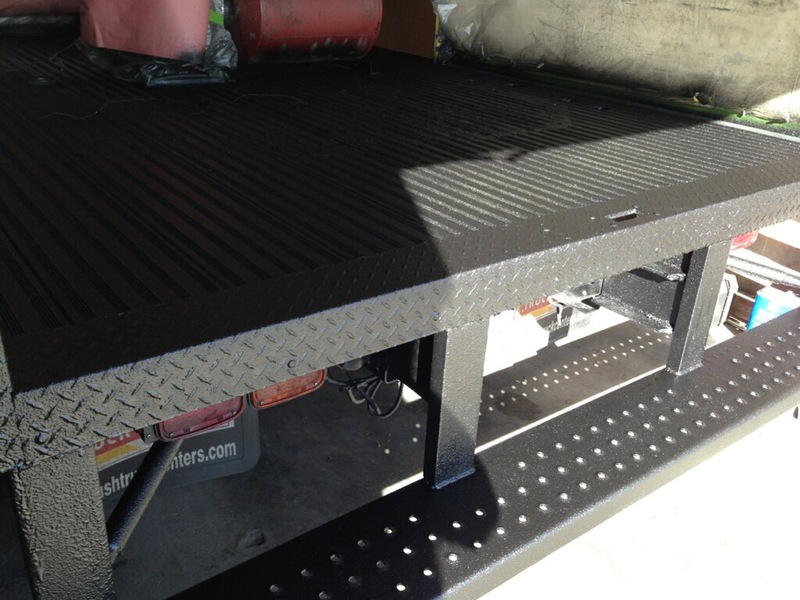

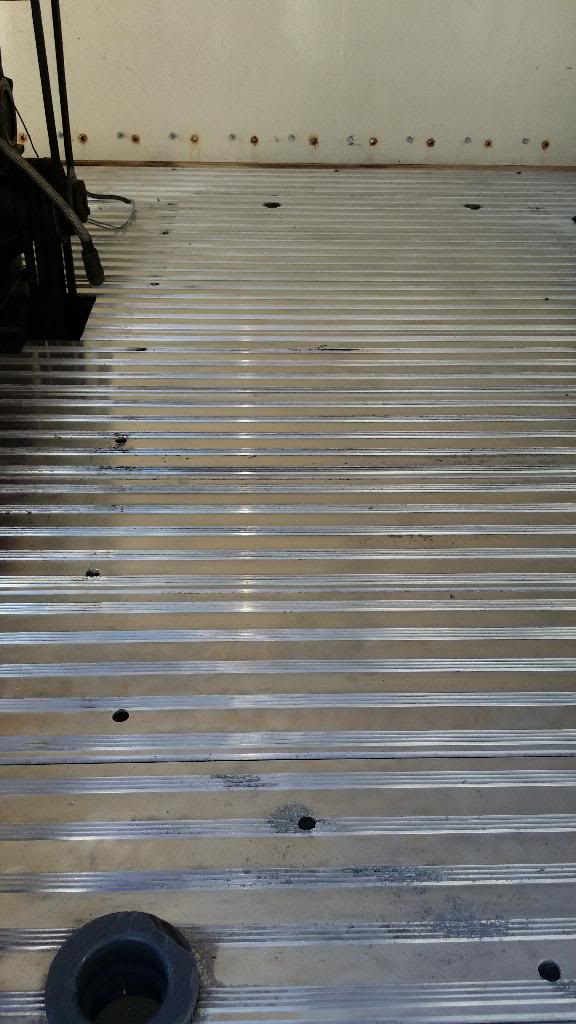

Throwing some bedliner down on a 14 year old aluminum floor.
Fort Worth , Texas
It ran a little here and there but don't really care as it only cost 180 plus 2 hours of labor.

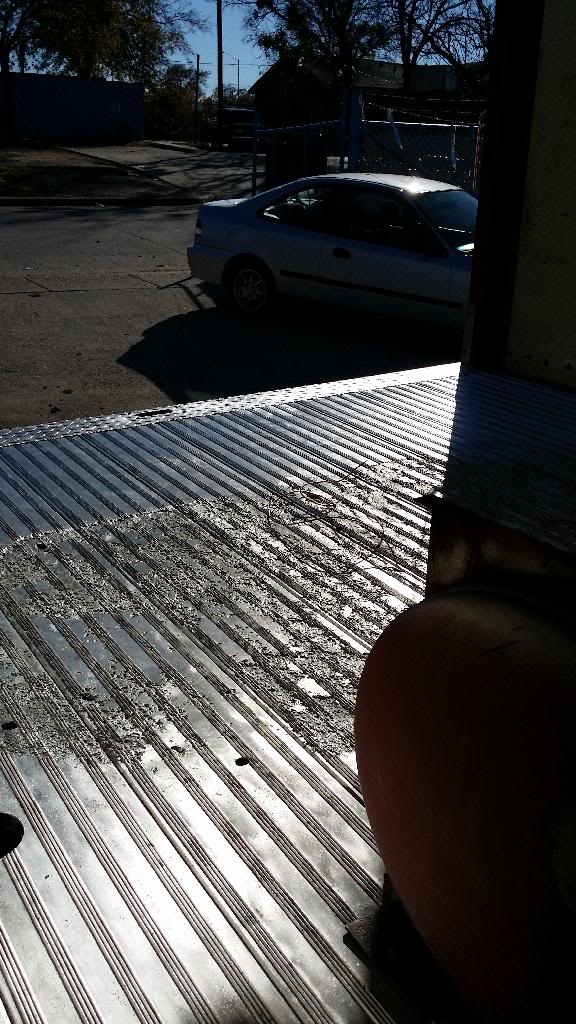

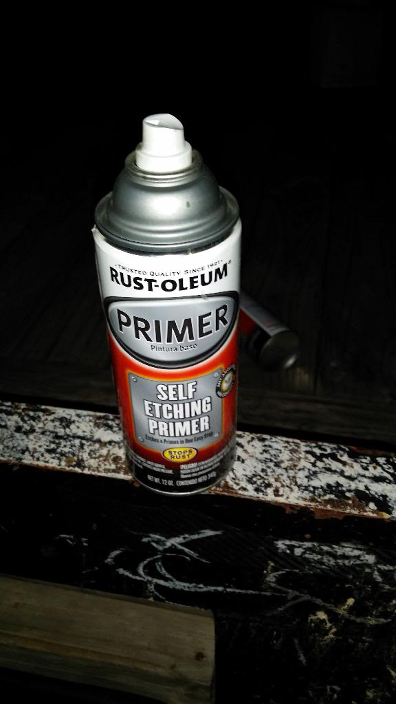

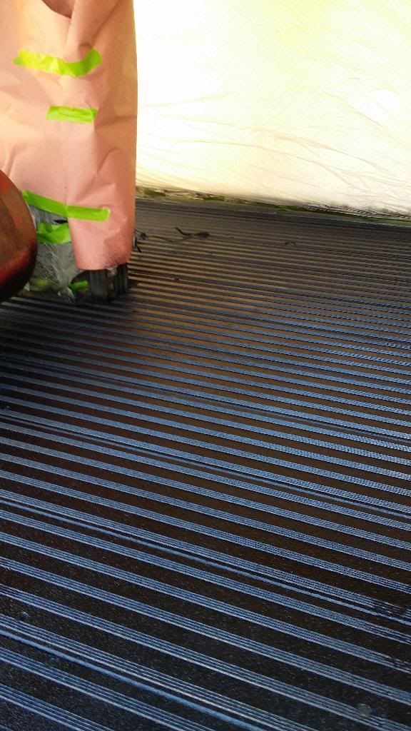

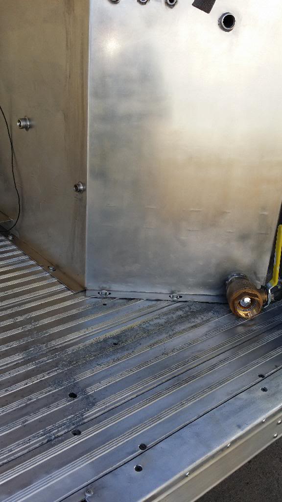

Cleaned it up with wire brushes on grinder, degreaser a couple of times, acid washed it twice, washed again. Then I hand sanded with a couple of blocks of 60 grit blocks. Hit with two coats of self etching primer then shot two coats of bedliner with a undercoating gun from oriellys auto.
We had to use bedliner because the aluminum was getting eaten up pretty bad under the rear tank.

what type of acid? and how strong...
hope you rinsed the hell out of it...
Fort Worth , Texas
Yes rinsed at car wash bay for more than ten minutes each time.
Blown out every time with high volume high air pressure nozzle.
Before application of primer. The whole area was soaked down and wiped up with m.e.k. Solution. Scuffed it once more with 60 grits sanding flexible blocks . Blown outdone more time and hit with m.e.k. Pretty heavily and blown out once more.
Allowed to air dry for a couple of hours and shot the bedliner in about 15 minutes for first application waited an hour. Then applied second coat heavier to all areas and let sit for 2 days for good measure ( it was too cold outside to do anything else).
