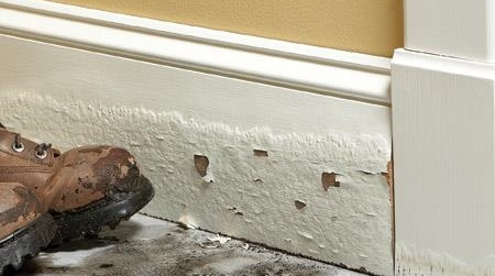

- Learn to identify MDF baseboards. Almost always there will be signs of some swelling from previous moppings or spills
