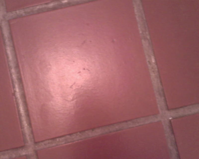

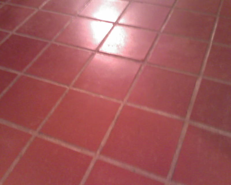

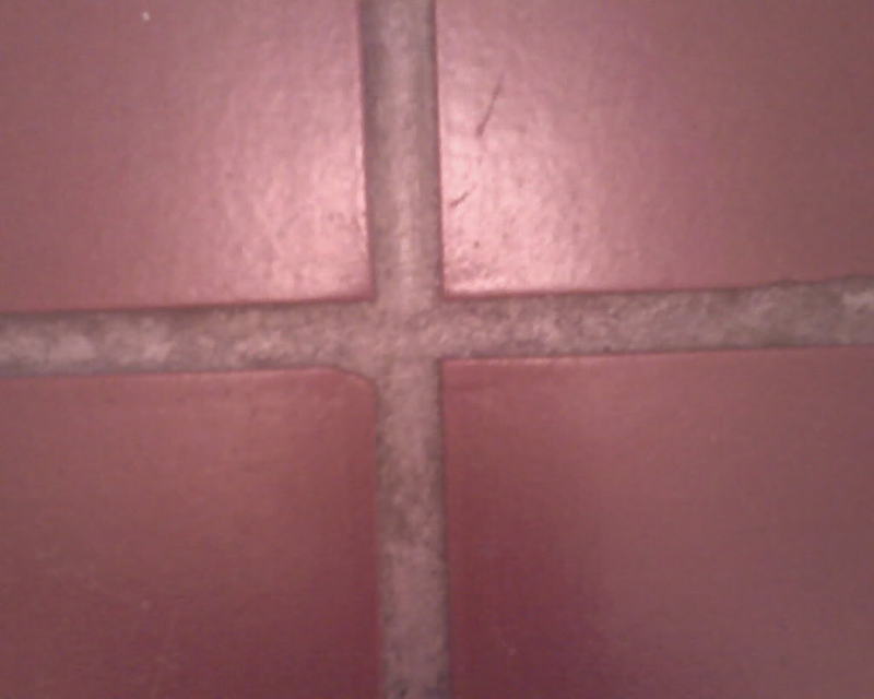

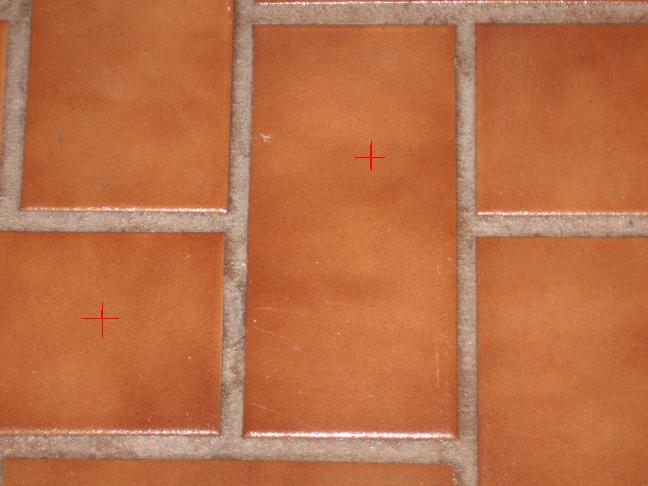

I have some older tile at a customers home. It has a wax build up on the tile of some kind. The grout looks like it needs more than cleaned. What would you do? I'm going to try and get all these pictures in here.

offer a three step process, a color sealing, a regrouting, or suggest they replace it
The three step process: Use a stripper first and heavy. dwell and scrub the bajeezes out of it. Apply an alakline cleaner if needed. And then use an acid cleaner to etch off the top layer of grout if needed.. assess from there or offer the other services.
RickL
Oct 23, 2006
358
I have done several floors exactly like that. Probably VCT wax they put on it to make it look shiney. You are going to have to strip it then turbo then probably do another strip turbo then acid clean. You still will most likely get marginal results.
As far as Color Sealing this goes that is a porus tile and the haze from the color seal can be a
bitch to remove and most likely you'll see it lightly.
For a stripper I'd use Johnson fast strip or barebones and use LOTS OF DEFOAMER cause stripper foams like crazy.

Don't skimp on the scrubbing part. If you can get a 175 with the mutliple lenght bristle tile and grout brush that would be a great asset to you. and make sure to scrub the grout with the grout brush well. You may want to consider using a wet/dry vac after your initial stripping to keep the VCT wax out of your waste tank. The slurry can gum up hoses and your waste tank in a hurry. Then eithers strip again and turbo or look at doing a high alkaline tile/grout cleaner. It will do some stripping and will help go after dirt directly.

What would I do? Run...not walk...run.... If you choose not to run charge 6 bucks a foot. those are clay tiles there will be nothing good that comes out of that job except experience in choosing to run next time.

Or set reasonable expectations by doing a test bed area say a few tile in a back corner or under table and see if homeowner approves. Sometimes they come out good, sometimes not.

No way in hell I'd walk without at least doing a small test.
The test may determine that it's not worth it but you never know. If this is the same tile as what's used in restaurants, it is not too porous and may be fairly easy to strip if the right chemistry is used.

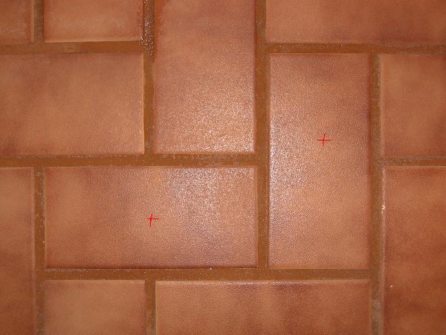

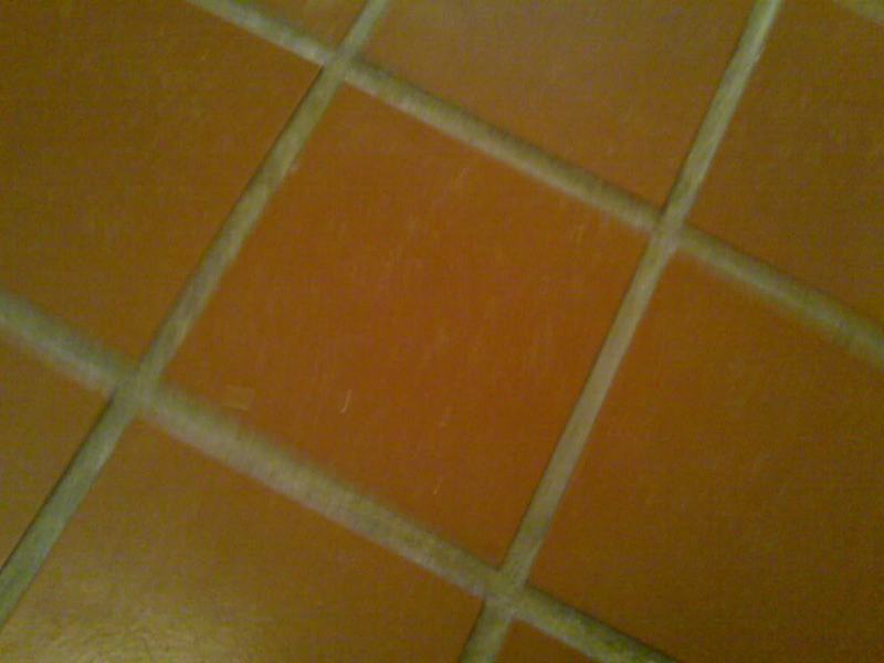

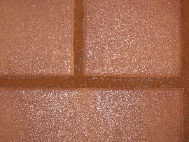

Just like Albert said , never walk with out at least doing a test to determine what it's going to take to get the job done and then if it's going to be worth it.
This is a job I did a year ago, maintenance had been putting down wax for 20 years :shock: I did a test to show them what could be done and what to expect.
Second picture you can clearly see most of the wax is gone but not all.
No matter how long I let the stripper dwell with scrubbing was going to remove the remainder of the wax. Customer loved how it looked , so I set my price based on the test. Was it perfect? no , is it what the customer wanted? yes

Very nice post and pictures Bruce. At this time of year maybe I shouldn't be so quick to tell folks to run away from potential nightmares. During the busy time floors like this are better left alone as the time you'll spend for what you'll make just isn't worth it. To many other jobs can be done that will be easier and more profitable. Then again you never know the customer just might pay to fix it.

Those pictures look great! And I like the new color your changed the grout to. Oh well, sometimes I win some and sometimes i dont. Plus I'm not real good with tile yet... Except vct. I need some training

Not sure why people are so afraid of these jobs. Your worst part is getting the wax out of the grout. I do these things all the time. Yes the first couple sucked. Just have to do the testing. Fastrip mixed room temp, 20 min dwell, agitate, vac, turbo, do it again to get the rest of the crap out of the grout. Acid wash if needed. Color seal, no problem.
