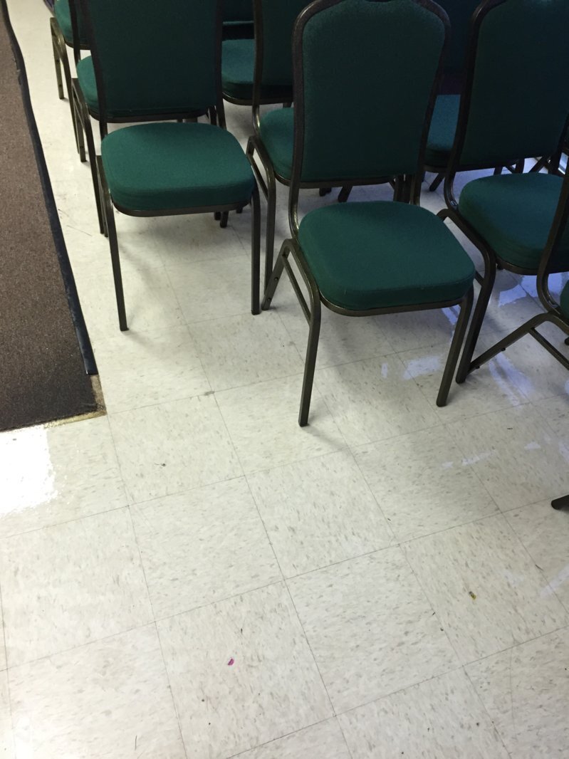

I was cleaning some chairs and carpet at this place tonight. As I was looking around I noticed their (tile)? was disgusting.
How hard is it to clean something like this?
Could you do it with a 175 and some stripper or is it much more complicated than that?

You could but it wont be easy.
That is VCT ( vinyl composition tile) and its care is an art form.
You do not want to use your truckmount or portable to clean up the slurry for one thing.
Do a search for "vct" here and you should get the gist..

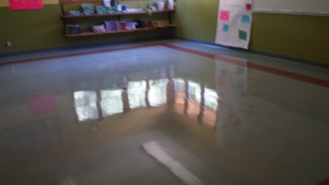

Unlike the above posts,I say it ain't rocket science but it might be a good idea to learn doing a ride along with someone that does it on a regular basis. Here's a boo at one of mine.
This is a stripped floor:
This is the same floor stripped and finish applied
Any questions?

Looks amazing. Great job.
What equipment did you use for this one?
Black stripping pads (3m), 175 rotary, big ass shop vac, mops and pails, doodle bug and putty knives for edges,after a neutralize and rinse, a red pad with the 175 again. After a spell to cure, an 1600 rpm burnisher with a white polishing pad. $1 a foot, but they get what's paid for, not a hack slop and wax.
