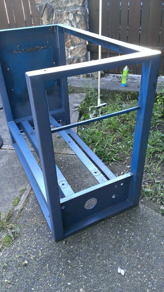

I'm Rick James
I am doing a rebuild right now, I just got the frame powder coated a week or so ago.
