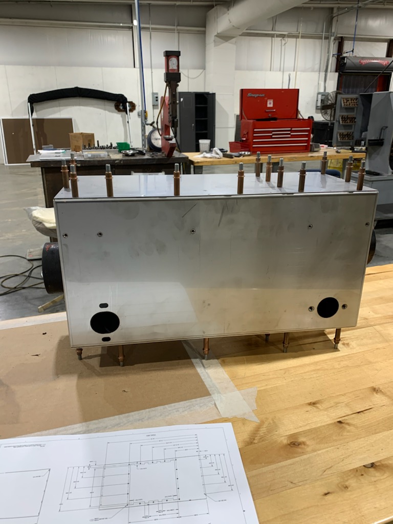

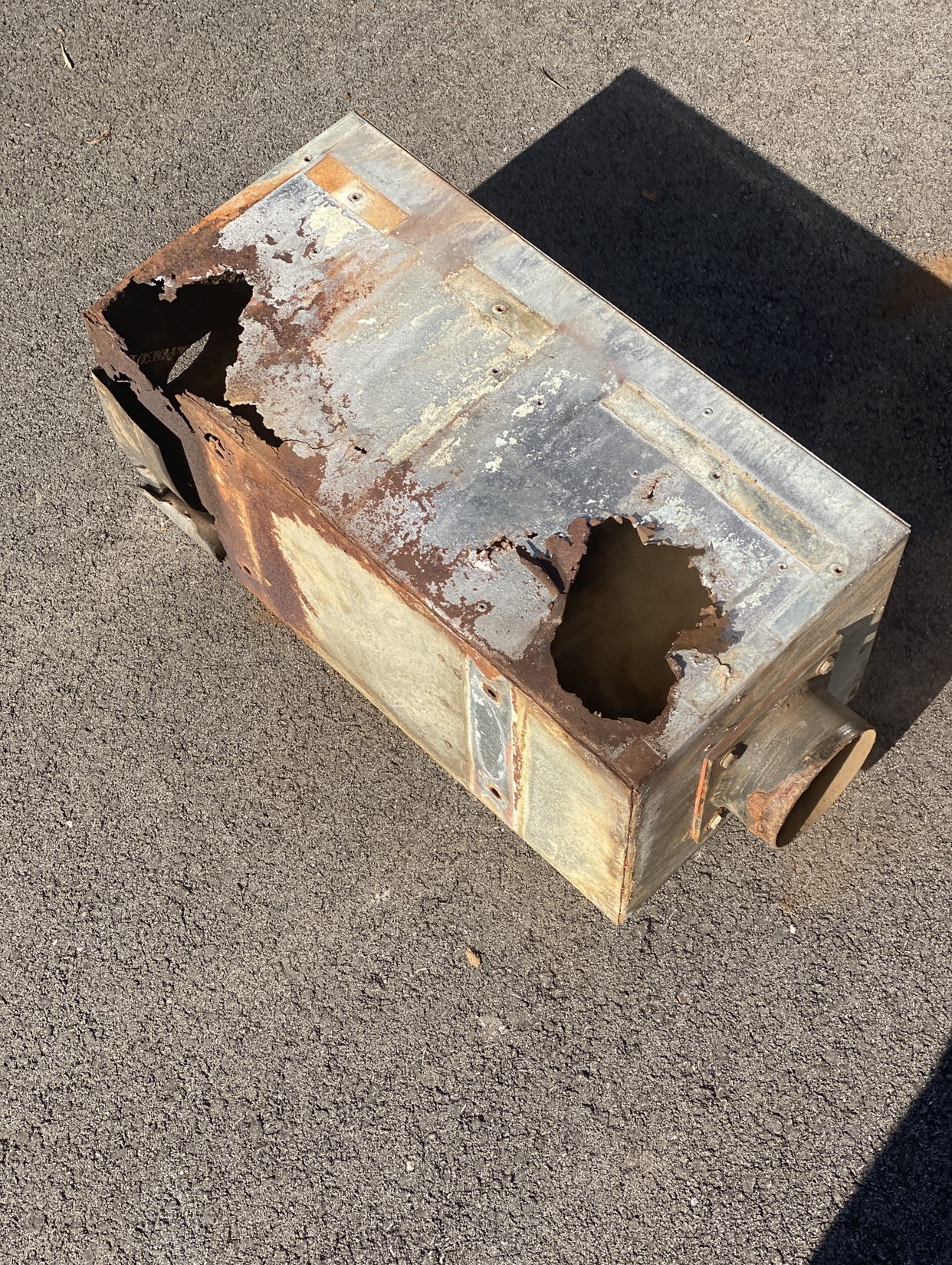

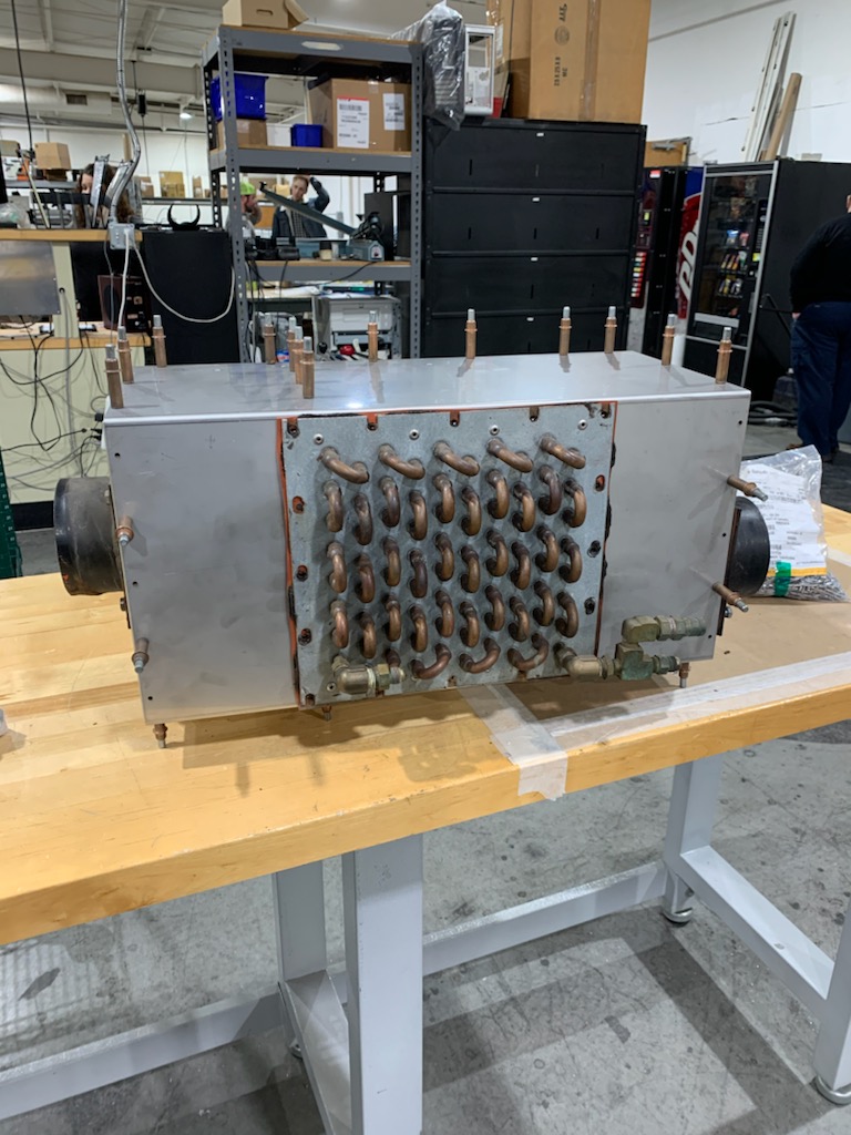

A big thanks to Maxfab in Madison Alabama for saving the day with this custom heater exchanger replacement box for my hydramaster Titan 875. These guys took the hydramaster drawings and made one in a few days. Stainless should outlast the old galvanized one

That’s what they told me too. Maybe these guys at Maxfab can make some of these and other that are out of production for them .

If you don't mind me asking I'm curious what something like that would cost to have fabricated?
The guys words were “ first one a bit more expensive since has to be out in the cad software “ 1st one was $600. I imagine any of the Titan 875 ones would cost less than that since mine was 1st.
