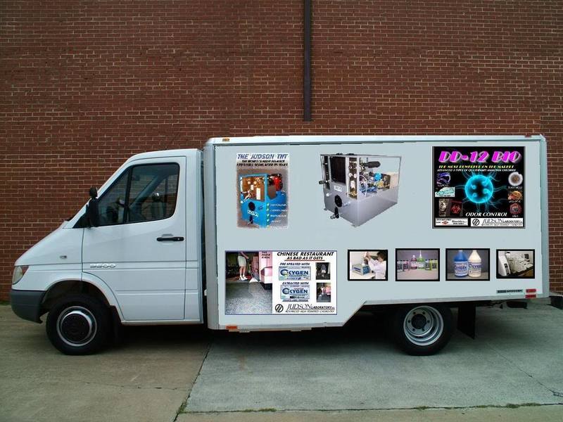

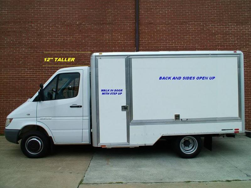

The reason I'm looking for a new ride is, for one a newer truck even though ours is in excellent condition and fuel(mpg). I average 6/7 mpg with machine running on same tank. 24-26 gallons for 170/190 miles. I might sell our truck complete with machine. Just running some numbers as this time.
I just got off the phone with Freightliner and they have a 12 ft box Sprinter that gets 16/18 mpg. Price is fair @ $24k. Then another 1300 for the side door. Decisions decisions.

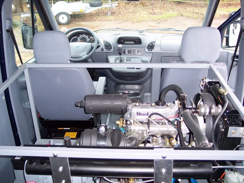

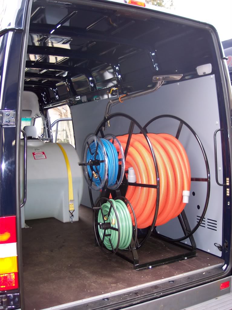

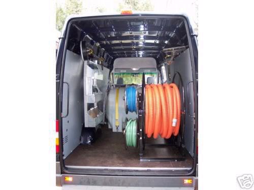

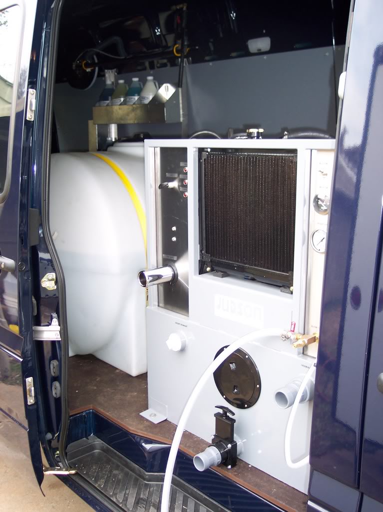

this is some photos of a sprinter we did to give you some ideas on lay out.
475
Leslie,
Looks good but small. What engine and HP is that on the machine? What blower?
I think we're leaning towards the 12 ft box Sprinter. They are telling me 16/18 mpg.

What ever you do, a solid heat and vapour proof cargo barrier is a MUST.
We also got the floor fibreglassed for water proofing and then I carpeted it (well most of it, like all things, it was rushed into service and 2.5 years later it still doesn't have the carpet down on the back floor :oops: )
I have Genesis 59 in there coming out the side door. I have the machine set back the width of the hose reel from the cargo barrier. This gives very ready access to the hose reel and the front of the machine. That leaves the whole of the back free for chem shelves and such like.... not that there's ever any space available!!!!!
