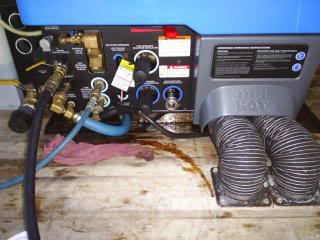

What type of grease should i be using with the grease gun?
Ron, it does have a drain hose to make draining the oil easier, I did have to drain a little oil the last time because the dealer had way overfilled it...that's another reason I'm going to start doing it myself.
Regarding the belt tension, how tight should they be?
CleanEvolve said:
Thanks guys,
I've always used hi-temp wheel bearing grease
pump it in til it squishes out the vent hole on the bottom of blower bearing housing .
don't freak when the first time you run the unit you see a pile of grease under the blower.
It's normal
when changing fluids, engine oil, blower oil, etc, change fluids on a warmed up unit, they flow better, faster and more complete .
about 1/2" to 1" flex when you push down "somewhat" hard on it
too tight and you can cook bearings
not tight enough and it'll slip and glaze belts under load.
