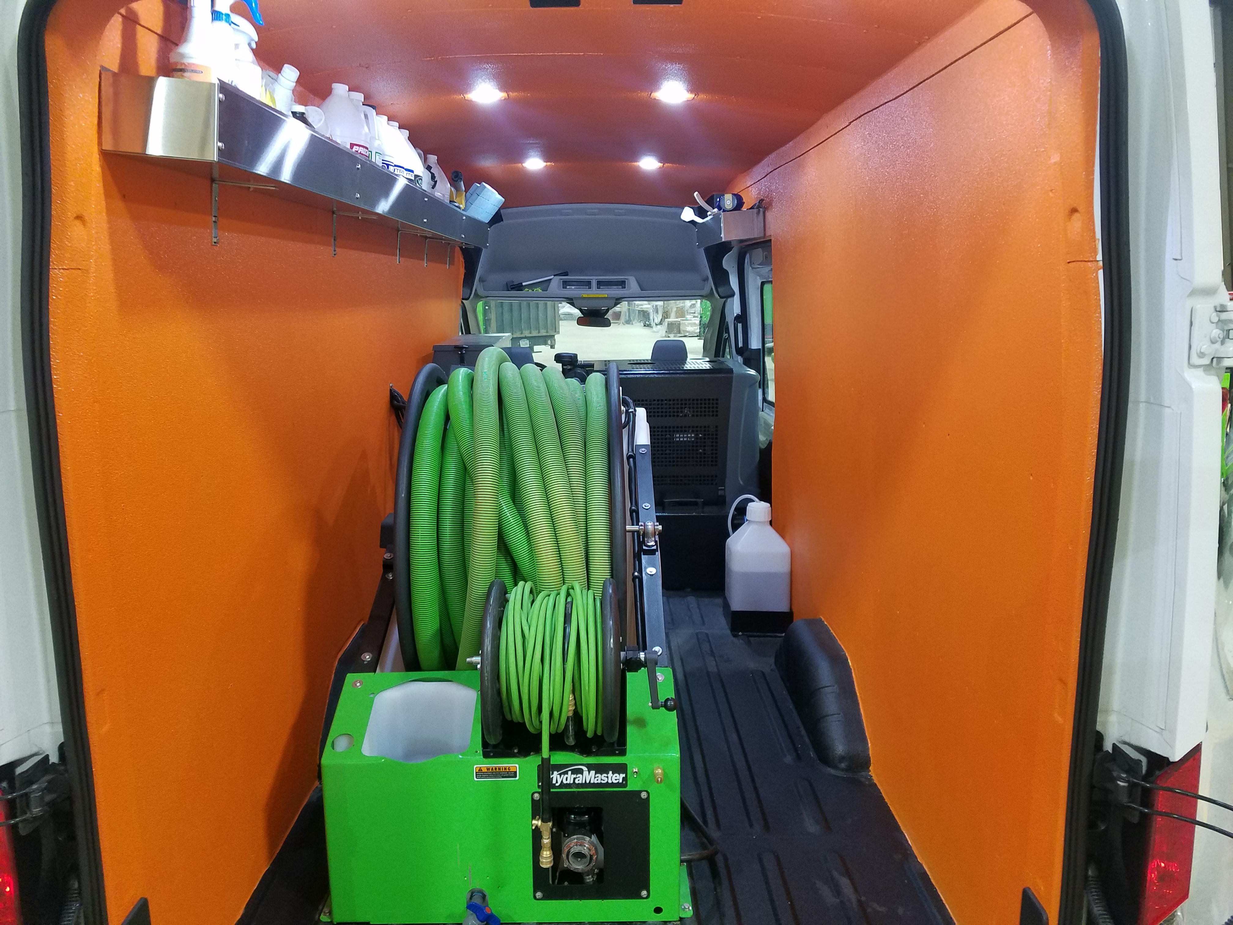

We did insulate and put 3/4 plywood on the walls and 1/2 inch on the ceiling. Also installed some shelves today.
Some weight there but I figured this 350 would handle it.
If I remember I will take a few pics tomorrow and show you this turd.

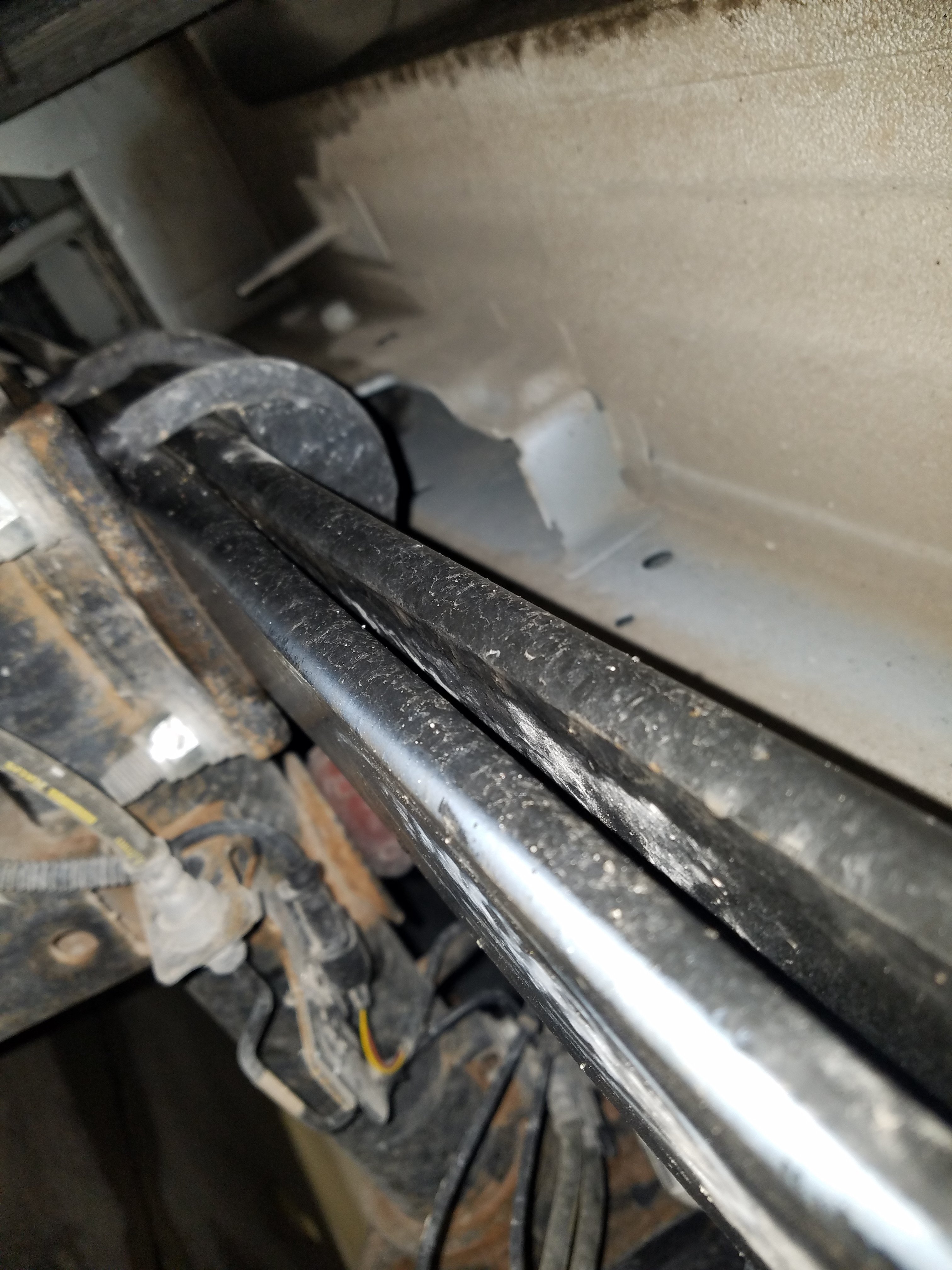

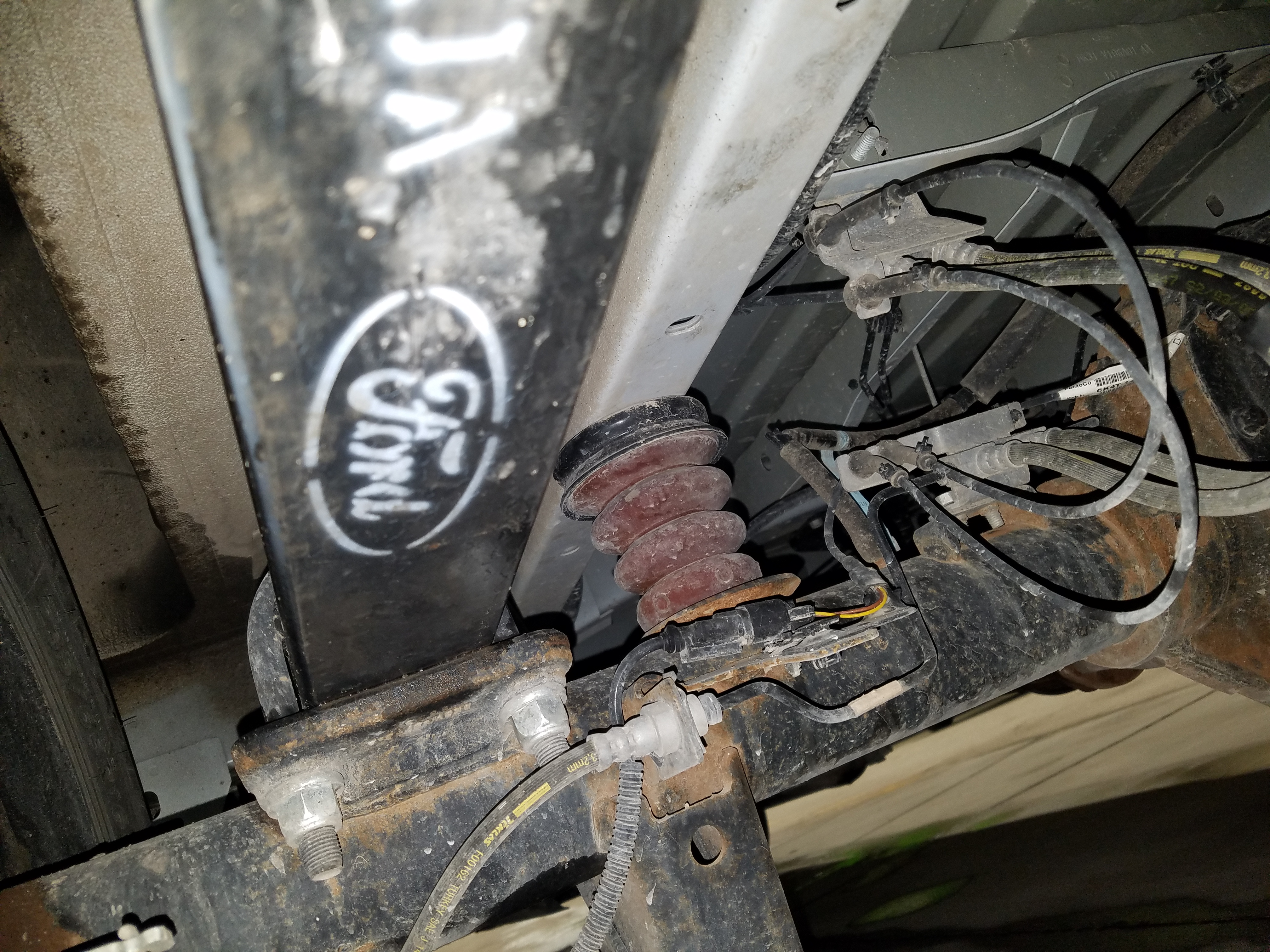

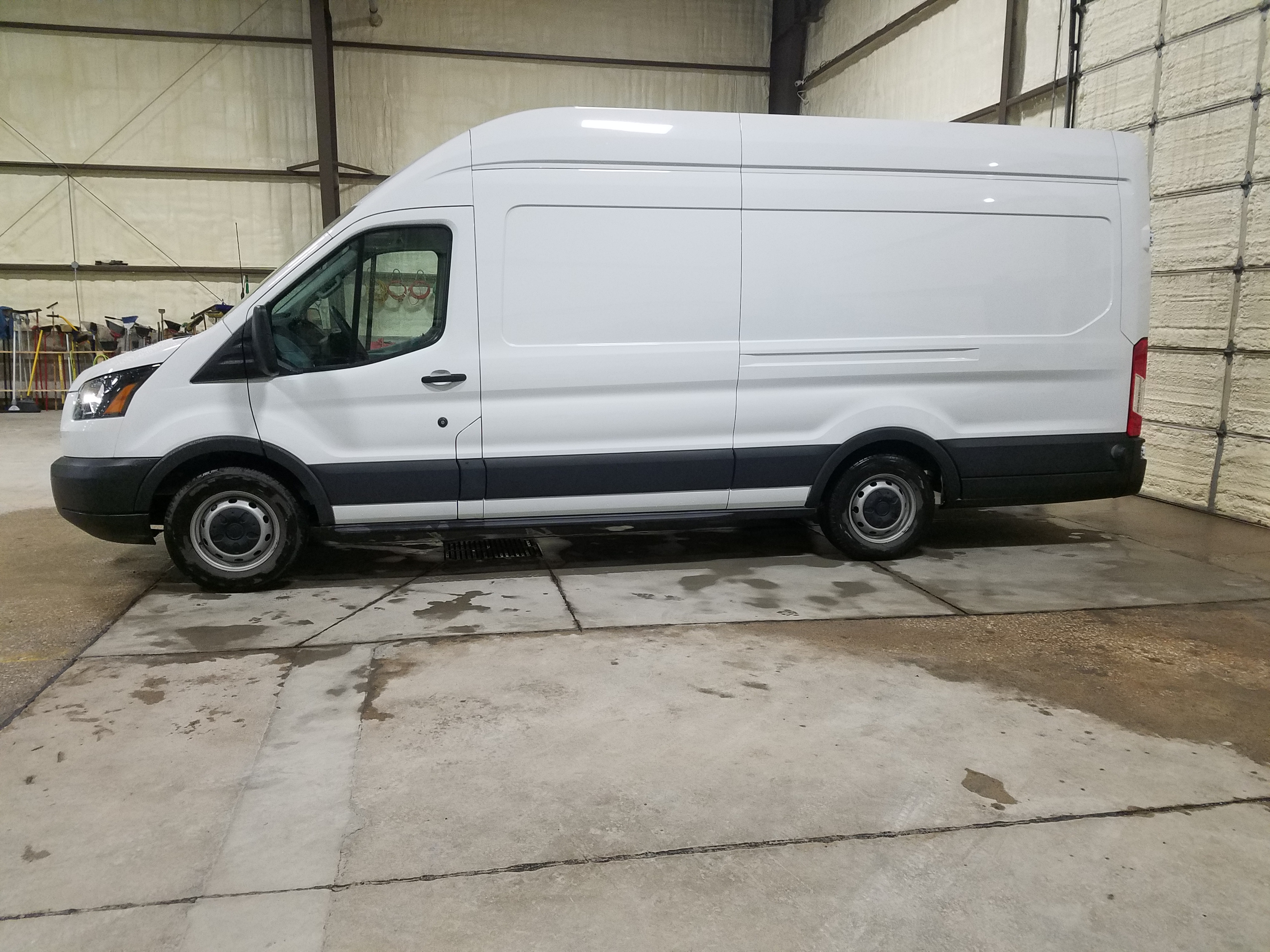

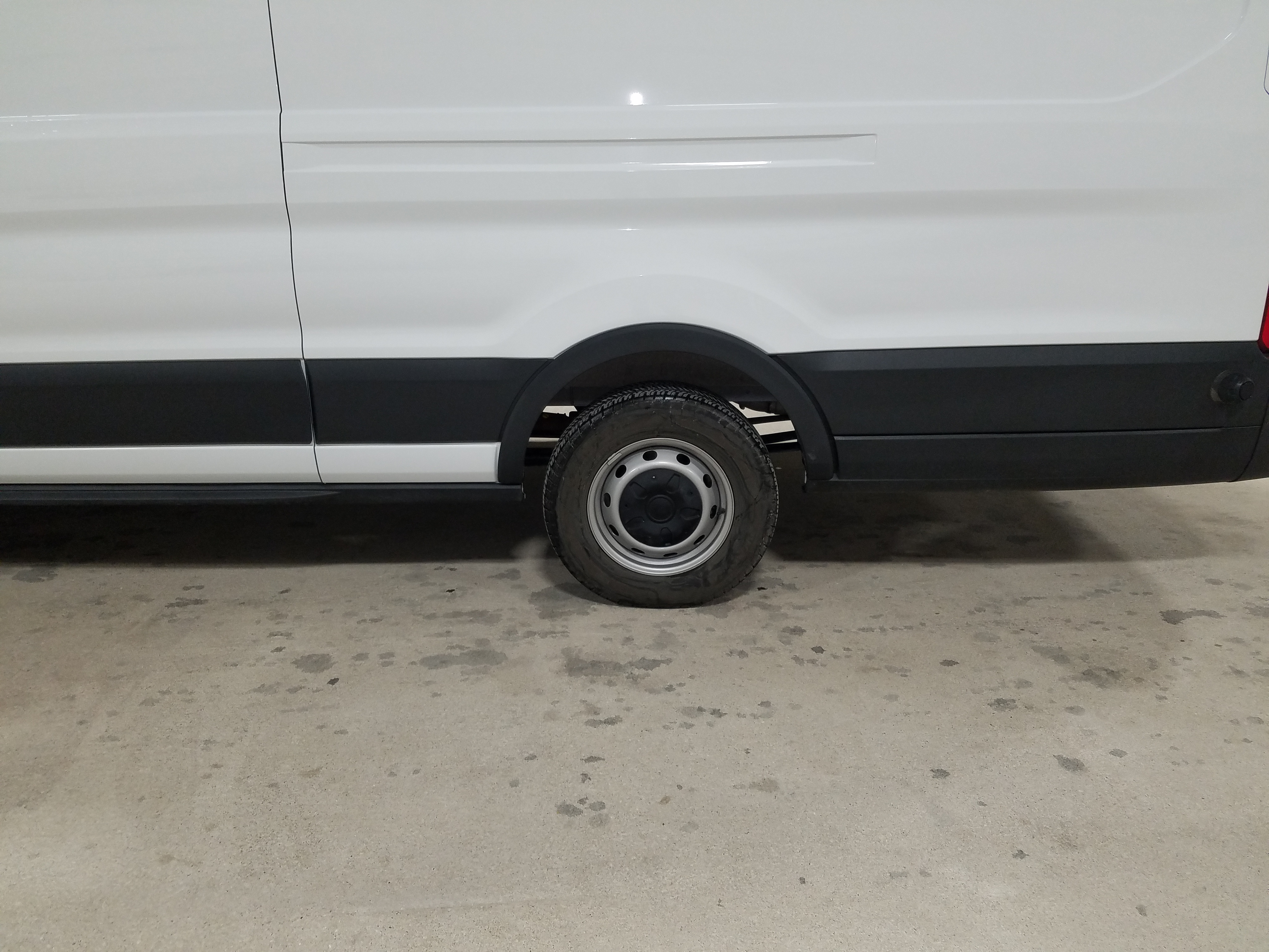

That heavy plywood seems like overkill but shouldn't be a problem weight wise. Perhaps you have broken a spring leaf? Is it an even sag or more on one side?
Chains
Apr 11, 2016
27
USA
Jerry McMahon
It's even sag.
20190412_200645.jpg 20190412_201540.jpg 20190412_203251.jpg 20190412_203336.jpg

Too late now, but it appears all the water weight is resting on the rear axle
Side mount probably would have eliminated the sag

Can you move the water tank back to sit right over the axle or move it to go out the side door? With just your tank and hoses you have half of your payload sitting behind the rear axle. If you ever get the van swerving the back end will come around on you and flip it. That is why they outlawed schools from using the Ford extended vans to carry students.
Reactions: Lee Stockwell

The water tank will come back a foot or so. We have plans to move it and look at some suspension options but I'm thinking were gonna have to move it into a box truck.
I'm sure we can get the van to stop squatting but the safety issue will not get resolved.

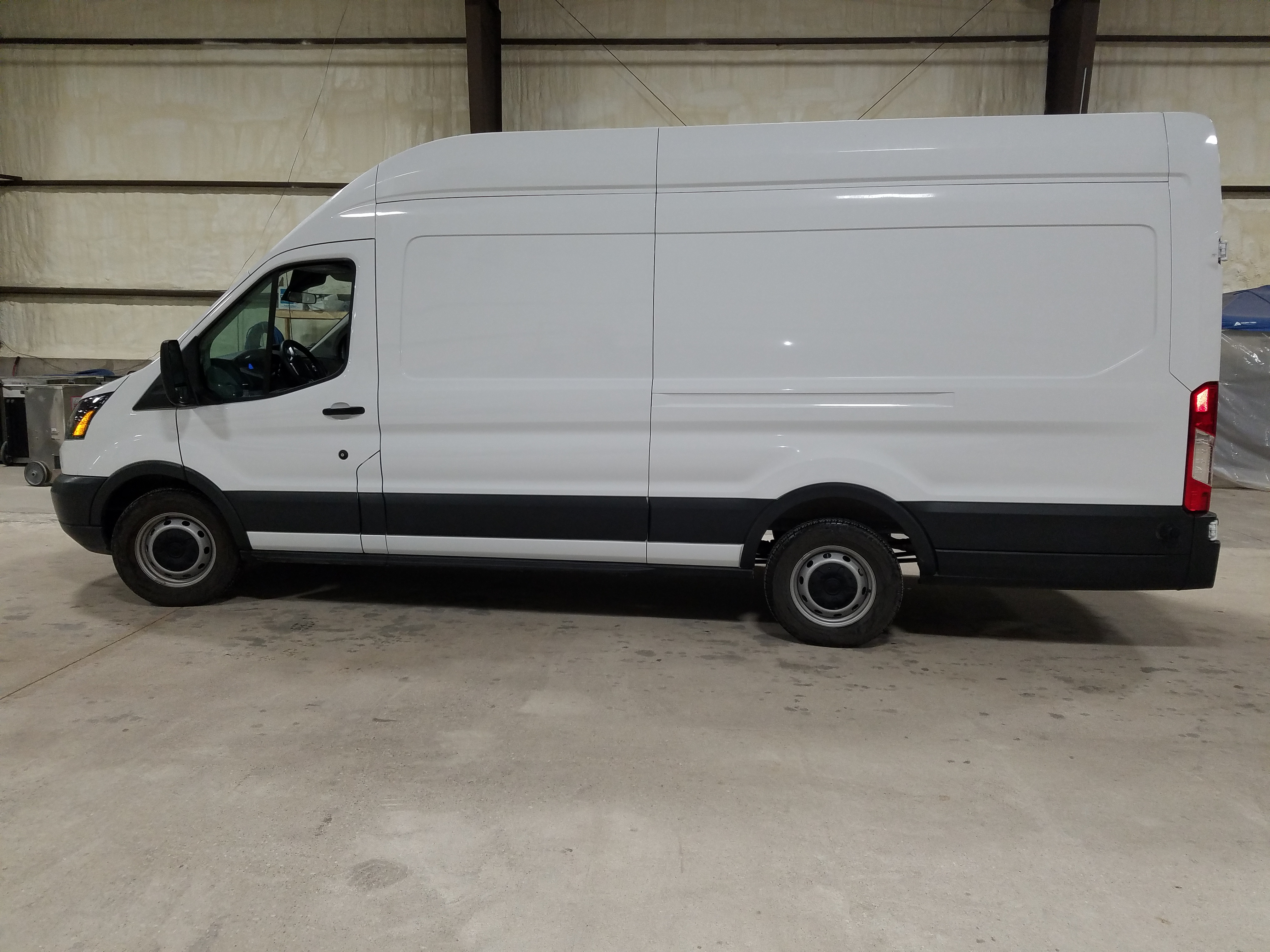

Ended up putting bigger springs in. Much better, I think it's sitting about where it was stock and this pic is with 120 gallons in there.
Still gonna remove the Hydra Cradle. Taking up way to much space, I can't get all my stuff in there.
