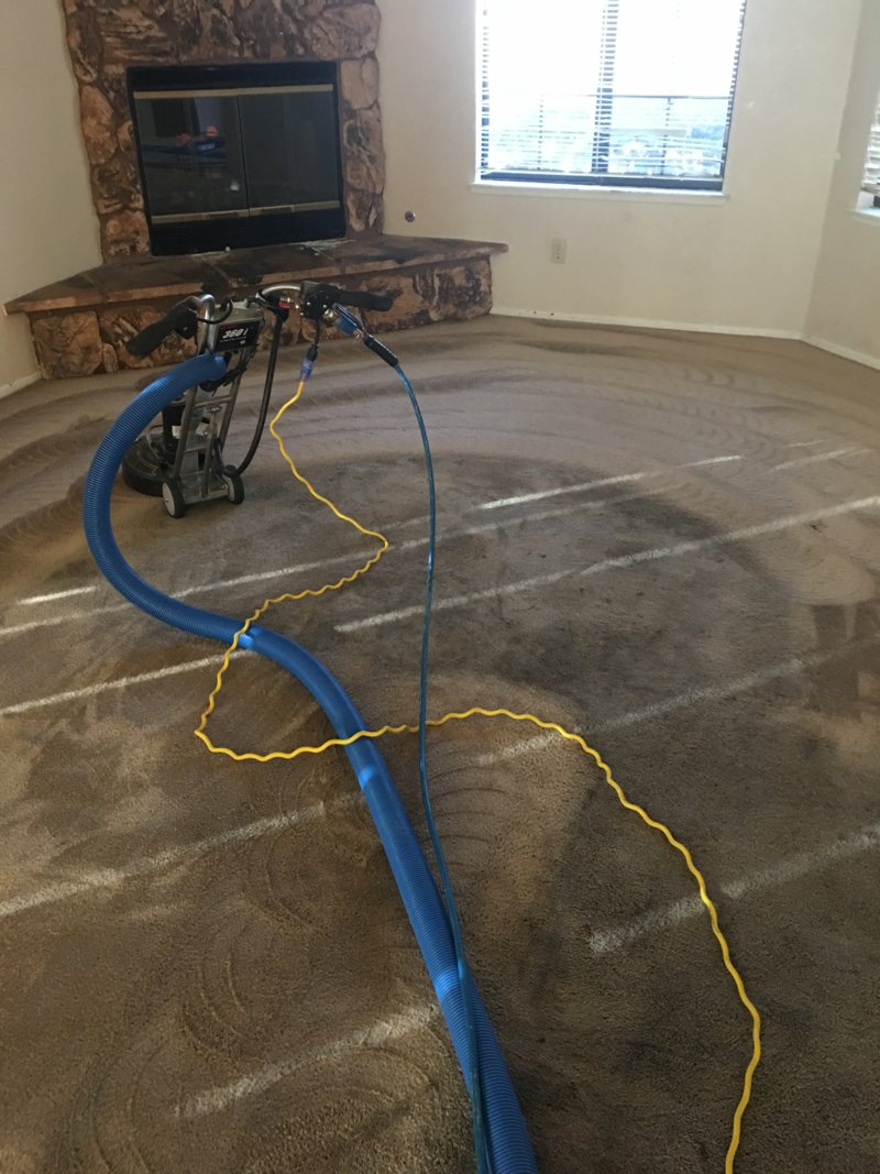

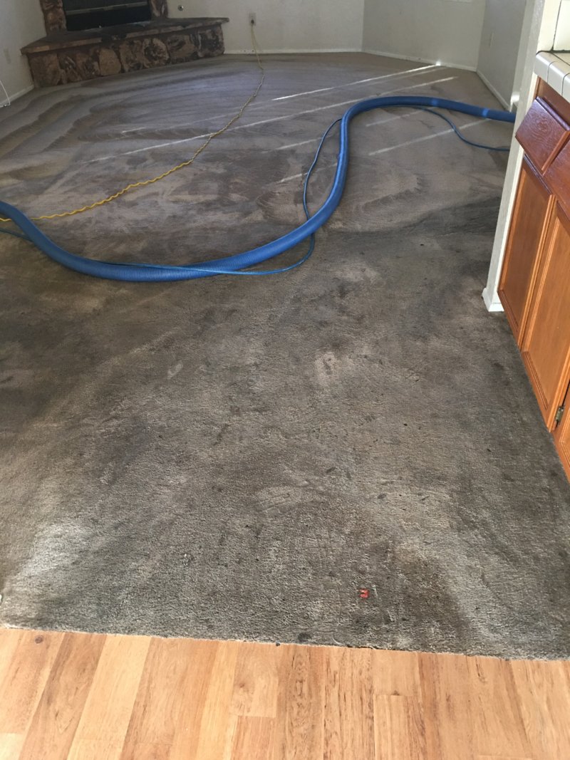

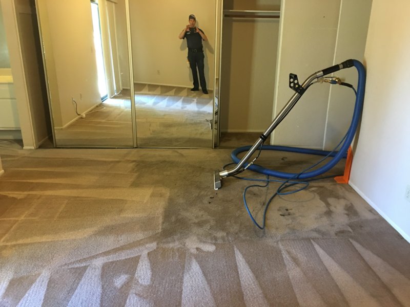

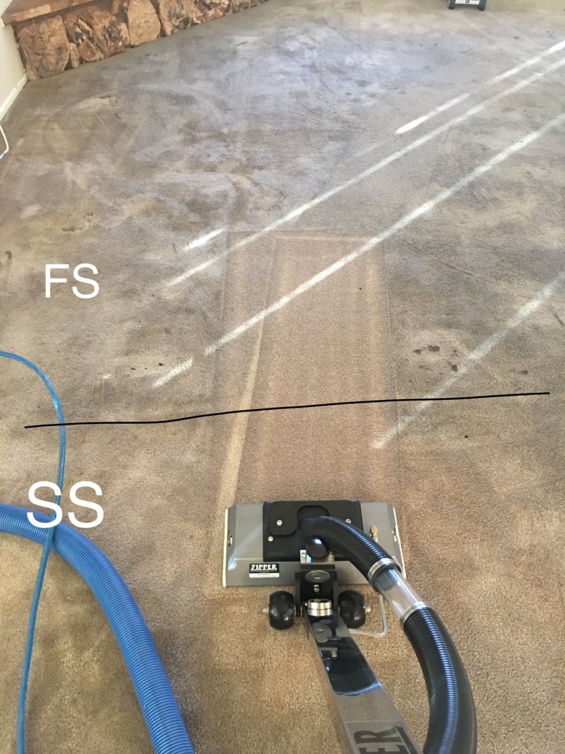

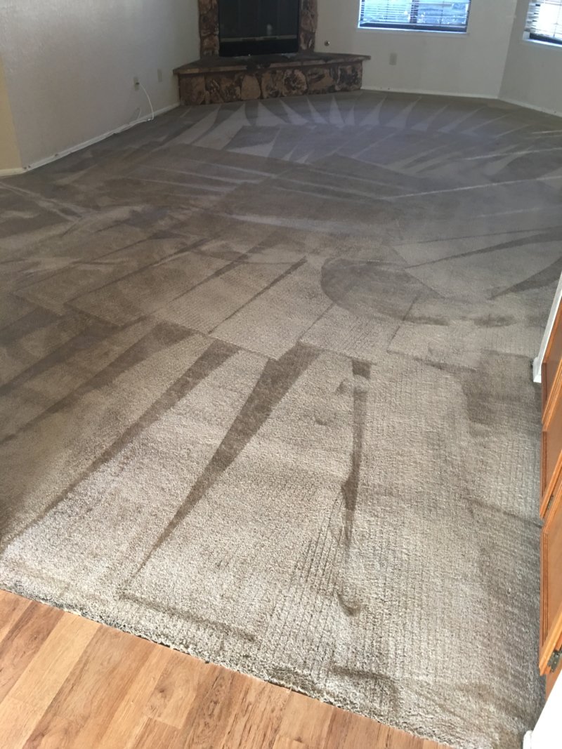

I would say they both performed great, the zipper pulled out soil and grung the devastator wand with CRB did amazing in the back rooms.
The RVBH helped on the last room didn't CRB great room. The Brush head pulls the spots you have usually retreat with a wand and kick.
I would say if I were to pull out a 15 inch CRB the zipper would be awesome.
I find the Devastator easier to use in residential. It did a great job.
Both the zipper and devastator are great.
11,504

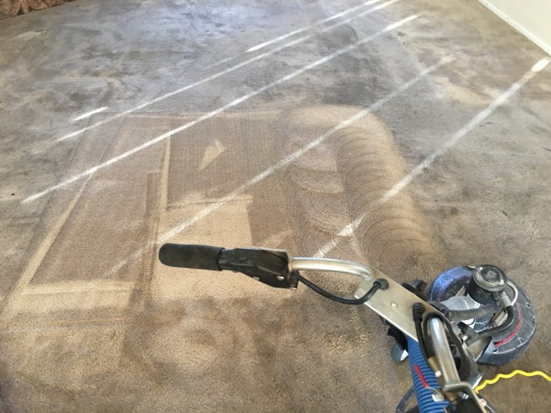

Rotovac BH most aggressive I should've turned psi down from using the zipper and devastator wands.
It lift jet streaks, the zipper left faint jet streaks nothing like the Rotovac and there's was no jet steaks from the devastator wand.
That's said the really trashed room needed the RE, hell it all did, but my CRB and wand did awesome.
It's hard to explain you use a wand then try something new and it's crazy how it's just seams to clean faster and better. The Devastator wand.
