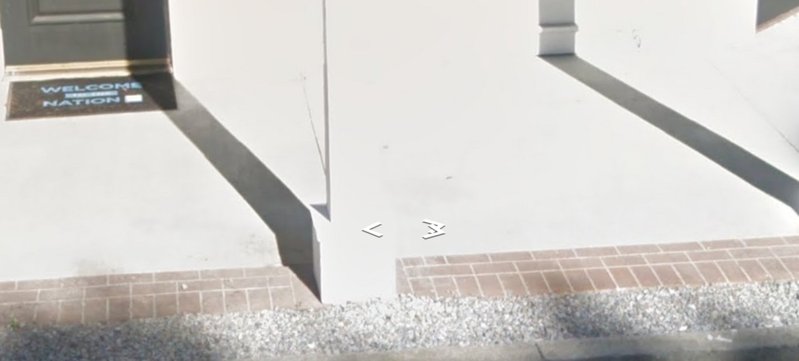

and this is what I was talking about ....the cutting brick/tile patterns into in place concrete...... "brick"/tile border on these two buildings done by me with lm scofield faded teracotta and 30% solid sealer........cut with a 3/8 tuck point wheel on an angle grinder using 4" flat bar as a straight edge/guide

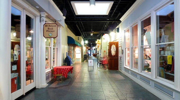

also did an overlay with crazy semco colors in the Plums ice cream shop upstairs

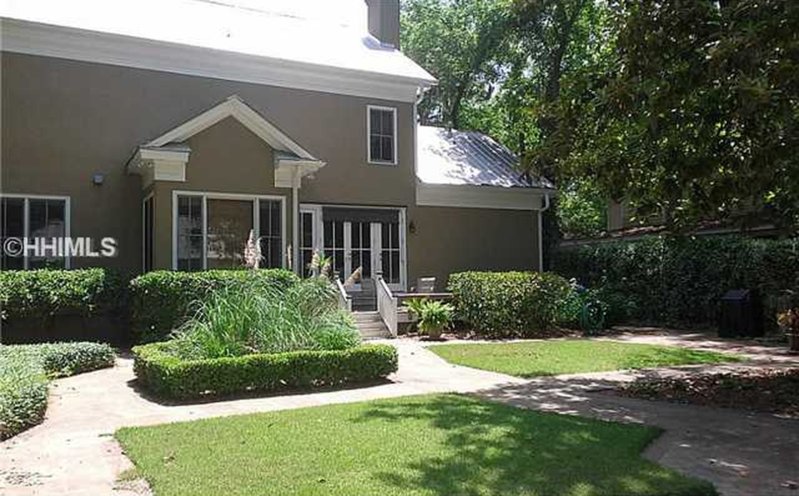

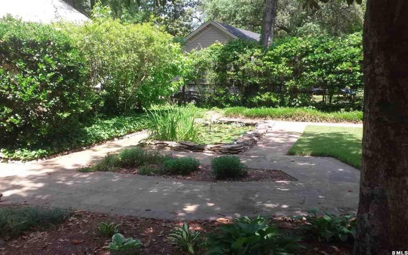

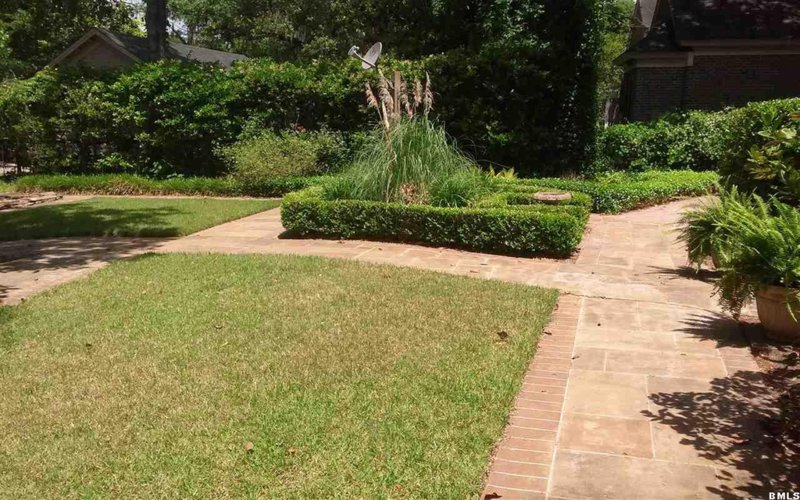

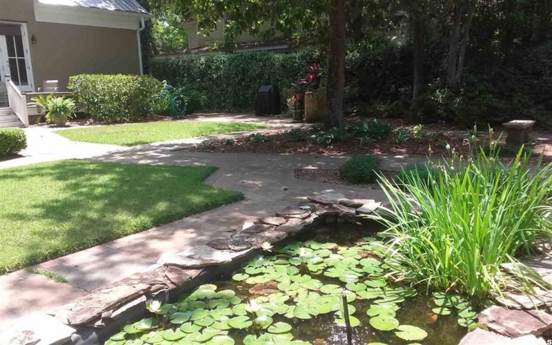

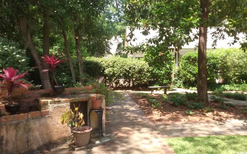

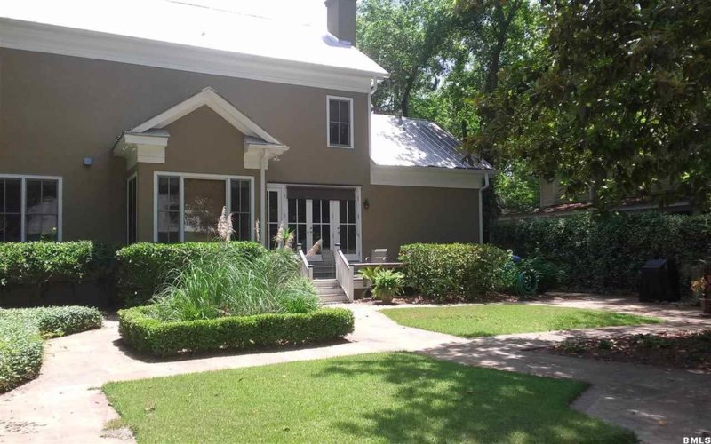

and Simon the owner of company backyard...all concrete ...acid stained....engraved...............the first concrete I ever poured/finished.................he had never done it either so he bought me a book at the home depot on how to pour concrete a week before the truck arrived :eekk:

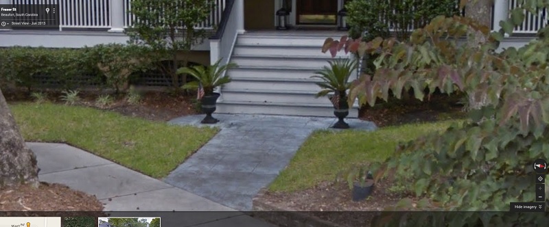

the front sidewalk was overlayed/stamped/stained (not acid)
http://www.zillow.com/homes/for_sal...3,-80.641042,32.434116,-80.644303_rect/18_zm/

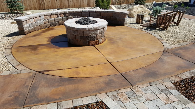

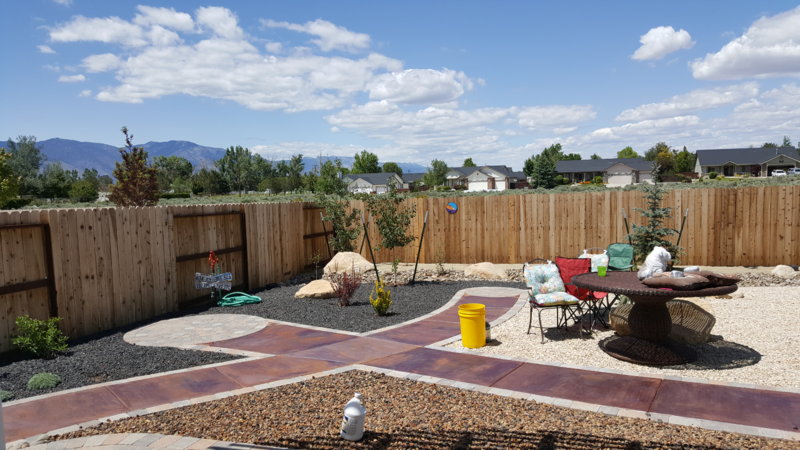

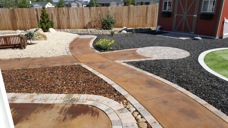

to match my personal taste i'd consider adding a tint coat since the surface isn't going to react any more
or a tinted sealer (maybe even clear) if they have something that will survive the freeze/thaw you were describing
contact kemico/lm scofield and see what the suggest...
but it looks ok ...its growing on me :D
