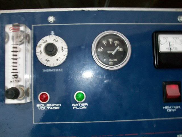

Was curious how our 2nd Butler was doing on heat in cold temps of -11 below.
We had a 30 minute drive to first job and took picture after prespraying 3 rooms, and just started first few strokes when decided to check. Was hitting 240 on the guage and by the end of the job hat pegged the guage over 240.
We were using a 6 jet Prochem Titanium with .02 jets. 50 feet of 2.5 inch hose and 50 feet of 2 inch.
Was quite pleased with the results.
Will try to shoot video someday to show as well. I know we would get more heat with lower flow, but don't think it would have the same punch at the wand.

i was wonderen if a butler would maintain the temp on a high flow wand?
i have my answer
Here is what it looks like when it really gets working...
And yes that panel around the switches needs a good cleaning.
Hard to keep things really clean working in this environment. :(
