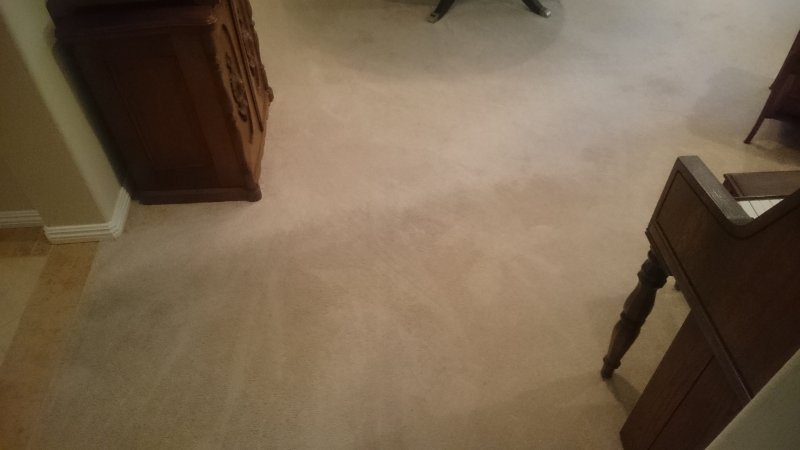

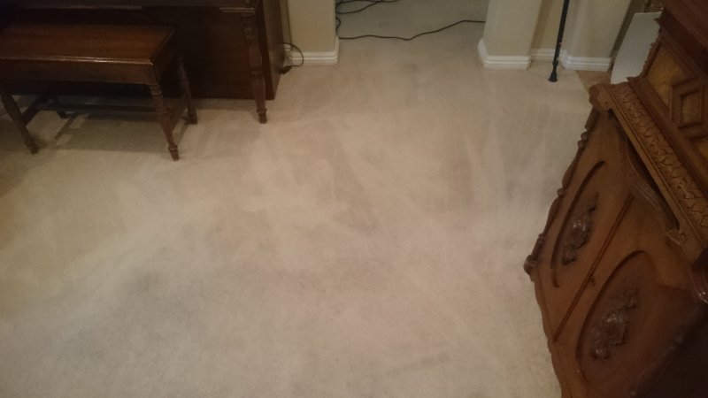

Customer is absolutely livid with their two and a half year old carpet (seems to be poly crap) showing incredible amount of pooling/pile reversal all over the house and wants their community management to have them replace the crap with this Stainmaster Trusoft carpet.
Here is an example of how the carpet looks after vacuuming :
That's the same area from two different angles. And there are worse areas in the house.

I know Mikey.. I've seen plenty of expensive thick dense pile nylon pooling all over..

BTW we have cleaned this place now 3 times in less then 3 years.
We have used a vacuum cleaner every time.
We have pretreated with Powermax one time and prescrubbed with Orbot and rinsed with 14" Greenhorn supplied by a pretty hot El Diablo.
We have Pretreated with Flex powder another time and prescrubbed with RV 360XL pad driver beige Agiclean pad and rinsed with RV 360XL again with a hot El Diablo. After the rotary extraction I went over it with the Greenhorn just dry stroking it. Followed by grooming with a brush and quite a bit of the pile reversal is still visible after all the agitation etc....so no wonder they're not real happy.
It usually goes back to the complete pooling/crushing look in a matter of a few weeks after each cleaning. So I know there is really nothing we can do about it.
