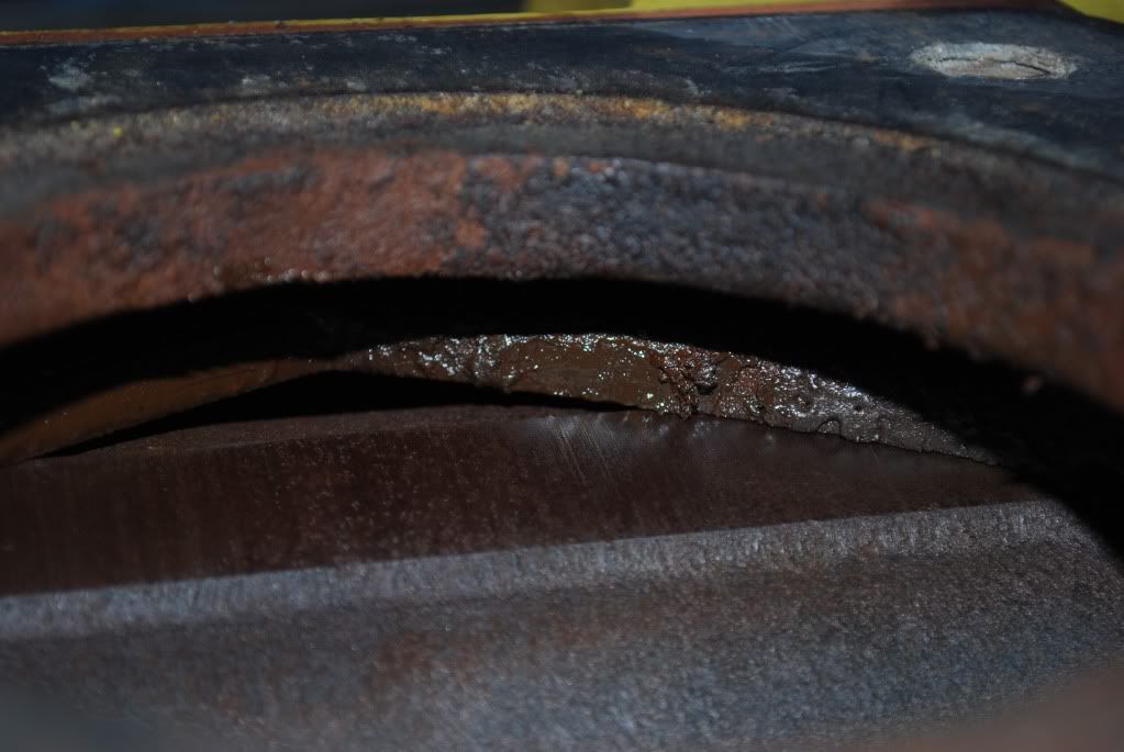

If you own a Tuthill TI 850, pull the four bolts out of the collar and check for a leaking oil seal. They have had several revisions, I hope they got it right this time.

Daniel, I corrected the angle of the blower on both of my trucks. Tuthill's Manual states that the blower MUST sit level.
