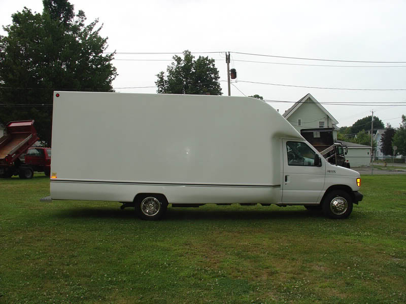

Here's Mine - I love it and when the time comes, I will replace it with another.

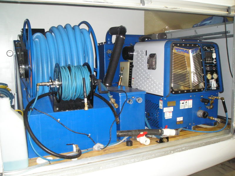

After TM install...

If I am not mistaken Unicell bodies are chop gun glass molded bodies that have not core that you can drill into and mount stuff from unless you add glass backer boards to them. An FRP body has at least some core but also has to have some backer through bolted to them. A aluminum body has some framework that can be insulated and the extrusions can be used to bold backing boards and interior liners to them. The Unicell bodies have the advantage of being light which in the these times of high fuel costs is an advantage. The steamline shape of these box vans make all the difference. I would make sure that what ever van one choose today that it has at least a nose cone on it. Having a lower skirt helps with the aerodynamics too.
