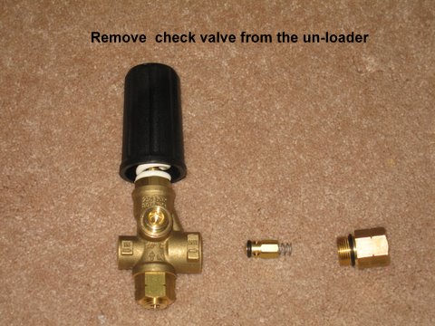

Jim Martin
Arizona
Jim Martin
did you remove the check valve...???
