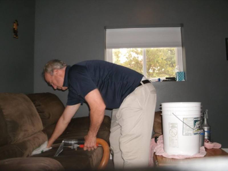

I bought mine from the Pemberton's after seeing Jim use one in his class at Mikeyfest in Nashville. I like how he sprayed his precondition on it and spread it with the mitt. He also used it when shampooing, along with using a sea sponge.

Some of the guys also use the makita 9227c w/ rick's fiber plus and tuways (and the green striped ones), as a prescrubber on low speed which does a great job as well.

I like this mitt a lot. I go through one every year or two (they're very durable). You can make a foam in a bucket and wring it almost dry and spread the foam, or really spread on the preconditioner.
