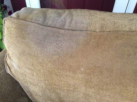

TIP #1. . Never use spotters and cleaners that contain optical brighteners when spotting "off white" fabrics made of mostly natural fibers. These products may "over-whiten" the area that you treat, leaving a bleached out appearance.
TIP #2. Apply distilled water to the entire cushion face, or section of the body of the furniture that needs to be treated before using water based spotters. Distilled water will often remove water stains by itself, but in this case it should be used to prevent water stains from forming during the drying process.
TIP #3. Avoid, or use with EXTREME caution, highly alkaline or strongly acid spotters, as either may cause color damage.
High pH Alkaline Spotters May Cause Color Damage!-
TIP #4. Never flood upholstery with excessive amounts of dry solvent spotters. These products may deteriorate fabric backings.
TIP #5. If you are making a "spotting only" service call, be aware that some textures and finishes will be changed no matter how carefully that you work, and will contrast negatively with the untreated areas. It's a better practice to clean the entire piece, and charge accordingly, than to just take out a spot
